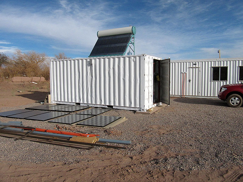

Because of the recent topic by tecman and another recent thread, I thought I would show my solar system. Well my system as it existed in 2010. I am currently building a frame for some new panels and my batteries have changed.
When I moved to Chile, it was made clear to me that I would not be able to get a connection the town power. When I was here in 2009 (the experience that made me decide to move here) I was made very aware that the town power was of very poor quality and went off line regularly anyway. So the plan was to be totally off line from the crappy power here and be independent.
The good thing about my location in Chile is that is one of the clearest places in the world. I am also at about 2500m altitude which means that about 1/4 of the atmosphere is below. This is THE ideal place for solar power.
My system was purchased from a US company whilst I was still in Canada and shipped down ahead of me. I did not want to bother with the cost of shipping heavy batteries and the difficulties of dealing with hazardous materials shipping so I decided to get my batteries in Chile. My friend here was also looking to update his solar system so he had found what appeared to be a good deal on batteries here. It was not a good deal but I will provide details later in this post.

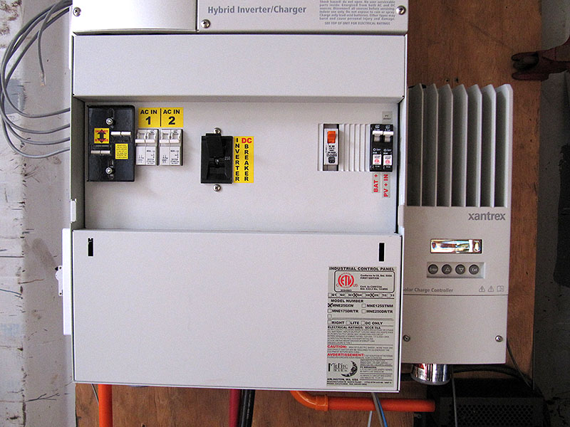

Xantrex XW4548 4500watt inverter charger that outputs 220VAC
This inverter meets all my foreseeable needs for power.
Xantrex MPPT60-150 solar charge controller
This charge controller was chosen because it interfaces with the inverter through a modified version of CANBUS.
Midnite Solar breaker box
This box combines breakers and all the connections needed to make a nice tidy and flexible setup for all the power connections.

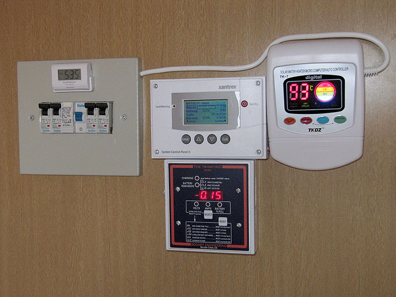

Xantrex system control panel and a battery monitor
Here you can see my control panel for the solar system, the battery monitor and the solar hot water controller.

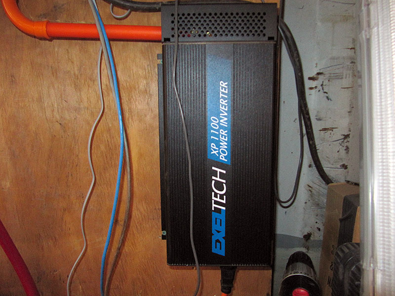

Exeltech 1100watt 120V inverter
I had many tools that I brought with me that were 120V, as it was cheaper to buy an inverter to power these than it was to buy everything again.

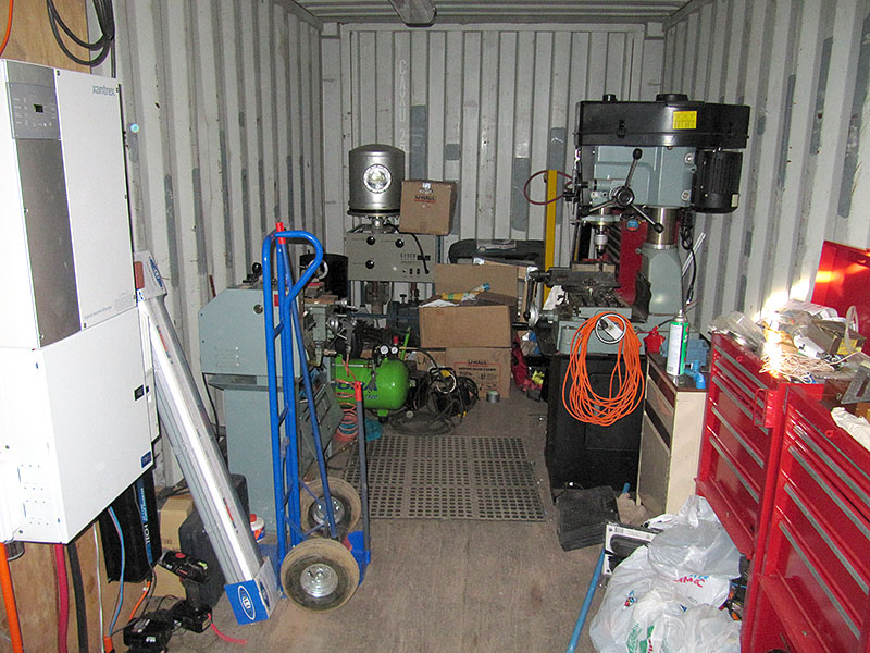

My work shop when it was clean
My system supports a fridge running full time, a wireless router, 3 notebooks running full time, satellite receiver, 32" HD TV, lights, a network storage device, an electric bed warmer for my girlfriend and I during the winter, my workshop, and a water pump. I also run a desktop quadcore with 2 monitors at times needed. In the morning a coffee maker is run once and a toaster. When needed a 1kW microwave is used to reheat food or other cooking uses. I make tea regularly with my 1400W electric kettle too.

So here, solar power works out very well when you can count on the sun 320 or more days out of the year. The high altitude also helps quite a bit.
I will post more pictures when  I get my 7new solar panels installed on the new frame and when I get my workshop clean again.

My system cost about $25000USD in the end, maybe a bit more. Because of my location I get what the panels are rated for and almost everyday. For other locations the panel requirements go up very quickly.
