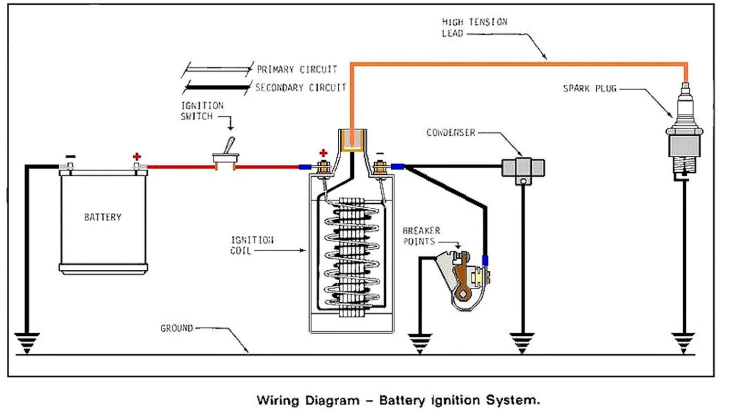

I noticed that in this diagram https://www.adriansmodelaeroengines.com/catalog/pages/images/Spark-Ignition/ASI-19.jpg all possible return paths for the high voltage going to the spark plug are obstructed by other components. Even though the spark plug's ring connector is grounded, that ground doesn't appear to provide a clear path for high voltage return. Ground isn't some magical location where electricity is dumped and it disappears. The current will try to complete the circuit back to its source (the source for the high voltage being the ignition coil).
One possible return path goes through the battery (not something you want to subject to a repeated sequence of high voltage surges).
Another possible path is the ignition capacitor but that's only designed for a few hundred volts, not 10s of thousands of volts.
The last possible return path (at least that would seem possible in this diagram) is the ignition points. But those open up to generate the high voltage surge, so they are already open when the high voltage surge attempts to return to the coil so that would force it to arc across this switch, damaging the switch contacts over time (something that the capacitor is actually designed to prevent on the primary side of the circuit, as without that capacitor to absorb the primary's inductive kickback, the hundreds of volts on the primary would arc across the switch contacts, damaging them).
So I don't see any possible return path for the high voltage in that diagram, that doesn't involve the current flowing somewhere that would damage the components. So is there some other possible return path just not taken into account in this diagram? If so, I'm curious what it might be.

Isn't it a flyback circuit?
 Energy gets stored in the coil when the points are closed. When the points open, the coil secondary flashes over in the spark plug thanks to the high turns ratio.
It's a high frequency pulse so passes through the capacitor easily. The spark plug gap takes all the volts so the capacitor doesn't have to.

Simple.
The diagram is wrong.
Any three-terminal ignition coil for negative ground usage has one end of the secondary connected to primary positive. And preferably a capacitor of 1uF or so connected from primary positive to engine metal. This is to stop the high frequency component of the spark current from traveling through the vehicle wiring loom as it finds its way from ground back to primary positive.
Edit -> Proof that the diagram is wrong is when the points open the primary negative terminal spikes positive several hundred volts but the HV terminal goes negative many kV. If the other end of the secondary winding was connected to primary negative as per the diagram then the primary voltage spike would *subtract* from the secondary HV spike.

return path is the battery, which is fine
Offline ejeffrey
  • Posts: 4091
The mindset that "return path for a high voltage pulse is special or difficult" is wrong.  The coil and the spark plug see the high voltage but what matters for return path is the current. The current is relatively small, a small fraction of the primary current.

Ignition coils most commonly have a 1:100 turns ratio, so if you interrupt 5 amps in the primary you will produce 50mA in the secondary circuit at whatever voltage is needed to make that current happen. The secondary side is a current source, not a voltage source.

Yep. Current flows through the coil when the contacts are closed. When the contacts then open the primary current is broken, which produces a high voltage primary-winding pulse of a few hundred volts, and an even higher voltage secondary-winding pulse of a few tens of thousands of volts. The output of the secondary drives a current through the spark plug and back to the coil through SOME ROUTE. It needs a return path to the coil.

Still that puts the spark current from the secondary-winding high voltage traveling back through the ignition capacitor. The ignition capacitor is intended only to delay the high voltage kickback on the primary so that it doesn't spark across the point contacts when they open. This allows the contacts to open without a spark, and thus avoiding wasting energy in that spark (as well as avoiding cumulative damage to the point contacts from all of the sparking that would otherwise occur). The ignition capacitor isn't designed to take HV return current from the spark plug. That return current is high enough, that even though it only lasts about a millisecond per pulse, that it will charge the capacitor momentarily to a very high voltage, that could potentially exceed the breakdown voltage of the capacitor's dielectric layer.
Online IanB
  • Posts: 12609
I agree with Circlotron. The diagram is very poor. It quite unclear how the far end of each coil is connected inside the can.
In the actual ignition circuit, the low voltage end of the HV coil is connected in series with the negative end of the primary coil, so the high voltage return path is through the primary coil, then through battery to ground (the battery having effectively zero impedance).
This is, in fact, the normal return path. There is nothing to worry about, since it is impossible to subject a lead acid battery to a high voltage surge. The internal resistance of the battery is so close to zero that high voltages across it cannot happen. It is effectively a short circuit. There is no need to worry about high currents either, since the battery is designed to supply hundreds of amps to crank the starter motor. There is no way a piddling little ignition coil is going to exceed the starter motor amps.

I couldn't readily find an online reference, so I drew you a picture.  There are other possible arrangements, C1 is optional and many 12V systems will have additional ballast resistors, but this the basic, common setup.  And yes, by positive current convention I suppose Ispark goes the other way.
