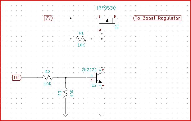

I think I've figured out how to cut off power to the entire boost converter circuit using the schematic below.
I'm using a BJT which has its base connected to the Q pin of the flip flop. Which is has its collector attached to the gate of a P-Channel MOSFET which acts as a switch for the main power going into the boost converter circuit. Please let me know if you believe this will work, any feedback is very much appreciated.

I believe you can just drive the mosfet gate directly from the /Q output of the flipflop, and do away with the NPN transistor.  The NPN inverts the Q output, but /Q is always the opposite of the Q output too, so you get an inverted Q either way.
If you use the NPN, you'll need a base resistor for it, and a pullup resistor on the mosfet gate.  But if you just drive the gate directly from /Q, I don't think you'll need either resistor.

In your circuit with the NPN you're missing a base resistor. But as Peabody said I would try using the /Q output to drive the P-channel MOSFET.

Thanks for your response. I was trying to follow this circuit layout
and I just realized I forgot to add the resistors in my layout!. I'm confused as to why /Q works but Q doesn't? I'm sorry for being a noob with this stuff, I was hoping you could try to explain? My understanding is that the pulse sent to the flip flop becomes inverted by attaching /Q to the data input pin. So the pulse leading edge hits the IC, it says turn on but because /Q is inverted and is attached to the data pin it stays off until the low end of the pulse hits which is not until the end of a 2 second delay due to the rc timer circuit and hence I get my long press to turn on the power. If I use /Q to drive the gate instead of Q wouldn't that completely ignore the delayed start I'm looking for?
Looking at this more closely I think I'm seeing another issue. The flip flop doesn't remember states, I want to make sure that the board isn't powered on when plugged into power to charge the battery. I've got an RC circuit on the CLR pin (R6 & C6) I'm just insure of whether this circuit is pulling the pin low or high. I believe its pulling it low but I want to be sure.
Assuming that using /Q would remove the delayed start then would this solution would still work correct?
You have the flipflop configured to come up with Q low.  You've done that with the R/C on /CLR.  But /Q is *always* just the inverted state of Q.  So the flipflop will come up with Q low, but also with /Q high.  High is the state needed on the mosfet gate to keep it turned off.  When the first long button press occurs, CLK will go high, and  the state of /Q (high) will be latched via the D pin to Q, which will bring Q high and /Q low, which will turn the mosfet on.  Both Q and /Q change state *immediately after* the rising edge of the CLK.  Nothing happens on the falling edge.  You get a falling edge when the button is released. Then the next long press produces another rising edge, which brings /Q high again, which turns off the mosfet.
Your NPN circuit is just an inverter for Q.  When Q goes high, the NPN brings the mosfet gate low, and vice versa.  But you already have something that always produces  an inverted version of Q, and that's /Q.  It should work exactly the same, but without the extra parts.

Edit:  You could also drive the mosfet gate directly from Q, but you would need to move the R/C over to the /PREset pin so the  flipflop would come up with Q high.

Ok now I'm really confused. This is a p-channel mosfet. My understanding is that you have to drive the gate high to turn it on and allow current to flow from the source to drain.  You're saying it has to have voltage applied to the gate to keep it off, which is incorrect as far as my understanding goes. Unless I'm confused and by high you mean no voltage applied and low means voltage applied? What am I missing here?

A p-channel MOSFET works like a PNP transistor in that you pull the gate toward negative to turn it on.

 Well, both P-channel and N-channel mosfets are turned off if the gate and the source are at the same voltage.  An N-channel mosfet will turn on when the gate voltage goes above the source voltage.  A P-channel mosfet turns on when the gate voltage goes below the source voltage.  So an N-channel mosfet works like an NPN bipolar transistor, and a P-channel mosfet works like a PNP transistor.
So your circuit with the NPN would work (with the resistors added). If Q comes up low, the transistor would be off, and the gate pullup resistor (when added) would bring the mosfet gate up to the same voltage as the source, which turns off the mosfet.
