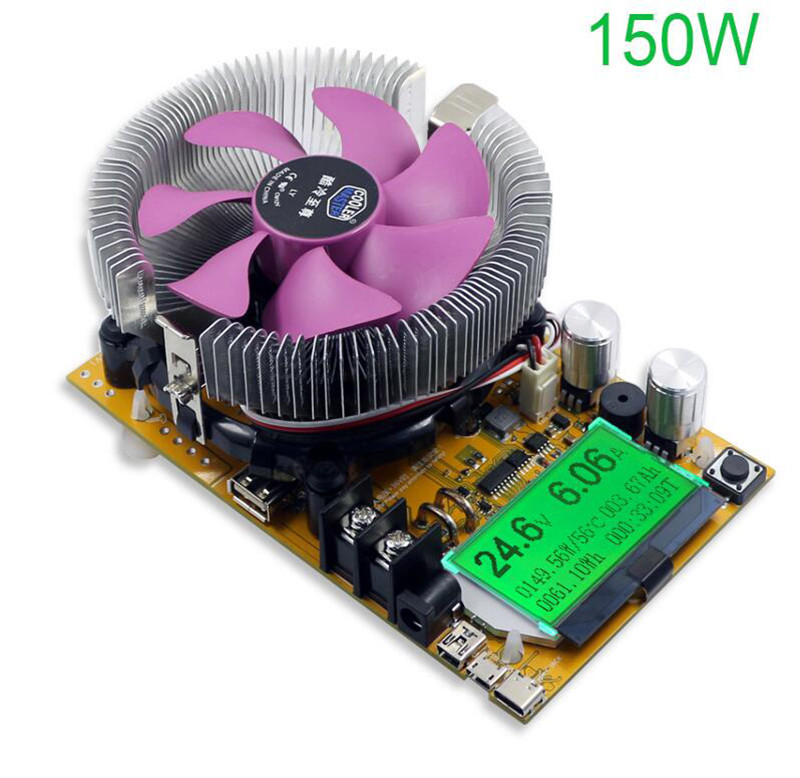

There are already such loads available on eBay, Alibaba, etc. for around $50 shipped. You might consider buying one for study and experimentation as you develop your own. Here's an example of a China-built, US-sourced unit:
https://www.ebay.com/itm/200V-20A-150W-Adjustable-constant-current-USB-electronic-load-DIY/183195778904?epid=20018516513&hash=item2aa751bf58:g:wrUAAOSwO0Ra4C1U
It's nobody's idea of a precision lab instrument, but it's a good starting point for figuring out what you want to do.

That exact unit is pretty useless as you can see here:
it advertises the features that it doesn't have, even the basic constant current. it's an analog circuit which is manually set using 2 pots which is where they cutting a lot of their cost. I want my unit to be actually useful and not a piece of junk. yes, I know such units exist and non of them are upto the task as they lack something important or they are falsely advertised.
