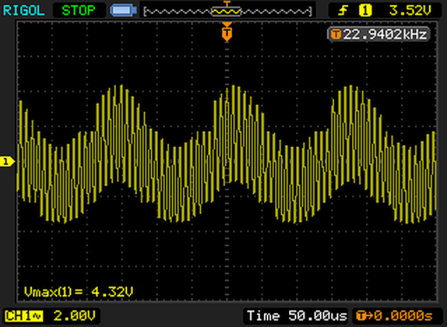

Hey guys, this afternoon I put together a little AM modulator for aligning and testing vintage AM radios, after playing around for a couple of hours I got something that works reasonably well, so I would appreciate any suggestions to improve this.  :-/O

Repectfully, what you have created is not amplitude modulation. It appears to be simply a summation of the audio and carrier signal. With AM, the carrier magnitude is varied with the audio. With your circuit, the carrier is simply shifted up and down with the audio, at roughly the same magnitude.
Take at look at the AM waveform on this wiki page, and compare it to your scope waveform to see the difference.

Ahh yes I see what you mean, guess I have more experimenting to do  ;D
