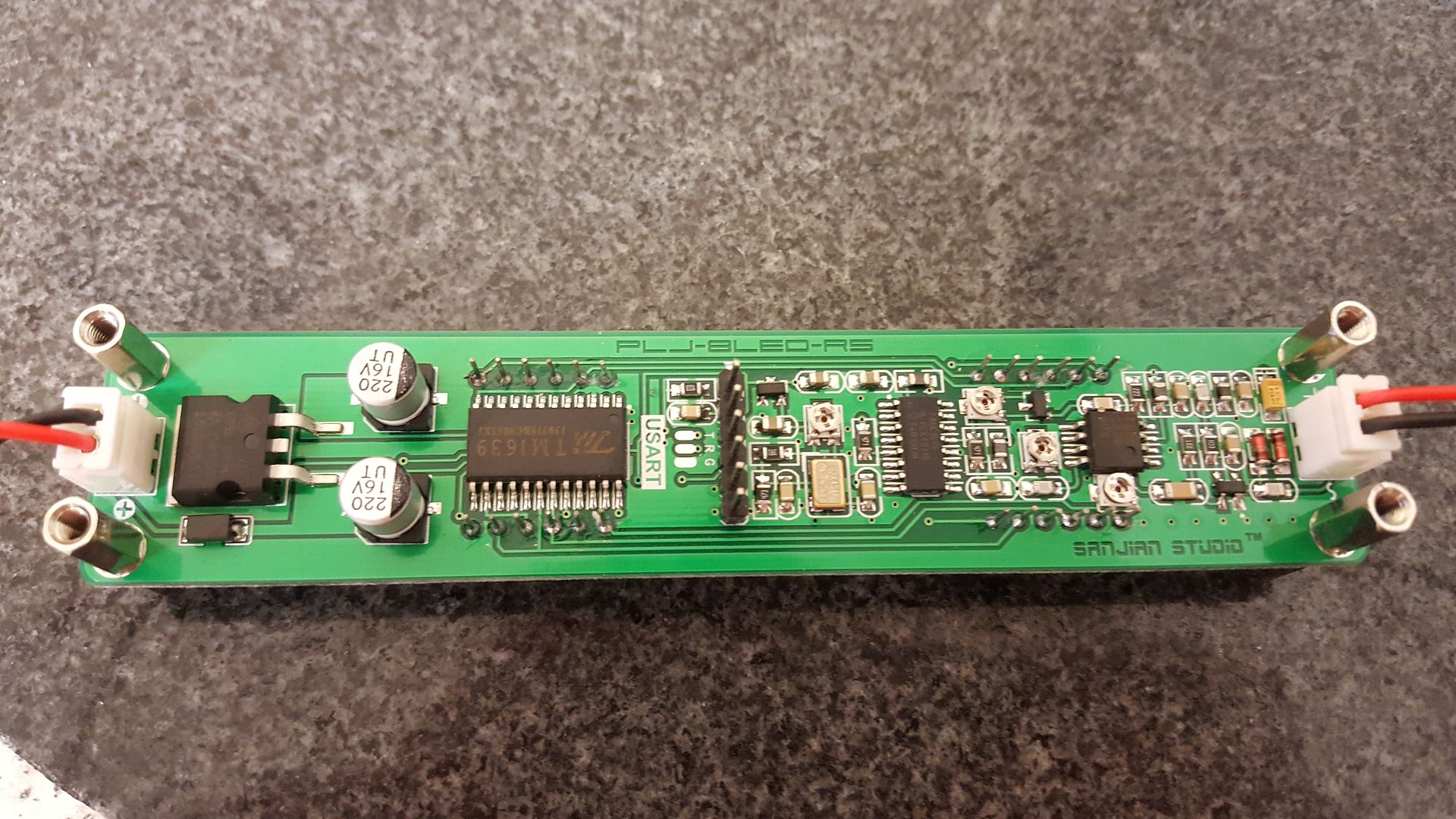

Ten Dollar Frequency Counter's - Thread #2
« on: September 10, 2016, 07:03:59 pm »
I couldn't reply to the existing thread so continuing in a new thread, mods may want to merge threads however  :-+
This is the existing thread: https://www.eevblog.com/forum/projects/ten-dollar-pic-100khz-2-4ghz-frequency-counter/
Just thought I'd add an update to this thread, there seems to be a slightly updated version of this available now.
I picked mine up for £8.72 on eBay, shipped from Hong Kong, only took about a week to arrive to the UK.
The device was in a typical Antistatic bag and labled as a Sanjian Studios PLJ-8LED, the PCB silkscreen has the model PLJ-8LED-R5,
I have to be fair, I wasn't expecting much for the money but it works really well!, as I'm a radio ham as well it will have many uses on my work bench.
Differences I can see so far to other versions are:
PIC Microcontroller is not on the rear, it's under the LED Segment display, not sure of the type without connecting to it Via the ISCP port or removing an LED Segment, it appears to be a QFN package.
There is a TM1639 LED Driver IC on the rear.
Voltage regulator is a ST L7805CD Linear regulator, I noticed some other versions have a switching regulator so pleased about this.
This was advertised as up to "2.4GHz" Some are advertised as up to "1.1Ghz", the prescaler is a Fujitsu MB506 which is the correct 2.4GHz part, I know some came with MB501's, however I doubt I will be using it on anything over 500MHz.
I tried it out on a few things and am very impressed for the price, there is one Gotcha though on all of these... On the signal input the red wire goes to ground rather than signal input, just pay attention to the boards silkscreen rather than the cable colour, they could have rotated the socket on the signal input to resolve this.
Here are some pictures of mine, also a picture of the firmware version, you can get this by holding the top button while applying power, but this will reset your settings too.
I managed to find a English manual online, with some additional information added, however this is for the C3 revision, but aside from PCB Layout/Component differences the operation is the same:

Offline TheBayTopic starter
  • Posts: 1032
  • Country: wales
Re: Ten Dollar PIC 100khz-2.4ghz Frequency Counter - Thread #2
« Reply #2 on: September 10, 2016, 08:03:21 pm »
I noticed the linear regulator gets a little warm but not hot per say, however a little heat is quite useful for the TCXO :)
What version are yours, it will say on the PCB Silkscreen. Has it got a linear regulator or switching?

Thanks for those pictures, yes they are certainly different!
I see the Blue one is a PLJ-8LED-R5 just like mine, I guess this must be the latest revision.
The Red one looks like it says PLJ-8LED-H2? but hard to make out.
I wonder if the red one has the LED driver under one of the LED's.
This layout has obviously been changed for a reason, assuming that's the reason the Blue one works better and uses less power.
Also will be interesting to mess around with the firmware, seeing as it has an ICSP socket, but I am yet to find any firmware files online.

Do any of these come with a simple serial port output of the reading? With let's say a 1 per second dump at 9600 baud?
That would be immensely more useful than a display, really.

These little counters are excellent value for money, they use a cellphone TCXO for stability and are pretty accurate out of the box, the ones I've had certainly compared well to my Racal with the high stability ovenised reference calibrated against a GPSDO/Rubidium standard.
The IF offsets are really handy too, selectable on the ICSP pins by applying a voltage, they make retrofit to a radio really simple.
WIsh I could find the firmware for the earlier version though as an unfortunate experiment with a PICKit3 means I've got a bricked one.

Noticed something unusual about this LCD frequency counter, it seems to be transmitting a low power beacon on 446.000MHz FM Modulation.
Can't find any information about this device anywhere online, there are 3 jumpers on the back, 2 of those seem to relate to a + or - offset on the frequency displayed but both different values!
I wonder if this was originally designed for a specific purpose other than a general frequency meter?

« Reply #23 on: September 26, 2016, 03:24:00 pm »
http://i1086.photobucket.com/albums/j457/thebayuk/EEVblog/20160912_194009_zpst7l83b0f.jpg
I just bought this one, arrived in 8 days from freaking china to europe! Was so excited to test it and it's crap..or something is wrong with it.
I try it with both 433MHz and 315MHz car fobs and it displayed mostly 145MHz and 202MHz and sometimes 50MHz. Thought it needed a longer transmission so I checked those cheap garage remotes (433MHz) that keep transmitting as long as you press the button(checked with RTL-SDR) and got the same unusable results.
I don't think I have anything to test it at lower than 315MHz, but at these ranges it doesn't work. I guess I will reverse it a little and scope it when I have time.
EDIT: I made a very quick schematic of the part that interest me just by looking at bottom pcb tracks, didn't dismantle it yet. (MAY HAVE ERRORS!)
Component values were copied from pcb silkscreen, not measured (yet)!
EDIT2: I just checked with the scope and I get 6.76MHz going to atmega48 input, x64(configuration from MB501L) = 432,64MHz!! (yet it displays something completely different like 175MHz)
So the problem seems to be in the firmware

« Reply #24 on: October 06, 2016, 10:44:44 pm »
Interesting, though I have tested mine around 450Mhz+ and it displays correctly, could it be faulty and do you have an antenna on it as mine won't pick up anything without it.
