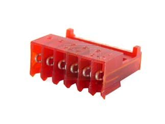

But not a IDC. Those suck. Try to find some kind of connector like a DIN DBx connector that has a ribbon cable acceptance and solder or crimps. I find quite a bit of failed IDC, especially MTA in things like lab PSU, particularly on the front panel where the potentiometers are. Sorensen seems notorious for this. I hate IDC. I would recommend soldering over IDC. I think all 3 of my broken soresen power suppies had issues with the IDC MTA style connectors.
IME I've seen way more crimps failing compared to IDC. I mean usual IDC with a fixing clip on top. IDC MTA like on the picture below have horrible reliability.

For anything but production with pneumatic calibrated tools I would recommend solder cup types for DB cables.
Actually with usual IDC it's very hard to do anything wrong unlike with crimp connectors. There is a fixed distance how much you can push the clip until connector fully closes and you cannot push any further. I usually simply place IDC connectors in a vice (with flat shims).
