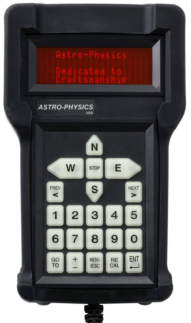

So neat to hear about the past uses. I'm 20, so I grew up in the age of pushing Moore's law to its limits, I didn't get to really analyze the neat things coming out early 2000s. I can only imagine this was really high spec stuff that every company wanted their hands on. I think in this AP Keypad it's the device that holds the authentication data for the software, because back in the day this was the bees knees for telescope mount control. It still is, but the use of devices like the SkyFi where you can control movement with your iPad/iPhone has surpassed it. They were most likely really concerned about reverse engineering.
Heres the keypad in question:
