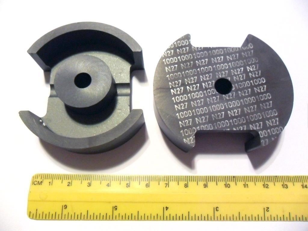

Pardon my nube-like ignorance, but why don't toroid mfg's make something like an intermediate product, split in half and supplied in matched pairs with some ferrous bonding slurry and catalyst? It would make shipping them a little easier too. Winding's could cover 350 degrees of the core perhaps with the aid of 4 plastic slip-on L-rings, but would that bring down efficiency too much to be a viable product?
Online Psi
  • Posts: 10385
Re: Toroid Winder w/o cutting the wire.
« Reply #13 on: May 23, 2019, 01:29:00 pm »
It is possible, you just have to use one of the extra spatial dimensions predicted by string theory.
That will let you move wire from outside to inside the toroid without having to break it.
Good Luck
Offline digsys
  • Posts: 2209
    • DIGSYS
« Reply #14 on: May 23, 2019, 01:38:17 pm »
Quote from: Cliff Matthews
Pardon my nube-like ignorance, but why don't toroid mfg's make something like an intermediate product, split in half and supplied in matched pairs ..
They do ! They make ALL type torroids - split / layered / slotted / gapped etc etc and they ALL have totally different properties ! and uses.
The science of how they work / material used / shape / winding patterns etc etc is VERY complex and few people understand completely.
ANY interruption to the consistency of the donut has major side effects, which are not fixable.
For the majority of uses, the 1 piece donut is the most preferable. If there was ANY solution, it'd have been implemented long ago.
Online Ian.M
  • Posts: 13216
« Reply #15 on: May 23, 2019, 01:45:26 pm »
You can get split toroid cores - they are frequently used for retrofitting common mode HF EMI suppression.
However for split core transformers and inductors, a pot core is generally preferable.  A pot core bobbin is cylindrical so is much easier to wind, and as the ferrite core nearly completely surrounds the bobbin (apart from the slots to bring out the winding ends, field leakage can be lower than a toroid, even if its gapped by grinding the center leg.
Use a simple toroid winder and you can cover 360 degrees of a cheaper, simpler and more predictable core.
Online Psi
  • Posts: 10385
« Reply #21 on: May 24, 2019, 02:55:01 am »
Be careful when re-using those half toroids with the bobbin.
A lot of them have a small air gap in the center ferrite column and it's not very obvious when looking at them.
Ones with the air gap are intended for other uses and as far as i understand this makes them pretty much useless for power supply inductors?
Can anyone confirm this?

« Reply #22 on: May 24, 2019, 07:40:51 am »
Gap is good for inductors (stores energy) and bad for transformers (transmits power) and CMCs (blocks transmission of power).
The latter two are really the same thing, used in two situations.  Transmission of power to ground is bad for transformers; transmission of noise in series is bad for CMCs.
