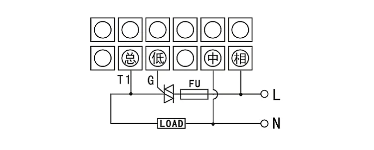

A temperature PID controller with SCR (= TRIAC, Phase-Shift Trigger) output. Ask the vendor if the triac is internal or if t has to be wired externally. A temp sensor will also be required.
