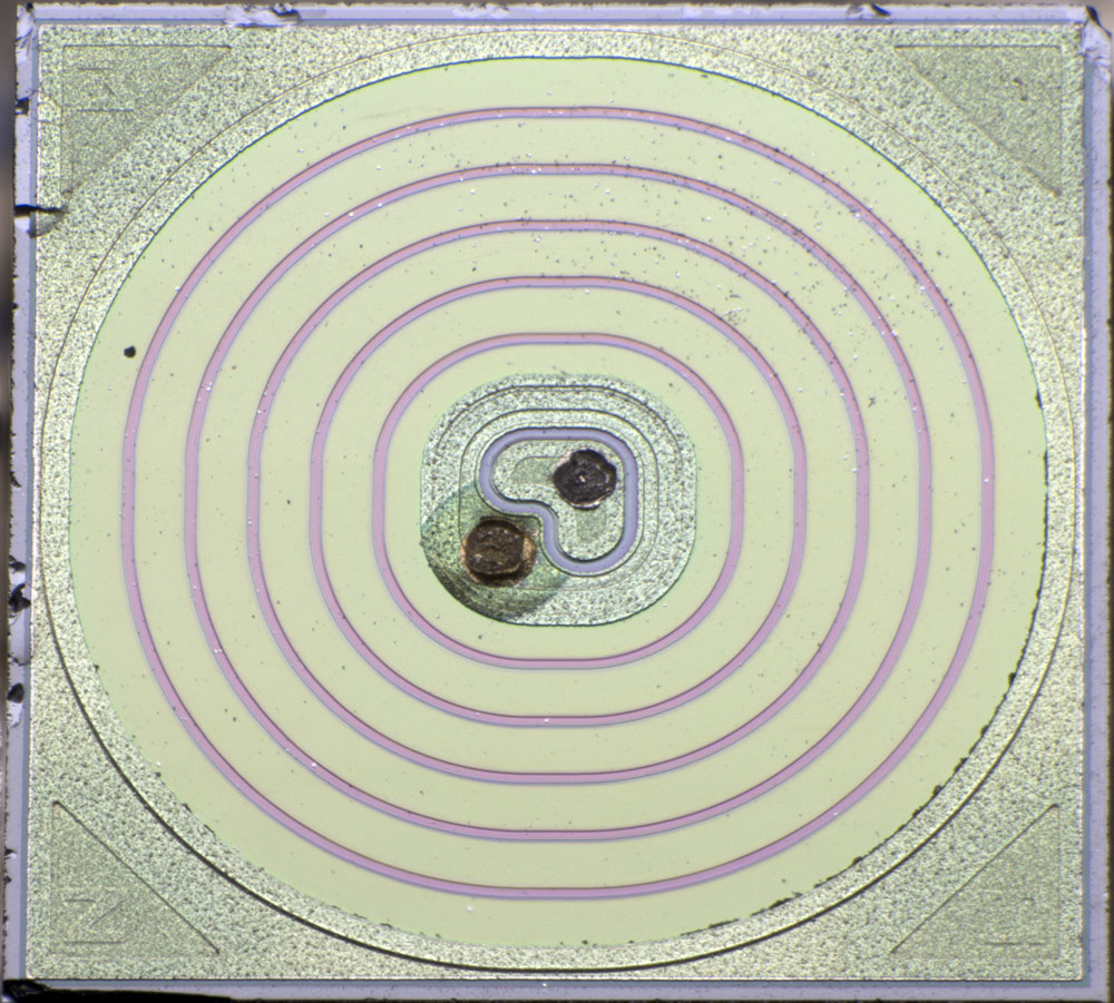

The Sanyo 2SC4632 is a bipolar transistor that blocks up to 1200V. The package is fully insulated and has recesses between the pins which increase the creepage distances. Despite its large design, the 2SC4632 is not really a power transistor. The collector current must not exceed 10mA continuously. For short periods 30mA are permissible. Although the thermal resistance is specified as 12,5K/W, the power dissipation must not exceed 2W. These two parameters do not seem to fit together. The amplification factor is given in the datasheet as 10-60. The cutoff frequency is typically 6MHz.
This could be a reconditioned component. The surface of the package is somewhat scratched and the tinning of the pins looks unclean. It is not a fake, as we will see in a moment. The structures of the 2SC4632 are known and can be found in this component.
Compared to the package and the heatspreader it contains, the die is relatively small with an edge length of just 1,7 mm. A large part of this area is used to control the potential distribution so that no problematically high field strengths occur.
The active area itself is just as small as in the low voltage small signal transistors we have already seen a lot.
https://www.richis-lab.de/BipolarA57.htm
 :-/O

The Sanyo 2SC4632
Ah, so the actual transistor is that tiny region in the middle of the die? What is the rest? Does the rest of the die carry any current?
Exactly, the active transistor is the tiny thing in the middle.
The circles don´t carry current they are just for a better electric field distribution.
Here you can see some simulations of the electric field in a transistor: https://www.researchgate.net/figure/Color-online-Electric-field-distribution-when-the-electric-field-reaches-E-C-257-MV_fig4_352335818
At low voltages the distribution of the electric field is no bigger problem but above 100V you get a very high electric field strength at the edges of the base area. You can lower the doping to get higher breakdown voltages but that is bad for other parameters. These circles are a better solution. They distribute the electric field over a larger area, lowering the peak at the base collector junction.
They are doing the same in the real high voltage area: https://journals.nipes.org/index.php/njstr/article/download/400/418
If you were wondering what such an oddball device is for, consider dynamic focus in Trinitron etc. sets:
https://web.archive.org/web/20151229031656/http://home.arcor.de/thomasfetzer/Sanjo/SY103A_e.pdf
p.11 (12).  Spittin' image of it :)
Crude cross-sectional diagrams are included too; fascinating.
I clicked on this document searching about FBET actually, but the detail (however modest) they give on all is quite nice.  (Evidently part of the FBET "innovation" is simply using two metal layers. On a dumb BJT, who'd have thought? :D )
The doc basically reads as a who's-who of all the special transistors in my final Trinitron monitor. :popcorn:

Sanyo 2SC4632
My mistake:
2W is the maximum power dissipation without a heatsink.
With a heatsink the thermal resistance of the package is 12,5K/W.

2 watts is about the limit for any TO-220 packaged part without a heat sink, including regulators.  The plastic encapsulation on an insulated TO-220F package does not make any difference when it is only exposed to air, so it is also 2 watts.

Exactly!
I somehow didn´t understand what the datasheet tried to tell me.
