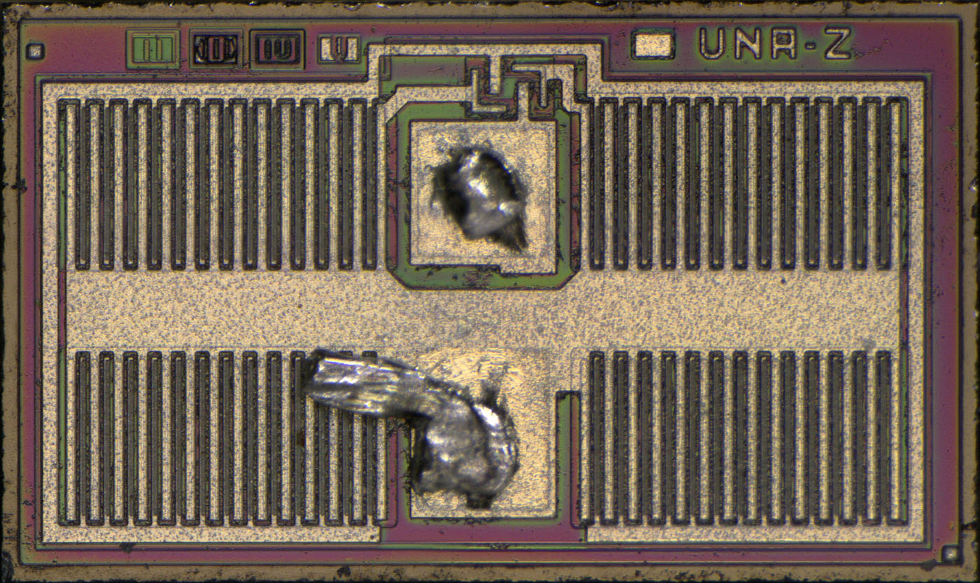

The Siliconix VN88 is an old Power-MOSFET.
The die is 1,8mm x 1,0mm and was protected with a silicone like potting.
That´s an interesting die marking.
There is a small resistor between the gate bondpad and the gates. The surrounding area is connected quite massive to the source. Probably that is a zener protecting the gate-source-isolation.  :-+

Interesting, they don't show the zener, at least in the -AFD (TO-220) version, at least in the Vishay/Siliconix datasheet from 2001.
Not sure if that's V-groove (VMOS innit?) or trench (VDMOS?), definitely not lateral in any case!

Nothing in the datassheet. I found that interesting too!  :-+
Some people state it is a VMOS...
