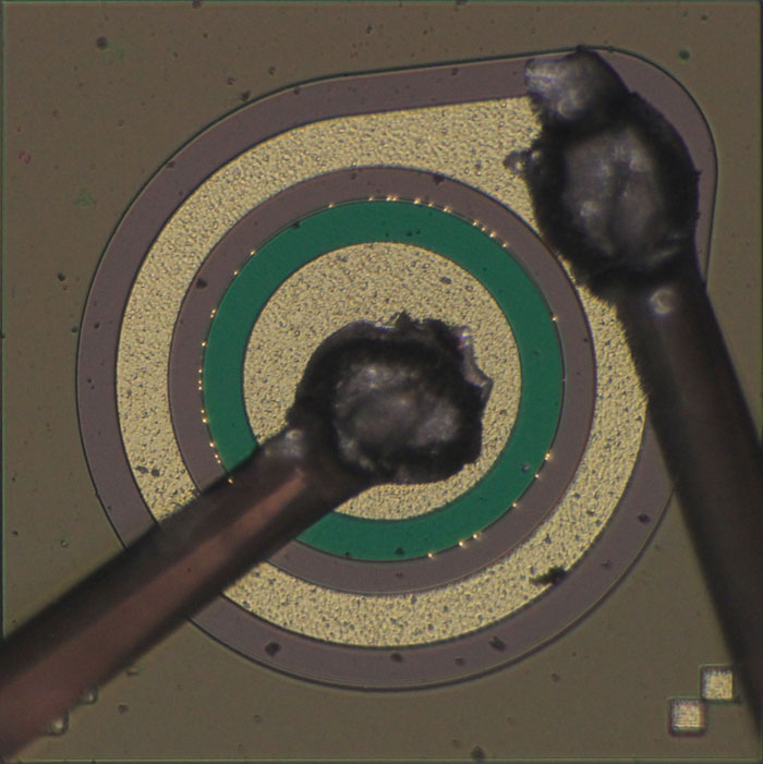

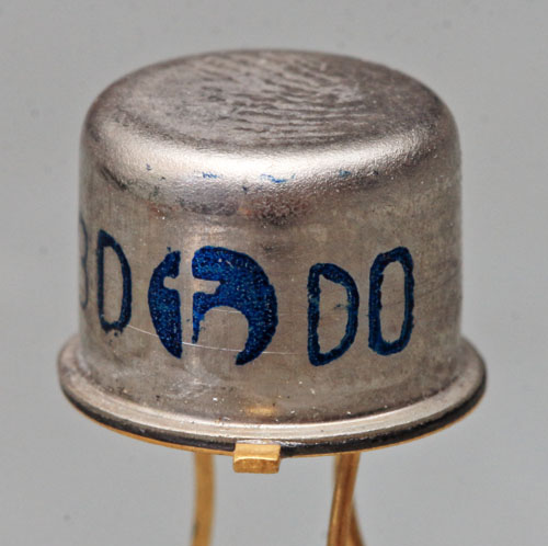

« Reply #581 on: April 23, 2022, 08:52:19 pm »
The SF123 (TO-5) is a transistor built by the Halbleiterwerk Frankfurt Oder. DO stands for a production in April 1974. The maximum collector emitter voltage is 40V. The SF122 and the SF121 appear to be poorer grades. They offer the same specifications, but Vce is just 30V and 20V. The SF123 allows 100mA continuously and up to 600mW.
The datasheet recommends the SF123 for LF and RF applications. However, the cutoff frequency is not excessive with typically 130MHz, minimum 60MHz. The SF137 (https://www.richis-lab.de/Bipolar75.htm) with its cutoff frequency of at least 300MHz is more suitable for high frequency applications.
As with the SF137 the current gain spread was initially very high. Values between 18 and 1120 were allowed. The transistors were binned in six groups. The SF123D offers a current gain of 112 to 280. This fits with the fact that from 1970 on just D and E types were produced.
The SF123 is a simple planar transistor. You can see that looking at the collector emitter saturation voltage. The transistor is manufactured on a n-doped substrate that forms the collector. In this substrate you dope base and emitter areas. The datasheet specifies a maximum Vcesat of 1V. The SF137 on the other hand is a planar epitaxial transistor. The substrate is heavily n-doped, which guarantees a low collector resistance. However, the collector region itself must not be doped too intense, otherwise the blocking voltage will be very low. For this reason, a thin, less heavily doped collector region is epitaxially deposited on the highly doped substrate. The result is a maximum saturation voltage of just 0.3V.
With an edge length of 1mm the die is twice as big as the SF137.
And some light...  8)
-8V 10mA
20mA
50mA
80mA
400mA
https://www.richis-lab.de/BipolarA02.htm
