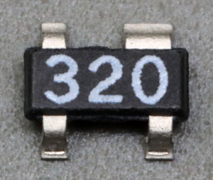

With the AT-32011, Hewlett Packard had a fast bipolar transistor in its portfolio. The AT-32011 is optimized for applications with low supply voltages in the frequency ranges 900MHz, 1,8GHz or 2,4GHz. According to the datasheet, the transistor is based on a self-aligned transistor process with a cut-off frequency of 10GHz. The maximum reverse voltage is 11V. The collector current must not exceed 32mA. In order to achieve a high cut-off frequency, a very high doping was selected, which is reflected in the low base-emitter breakdown voltage of -1,5V.
The edge length of the die is only 230µm. The labeling shows that Hewlett Packard developed the design in 1994. 320 appears to be the designation of the basic project, from which at least two bins emerge. In addition to the AT-32011, the datasheet also lists an AT-32033. The AT-32011 offers a slightly higher amplification factor than the AT-32033. The emitter connection is marked with an E, which is covered here by remnants of the bondwire.
The transistor structures themselves are too small to be resolved. They are located under the dark strip in the center, which is approximately 70µm x 15µm in size. The datasheet reveals that there are 20 emitters with a pitch of 3,2µm. The base connections are located between the emitter connections and both must maintain a certain distance from each other. This means that a resolution of less than 1µm is required in order to be able to image the structures to some extent. The comb-shaped contacts can just be guessed.
