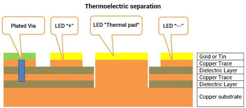

I'm working on a product where I have a chip that could dissipate up to 9W.  And I'm trying to get it IP68 ingress rated...
My current prototypes aren't well sealed up and the (BGA pin-style) 28x28x10mm heat sink is adhesive taped to the top of the DRV8144 chip (which is what's generating heat).  Transfer from the chip to the heat sink is okay (though the small chip + large heat sink isn't ideal, but nothing I can do there) but the heat sink is undersized by at least half.  It runs fine at ~5W dissipation but somewhere around 7W (in 30C ambient) it can't keep up and overtemps.
I'm considering switching to make the board as a 2-layer aluminum board with this kind of stack up:
That would let me put all my components on one side, then put the heat sink on the opposite side attached directly to the aluminum board.  That would turn the board into a heat spreader and (hopefully) reduce overall thermal resistance between the heat pad on the chip and the heat sink.  It actually also solves some other ingress-related issues for me too.  I'd probably also solder-mask the bottom side (in the pic above) and have a large "pad" where the heat sink is going to attach (with adhesive + mechanical retainer).
I just can't convince myself that passing heat from the bottom (solder) side of the IC all the way THROUGH the board to the heat sink is actually less resistance (or about the same) as what I have now.  Any thoughts from thsoe of you dealing with heat and heat sinks more than I have (I'm new to all of this)?

Offline mtwieg
  • Posts: 330
Re: Aluminum PCB for Thermally Challenging Design?
« Reply #13 on: December 09, 2024, 05:55:52 pm »
Might be helpful to do some simple back-of-the envelope math.
FR4 thermal conductivity is around 0.3W/(m-k). The area of the full chip is 3x6mm, and the FR4 thickness is 0.15mm. So that sliver of FR4 is going to have a thermal conductivity of 0.3*(0.006*0.003/0.00015) = 0.036 W/k, or 27.8 C/W. That's already too much to support 9W (even before adding the additional 6.4 C/W from the package itself). If you go for a stackup with two layers on the same side, that doubles the dielectric thickness as well.
Unless the stackup supports vias connecting the copper layers directly to the aluminum substrate, I don't think the aluminum substrate will help much.

I suspect Texas Instruments is expecting the addition of copper vias at the pads to take advantage of the package's bottom thermal resistance, as would be done with a package that has a thermal pad on the bottom.
It would not hurt to add a heat sink to the top as well.  Every little bit helps.
I'm still a little unclear as to whether or not that layer is actually FR4.  On the source page of the image I posted above, someone asked a question at the bottom about the type of dielectric and got this answer:
Going up (in thermal conductivity) to any of those values makes the back-of-napkin math more palatable.  There's not a good way to run vias through to the substrate on aluminum, but on the copper ones (which must have some different capability) they show a stackup like this:
In my case, this wouldn't help much since the package I'm using doesn't have a thermal pad, but it seems like there might be a creative and more direct way to move heat through the board itself.
EDIT: Also, there is indeed a HTSSOP version of the beefier DRV8145 that DOES have a thermal pad, so I might be able to take advantage of this straight shot from thermal pad to copper substrate.
