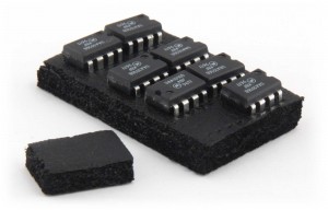

I wouldn't keep them loose in non ESD box. My situation here is similar and I keep the components in plastic dissipative bags (pink) stored within a metal candy box.  Another option is inserting them into those ESD foams
ESD damage is not all or nothing, sometimes the damage partial and your boards will still pass the test.
