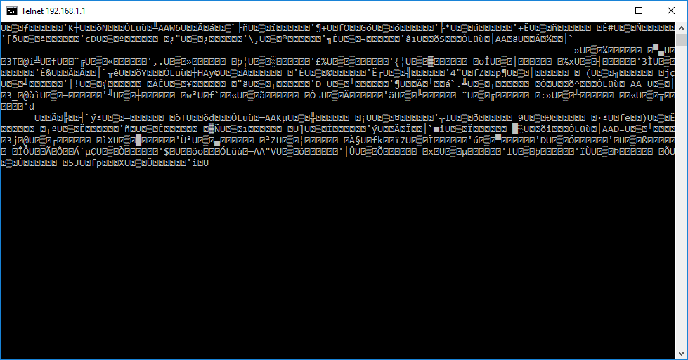

You can check if the remote sends data by "telnet 192.168.1.1 2345" from a DOS command prompt (you might need to install the telnet client first with the standard Windows applications). If this looks like this, and new garbage characters are written all the time, the connection to your remote works:

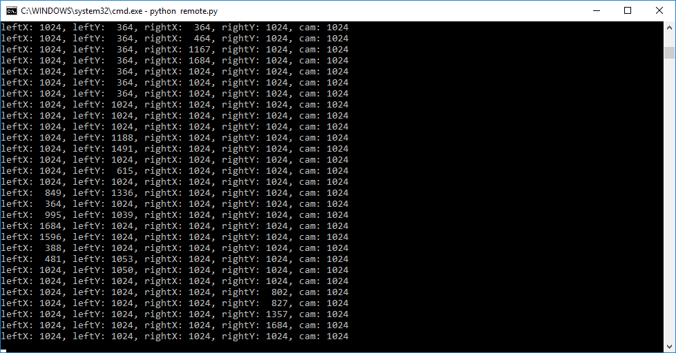

Next install Python 3. Then use this script to test if the stick positions can be read:
import socket
import struct
s = socket.socket(socket.AF_INET, socket.SOCK_STREAM)
s.connect(("192.168.1.1", 2345))
def word(b0, b1):
    return (b0 << 8) | b1
def conv(w):
    return (w / 8 - 128) & 0xff
while True:
    data = bytearray(s.recv(1024))
    if len(data) == 26:
        rightX = word(data[12], data[11])
        rightY = word(data[14], data[13])
        leftY = word(data[16], data[15])
        leftX = word(data[18], data[17])
        cam = word(data[20], data[19])
        print("leftX: %4i, leftY: %4i, rightX: %4i, rightY: %4i, cam: %4i" % (
            leftX, leftY, rightX, rightY, cam))
Save it as remote.py and start it from a DOS prompt with "python remote.py". It should show something like this:
