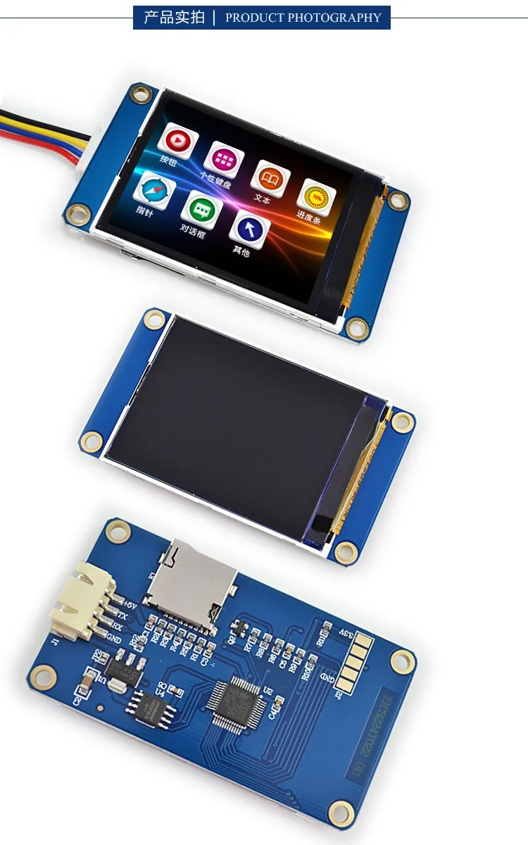

Why not an easy programmable color serial LCD ( HMI ) like this one,  cost is approx 5 USD, no tooling no nothing, and design can be changed at any time the software guy wants
That's a $15 screen by the time it reaches the customer. The quality seems unknown.

« Reply #133 on: October 24, 2017, 10:33:46 pm »
Be very wary of that product shot.  The screen's picture looks absolutely perfect, with pure blacks and perfect whites, even better than the contrast of the rest of the photo.
The picture is obviously photoshopped, I thought it was obvious to everyone.
because there's about 3 pages discussing that in the thread already and dave has explained why not multiple times?
