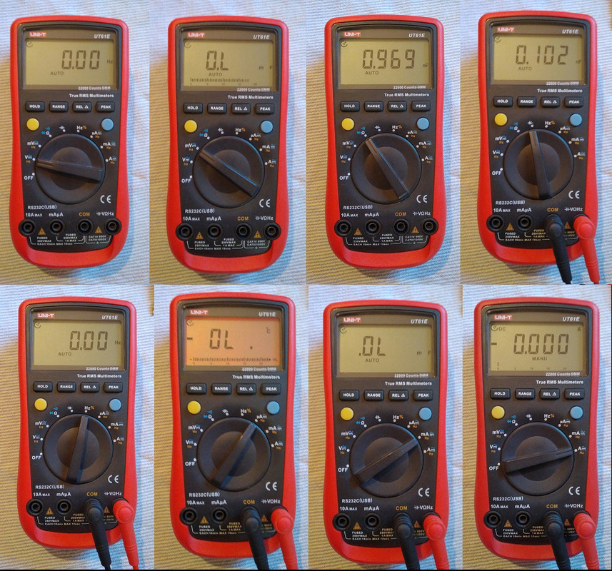

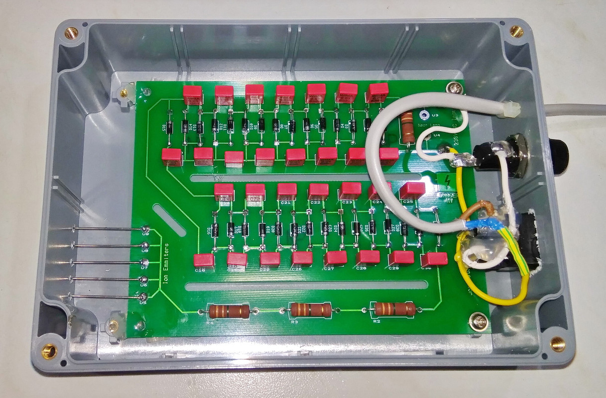

This was my first try to make a 15 stage ionizer and I had the brilliant
idea to use my UT61E to debug it.  A probe on the wrong component
and after a tiny flash the UT61E was zapped to oblivion...  |O  I don't care
about the meter itself as much as the work I've done for all the upgrades
it has.  So any help would be much appreciated!
The Killer :
The "new" selection modes after the zapping :

The meter works correctly only in capacitance and Amperes mode.

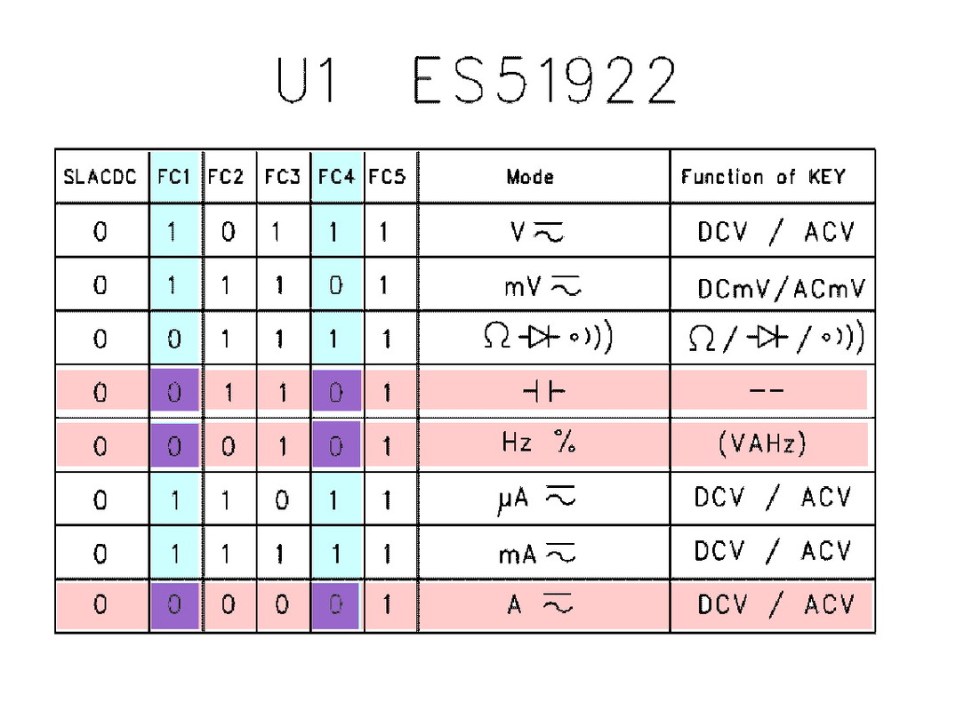

D4 controls the FC1 & FC4 lines and if you have a look at the table below you can see
that these are the modes when FC1 & FC4 are zero.  Would the above behavior be
normal when one of the diodes inside D4 is shorted?

I've connected 2 diodes together in place of the double package.
It looks like the IC internal pull up resistors are messed up.
I've also connected two pots from ground to FC1 and FC4 and
after some fiddling I've manage to show all the selection ranges
in the correct order but Volts mVolts and Ohms do not work
properly.  The pots were at approximately 48Ohms.
Any ideas?  Is it dead?  :(
Offline hggTopic starter
  • Posts: 960
  • Country: gr
Re: UT61E vs Ionizer
« Reply #23 on: December 15, 2018, 09:10:52 am »
Zero is -3.0V and One is floating around -100.0mV
In all modes except mV, Hz and Amps FC4 and FC1 lines show -2.5V or -1.5V instead of -3.0V
How can I find the values of the pull up resistors that the IC needs?
I am preparing the garbage bin with a new plastic bag...
