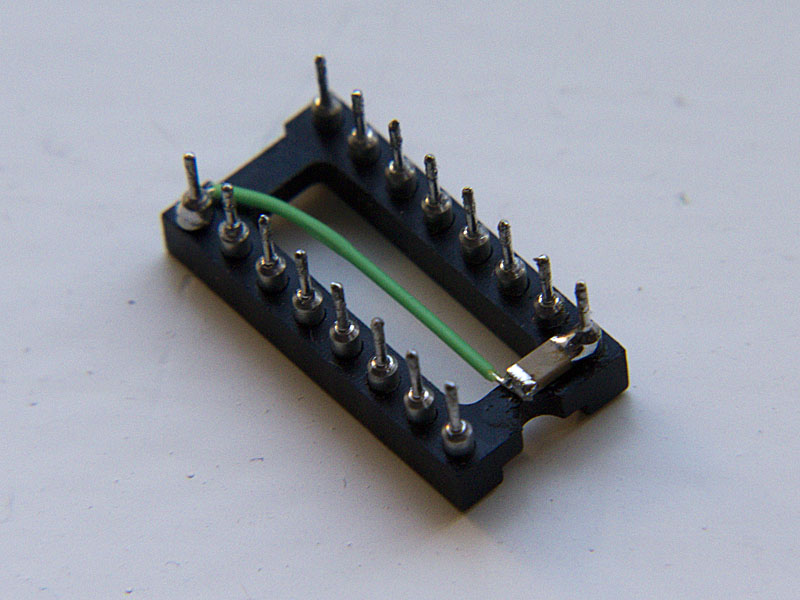

Small decoupling caps (100n) should fit inside / under DIP IC sockets.
Perhaps you could take the single-step circuit and put it on a separate small board and plug it in only when you need to debug?
You just need a small header for it to connect to. That may free up a couple of ICs worth of space.
Yes, i considered doing that but changed my mind when I saw the price of the sockets with a cap incorporated - I don't have any axial lead 100nF caps in the parts bin to check the idea but I think that there would be enough space by the pin shafts of a turned pin socket to carefully wrap the leads around on the diagonal and then solder it to the corner pins. I might try that if I need to go tighter on perfboard any time.
What I do have in the parts bin is a load of rectangular 220nF caps.........
I don't have any axial lead 100nF caps in the parts bin to check the idea....
However, what I do have is some 100nF MLCC's in 1206.
Fiddly, but very, very tempting.

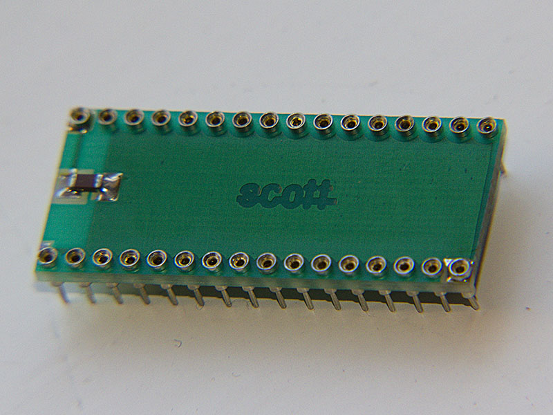

These were the 32 pin ones that I found - seem to have two tubes of them. Not sure why - I suspect that I acquired them as part of a junk lot.

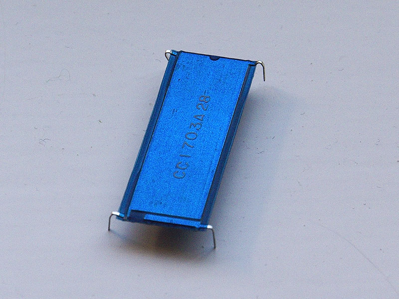

Finally I found these interesting beasties hiding under a 32kx8 RAM chip in a spare board (a 68C11 based industrial controller)
Seems I have 28 and 20 pin variants. I can't find any data on them - they measure about 70nF on the corner pins corresponding to 14 and 28. However there's a chance that the boards they came out of still work so I am reluctant to recycle them for the moment.

Hehehe,  nice tinkering.
The others - never seen those before.
Nor I. Once I realised that the CC is followed by an 'I' not a '1', I found a dead eBay auction which confirms that they are supposed to be 70nf and made by Circuit Components Inc. A bit more googling and I finally found some data here http://www.parttarget.com/5910-01-272-2276_5910012722276_UQ-28-07.html/-F9811F01-896C-4F7F-8B56-A39268D08095

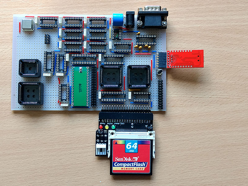

Starting to look like everything will go on the board OK
Current plan, the layout has needed a few more minor tweaks.
+5V routing added and gate connections as it makes it easier to wire it up. I just print out the layout A4 sized and work from that.
Hmmm, just realised I don't have +5V on the right edge of the board for the TTL level serial port and the parallel port connectors. Could be tricky to get it across.
« Last Edit: April 08, 2017, 10:19:23 pm by grumpydoc »

Looks nice. Are you going to put all the wires on top (that is what I usually do) or just the plumbing?
There is still space on the top of the connector to put in extra pins... (fill out to the nearest standard number of pins ;-).
Or an extra screw terminal (two) just below the RS232 connector...?
No, just the power plumbing, then the solder side is clear for the signal runs.
[2c]
I have it sorted, If I run the ground line that connects to the MAX232 capacitors under the board an extra couple of pads (dotted lines run solder side, in case it wasn't obvious) I will have room to tap of the +5V going to the MAX232 past the end of the right most quad OR gate and then run it along the set of holes parallel to the 0V run.
I'm actually considering trimming back the parallel port connector to 20 pins, I have loads of 20way ribbon cables already made up with IDC headers but no 24-way ones which I will have to buy.
I originally wanted to put in a right angle double row female header but there isn't quite room, that way if I a matching right angle header on any expansion board it would just plug in.

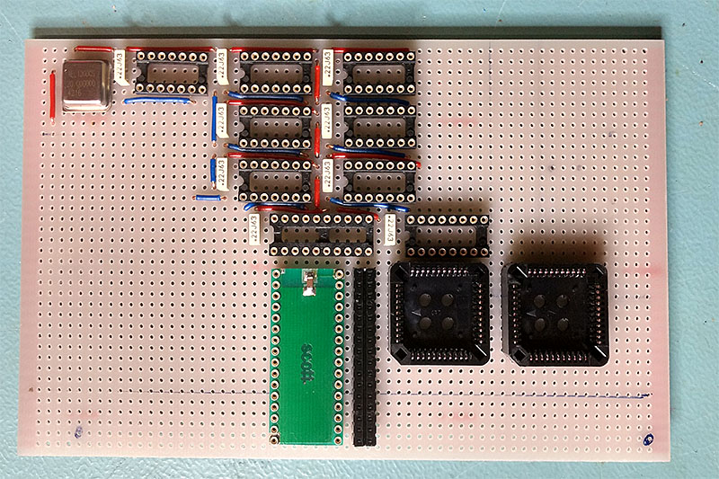

OK, well I had hoped to have the sockets placed and all the +5V "plumbing" done before the Easter break but, not quite.
Construction is shaping up nicely though
I'm still in two minds whether to get a right angle header with longer pins and flip the CF card 180o so that it sits over the PIA & SIO which would be neater.
The small PCB to the right is a USB serial adapter.
« Last Edit: April 12, 2017, 10:22:39 am by grumpydoc »

« Reply #44 on: April 12, 2017, 07:34:06 am »
Looks good!
I'm still in two minds whether to get a right angle header with longer pins and filp the CF car 180o so that it sits over the PIA & SIO which would be neater.
I would first get it working. The way it is now gives you access to the chips for debugging/probing.
Just try to target each pin with only one wire (on the bottom side I gathered) and it'll be easy enough to replace later on.
I've more or less decided to flip it around, it looks much uglier than I expected with the CF card sticking out from the board, and it fits very nicely the other way around. If needed I can always put the CF card on a short length of 40-way ribbon cable - the signals are buffered so that shouldn't fry the CPU data & address lines with too much capacitance.
I have to put this aside for a couple of weeks over Easter but I can use the time to order some more headers.
