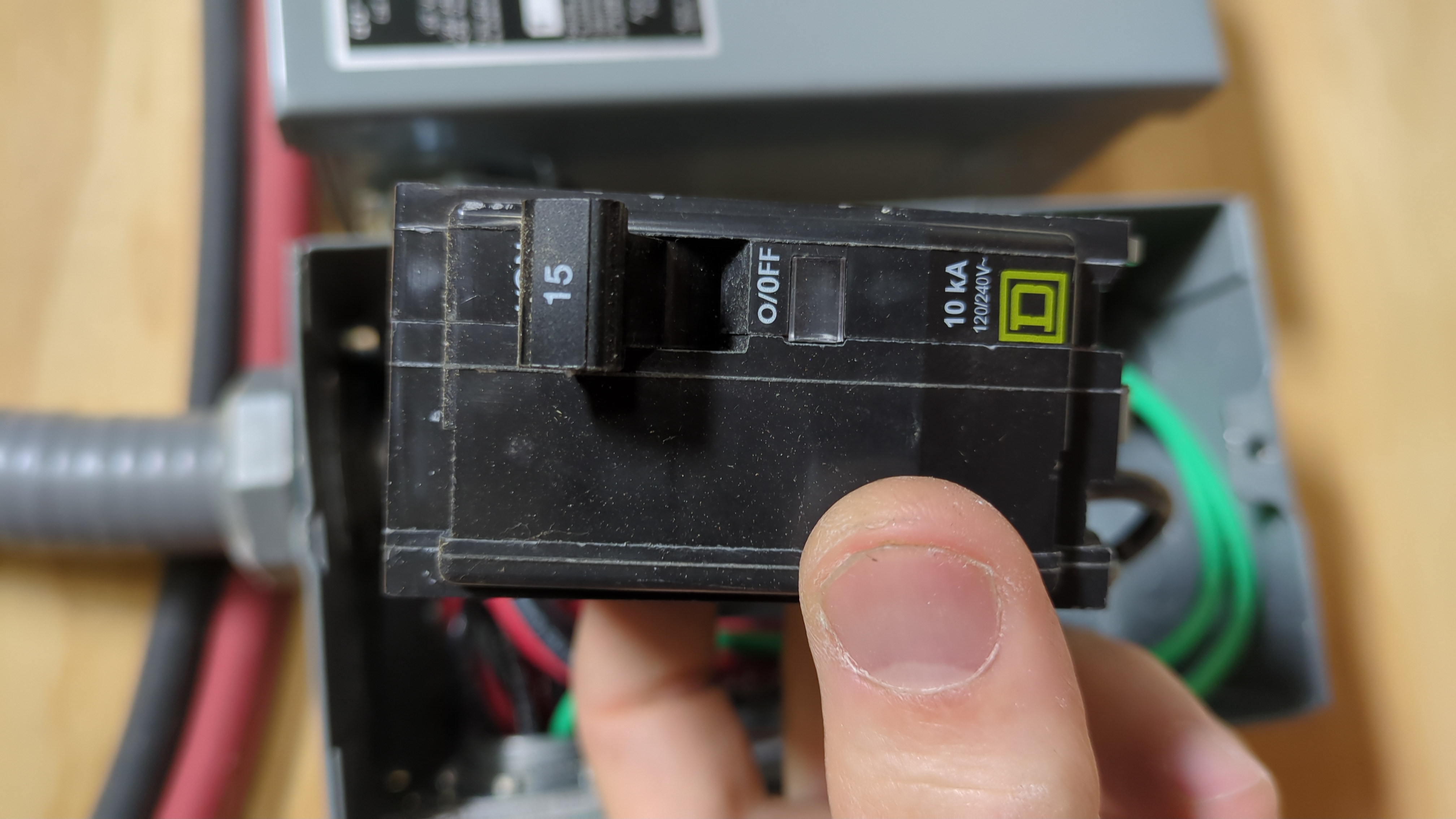

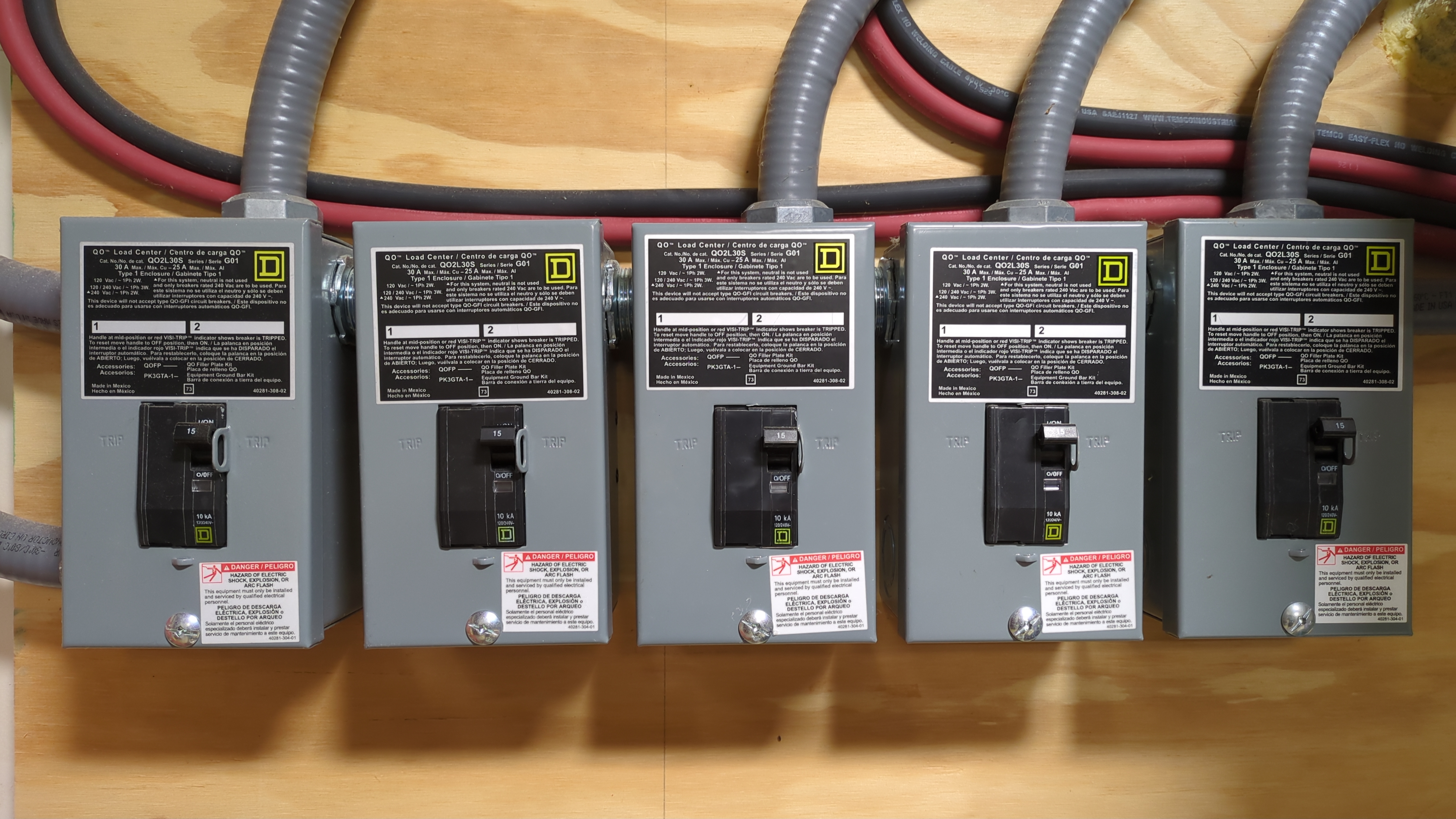

System was installed in my home by a solar company 3 effing years ago.
I did most of the design, they were responsible manly to go on the roof (5 PV strings), put the solar panel and bring the cables down.
I am from Europe and had not too much experience with US residential breakers.
They told me they will install PV disconnect switch. I was fine with that. They looked OK from far away okay, big (to sustain a VDC arc opening) and 15A.
PV spec needed: VDC 500V and 8ADC min, in each PV string.
Two days ago I got one of my worst "wait a minute moment", are those 15A split phase US residential AC breaker?
What do you think I should do? Yes I will forward this thread to them (if they are still in business)...

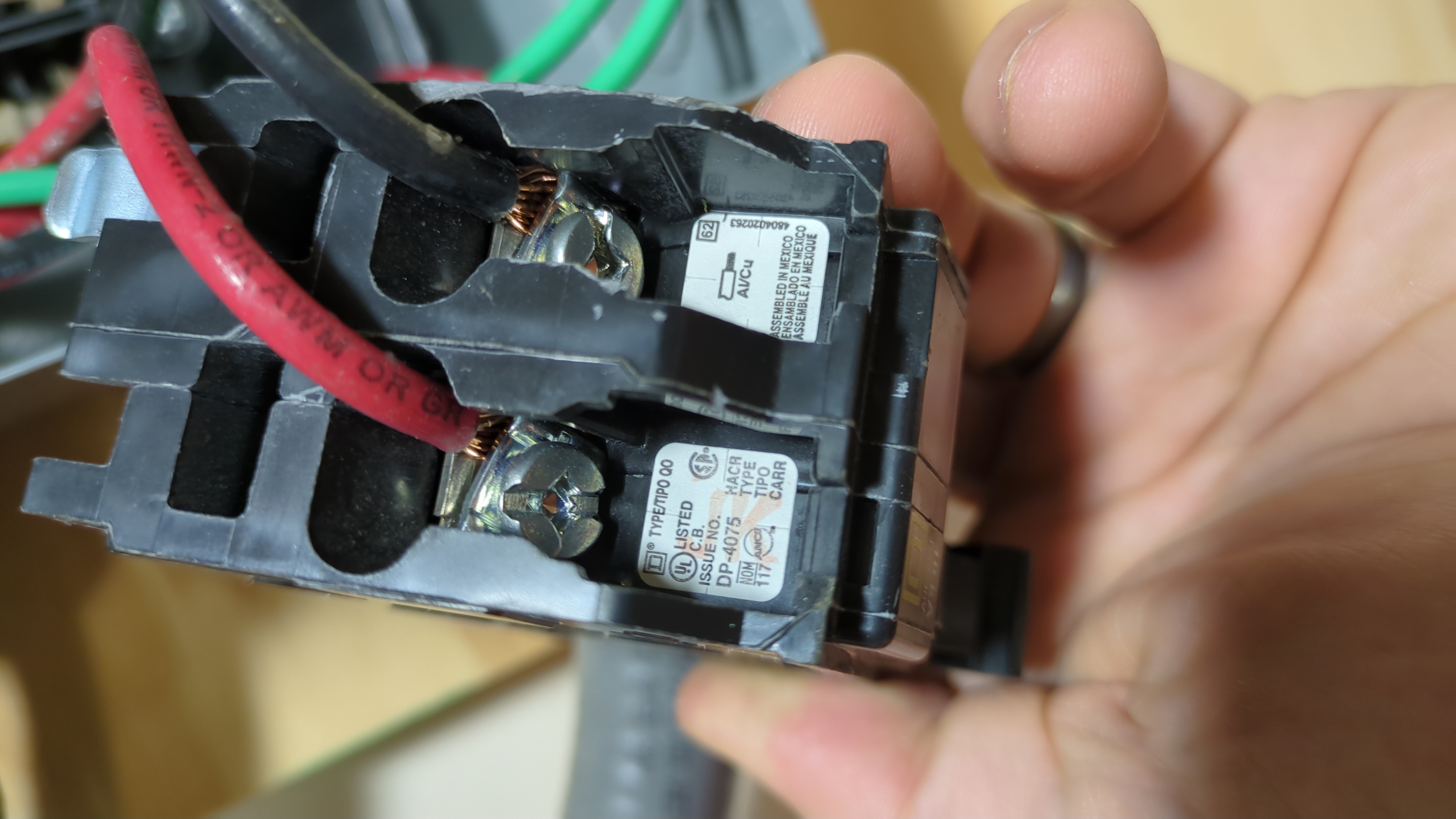

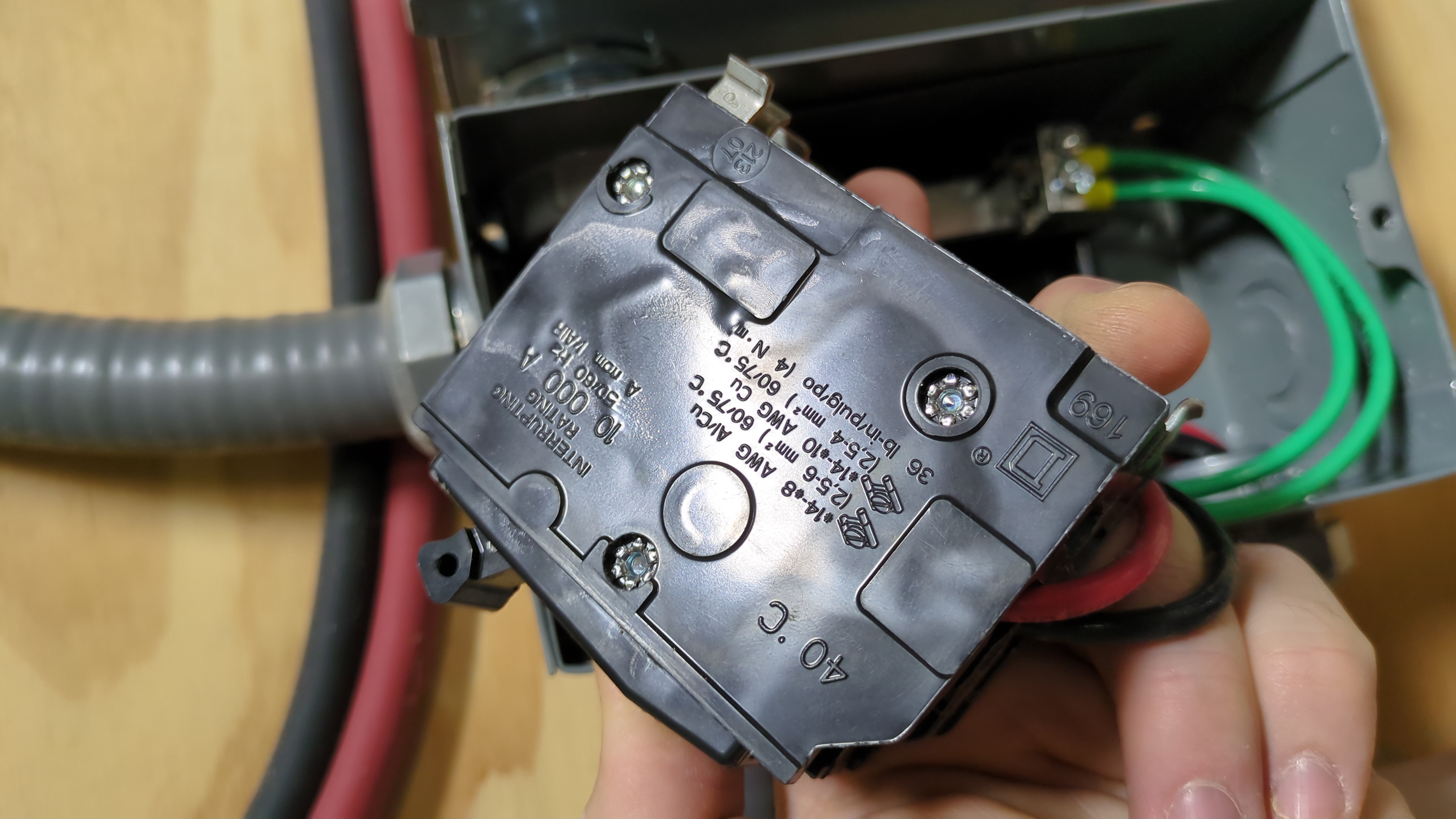

QO breakers are listed for DC up to 125V (if you buy the product with that label).  However, you are stating 500V.
Would have to install a J-frame for 500V applications.  Significantly larger and big bucks.
You might be better off going with fused disconnects.

Solar systems don't generally need DC breakers - under what condition is a series string going to produce an overcurrent fault?
Solar systems do need some point of DC isolation. Those are not it. DC rated rotary isolators are easily obtained, at least in the EU, and under no-load conditions (Turn the inverter off. You can do that via the AC isolator.) you can simply disconnect the panels directly.
Those, obviously, are not DC rated breakers or isolators. They'll probably stand off the OCV when open, but opening them under load might not work out.

The best option is to remove these breakers. If one trips under load, it could (very likely) arc over and start a fire. But realistically I don't see how a solar panel can generate more current than it's maximum spec. So having breakers on solar panels is moot. It can help to have DC GFIs though for safety reasons. For DC breakers: check if there isn't one in the inverter already. My Growatt inverter has both a DC breaker and GFI built in. Remember that having more stuff installed, more things can go wrong. Australia used to have the requirement of a DC switch but that backfired badly. Literally.

My gut says a 10kA AC breaker will be able to stop DC 500V limited to 8A without instantly failing, but that it will severely shorten the lifespan before catastrophic melting/failure/fire.  But I wouldn't what them in my house even if they could survive a few trips.

My gut says a 10kA AC breaker will be able to stop DC 500V limited to 8A without instantly failing, but that it will severely shorten the lifespan before catastrophic melting/failure/fire.  But I wouldn't what them in my house.
I've seen DC arc over at much lower voltages and currents. Switching DC is nasty. Check the DC derating graphs on relays for example.

Thanks for confirming that those can't be installed for DC disconnecting/isolation. Thinking who did that was a hired solar company makes me scream. How many many other customers are not aware about the risk of operating them when the sun is out?
As long you keep them close, I suppose there is no risk of smoking anything out.
Anyway let's fix this madness, DIN rail mount please.I was tempted by this
https://www.ebay.com/itm/114252077692
but it looks cheap scammy chinesium stuff. No bueno.
Lately I am more and more attracted by ABB products, so I got three OTDC16F4
https://new.abb.com/products/1SCA121461R1001/otdc16f4
Will report once I have them. Meanwhile I need to find a decent din rail enclosure, they are tall guys...

Solar installs are subject to permitting and inspection.  Did you pull a permit?  An inspector would have flagged this immediately.  If not, who is ultimately at fault?

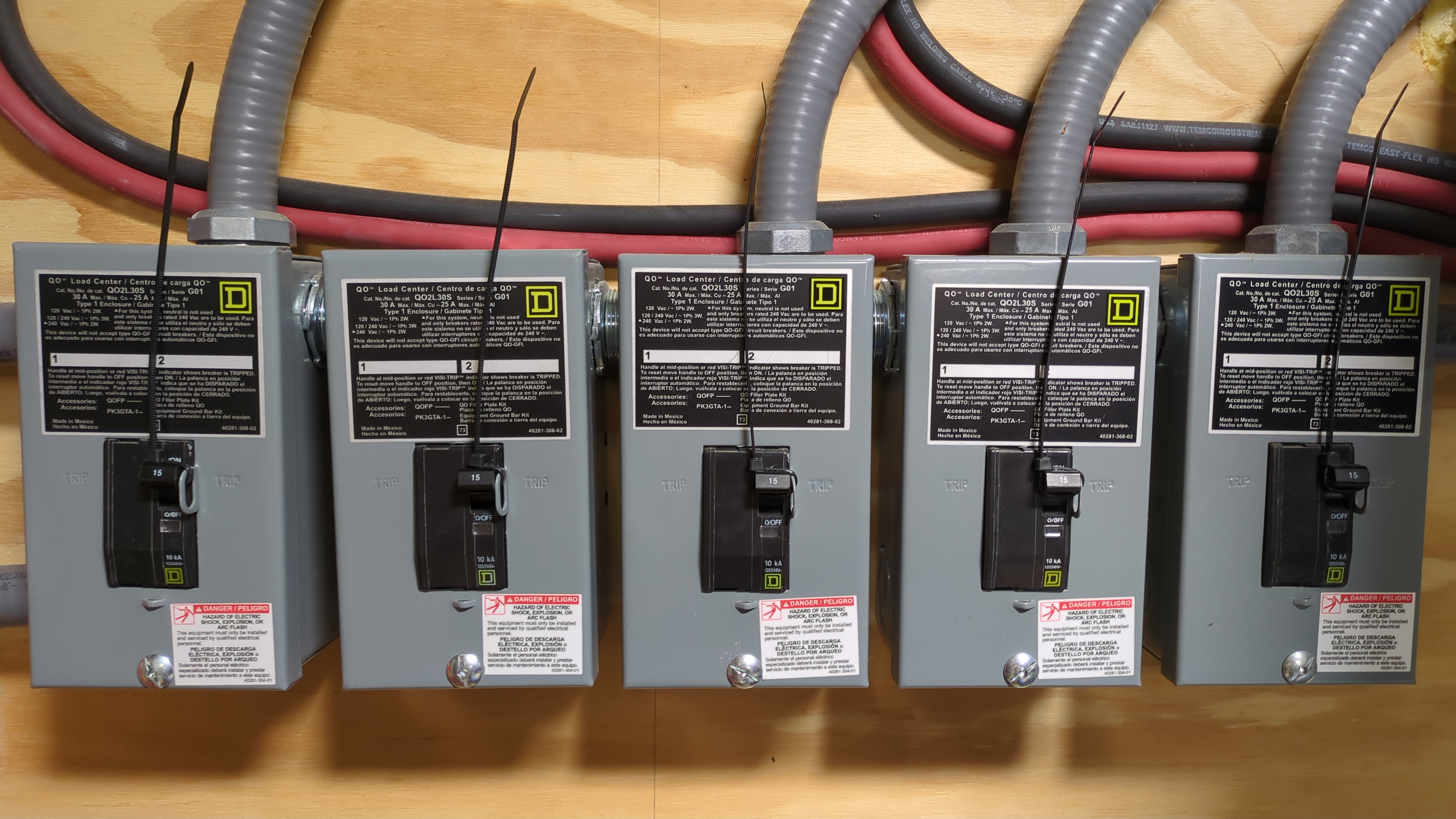

quick fix for now:
I still have no idea how thing works here in South Carolina. I had a gentleman agreement with the solar company, once I was done with my final touches (48VDC batteries) I would have informed them and they would have send out the inspector. I did notified them when the system was working but nobody showed up. Since I was feed up with them (I corrected myself some other flaws in the installations....) I did not follow up. Here the contract I signed:

Once I am done with my new transfer switch panel, I will make some calls to get the situation rectified.
