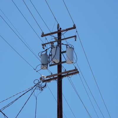

Thanks again everyone. I'd like to see how an uninsulated high voltage transmission cable look like. How to identify them at a glance? If anyone has any close picture, please feel free to post.
In the picture posted by themadhippy above, there is a transformer sitting on the cross bar with uninsulated wires descending to it at the top.
Uninsulated conductors can usually be recognized in two ways:
1. They will be supported by insulators and attached to insulated bushings where they terminate. Insulators are the zig-zaggy things made of porcelain, glass or plastic.
2. They will be surrounded everywhere by a big air gap, and will not be touching any other wires or structures.
You can usually tell high voltage cables because they will look "scary", but all electric cables should be considered dangerous, insulated or not. You can never tell if there might be a fault, or a weakness in the insulation, or an uninsulated section where a connection is made to a transformer.

In the picture below, the wires suspended far apart in free air are uninsulated, but the cables descending in the lower left corner are insulated because they are all touching.
