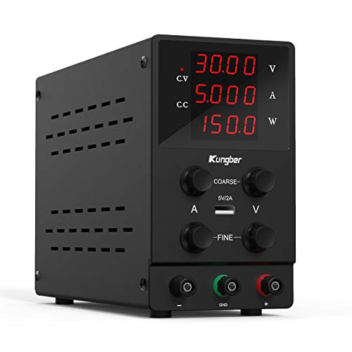

Hello All, I have a power supply similar to the one below. It is rated for 30 V, 10 Amps.
Can I blindly put 2 of these in parallel to get 20 Amps or is it a big NO - NO to do such a thing with such power supplies?
Thanx for the replies.

In general its a no, some power supplies *are* designed to do such a thing, but (in particular) some cheaper models have very sharp transitions between CV/CI modes and you end up with the two supplies oscillating and shifting the current back and forth.
You can add external series diodes if they don't have reverse current protection and adding a little resistance (enough to give approx 0.5V drop at max current) can help soften the CV/CI transition. But that obviously degrades the voltage regulation at the load quite heavily.
Maybe include the make/model in the subject to see if anyone has experience of those supplies directly.

By definition, you can definitely parallel CC/CV lab supplies, no problem.
If the supplies don't work doing that, it can only be because they are completely broken-by-design, and unsuitable for any work requiring CC/CV supply anyway.
I say this because cheap supplies in that form factor are notorious for being utter disasters. Not all, but many. Some, for example, will just blow up if voltage is connected to the output of the supply. This can happen if charging a battery, or connecting multiple supplies in parallel, or just having a device with enough capacitance connected and supply turned off. They are all normal use cases for a CC/CV lab supply.
Try it. There's nothing to lose. If they, for example, blow up, they would have blown up anyway. You can only hope they don't kill whatever circuits are connected by delivering higher voltage than configured.
I also suggest you fix the serious and confusing mislabeling of that unit by scraping off the "GND" text, replace with "PE".

A CC/CV supply does not need any "balancing resistance".
For CV supplies, wire resistance is seldom enough to help share current unless they are stupidly accurate.

No, diodes do not help anything with current sharing problems. If anything, they make things worse by having negative Vf temperature coeff: the one supplying more current heats up its diode, which in turn will increase its output voltage due to lowered Vf, supplying even more.
Diodes could save a supply that self-destructs when voltage higher than its own output (yet below the maximum rating, obviously) is injected externally. Although, if a certain supply dies from that, it's only matter of time when it happens anyway, for example when turning off the supply with capacitive load connected; better have it die sooner than later so that you can ask for money back and get rid of the broken supply.
Resistors can be used to improve current sharing at expense of load regulation, and they may also dampen oscillating control loops, so if you can afford the extra power loss, and loss of regulation, you can always add some resistance if you see problems.
