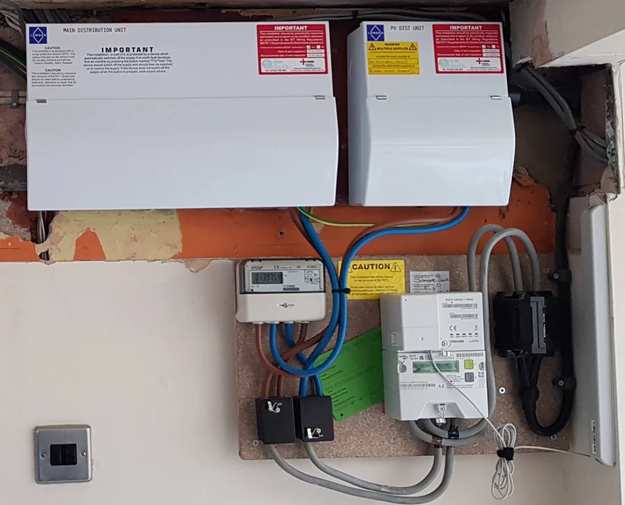

The meter is just visible at the centre left, and the two grey cables marked "3N" and "4L" are the metered outputs. These cables go up to the isolator with the red switch and then to the two consumer units so both consumer units are metered.
I was assuming the isolator of the right with the massive black cable was the "presentation point".  Is it the solar incomer?
To be clear this is a random photo I pulled off the internet to show how a second small CU is often connected via Henley blocks in the UK. In this photo incoming is on the left, you can just see the right hand edge of the service head in the bottom left hand corner of the photo (the bit with the exposed earth terminals) and the new CU is top right, with armored cable going from it to whatever it was added for. It may or may not be feeding solar, but this would be a very common way of doing things. As its a fuse and isolator it is more likely a submain to some outbuilding or extension than solar.
Here's another, this one is definitely solar: https://www.positech.co.uk/cliffsblog/wp-content/webp-express/webp-images/doc-root/cliffsblog/wp-content/uploads/2022/02/image-1.png.webp
And here's an example of a small modern consumer unit added in to a legacy install: https://i.sstatic.net/vssQL.jpg
None use IDC connectors. I am not especially against IDC, the DNOs (UK electricity network operators) use them and they're reliable for them so clearly are OK if done well.

Shouldn’t the wiring from the Henley blocks to the two distribution units be double-insulated? It’s basically an extension of the meter tails
Offline Monkeh
  • Posts: 8748
It is. Many modern tails have coloured sheaths.
