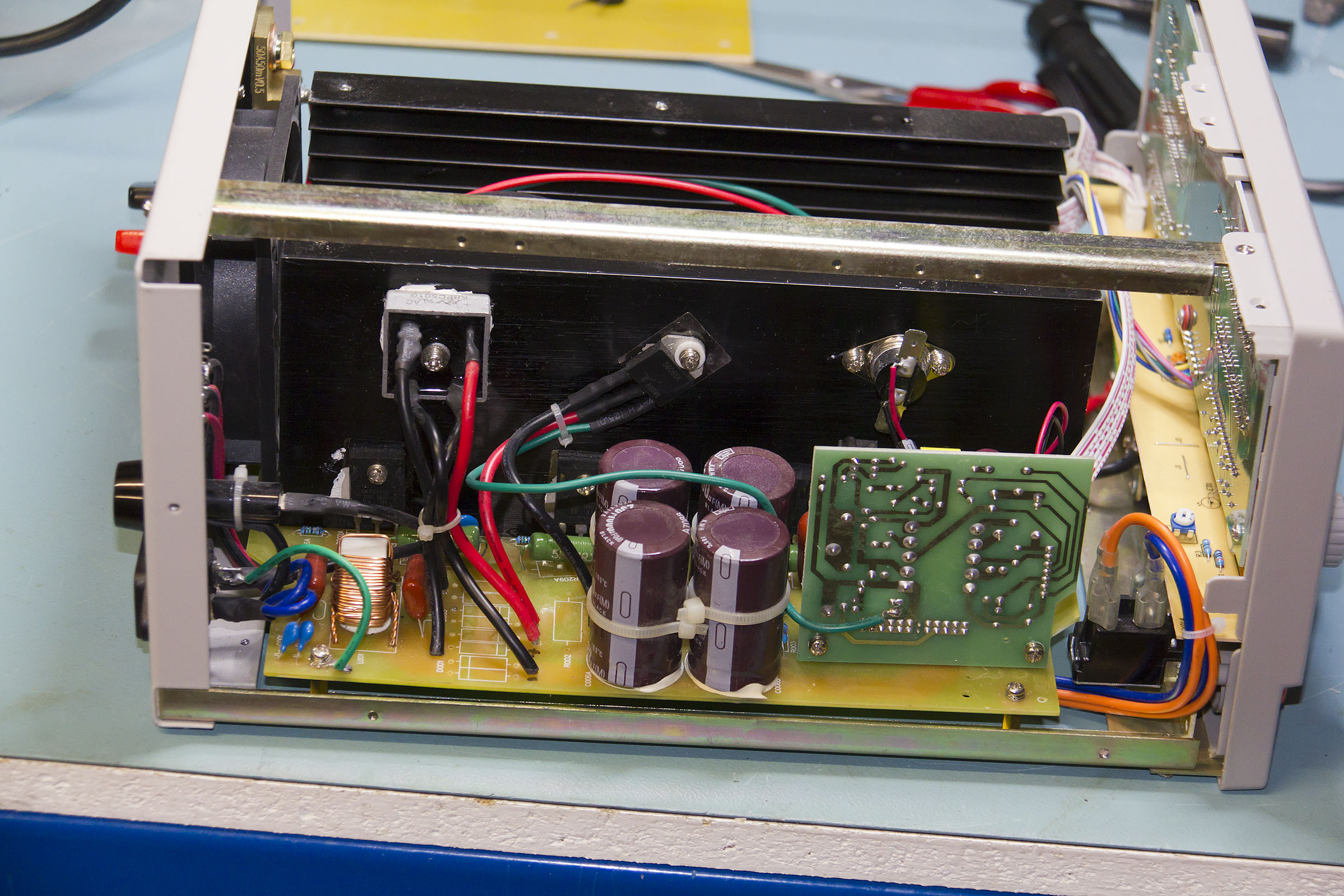

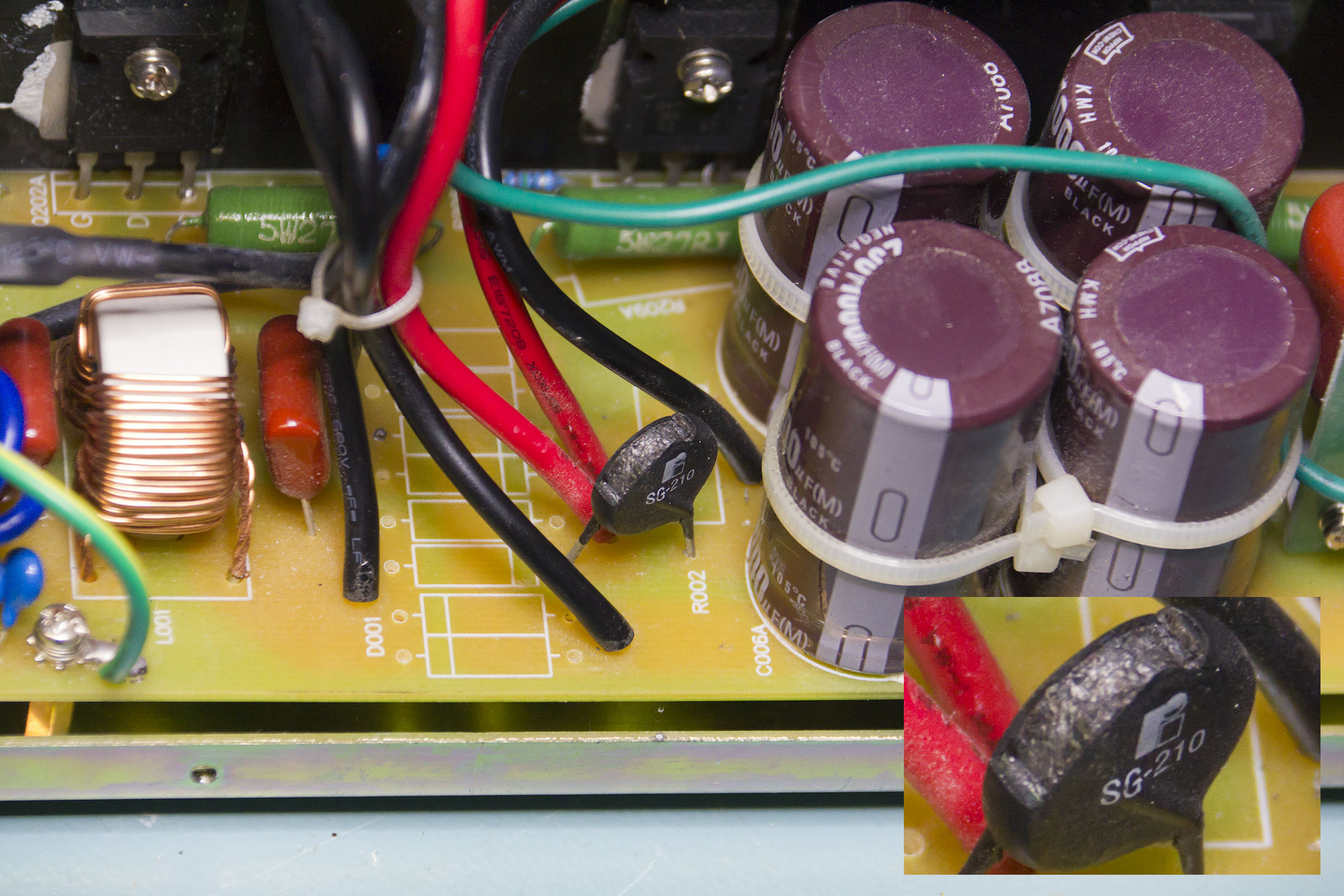

The fault was "blows mains fuse", actually that wasn't quite true as it took out the breaker when I tried it without touching the fuse at all - not surprisingly I found that two of the main switching IRG4PC50UD's are dead short and I was equally unsurprised to find this soft start thermistor has literally blown its lid.

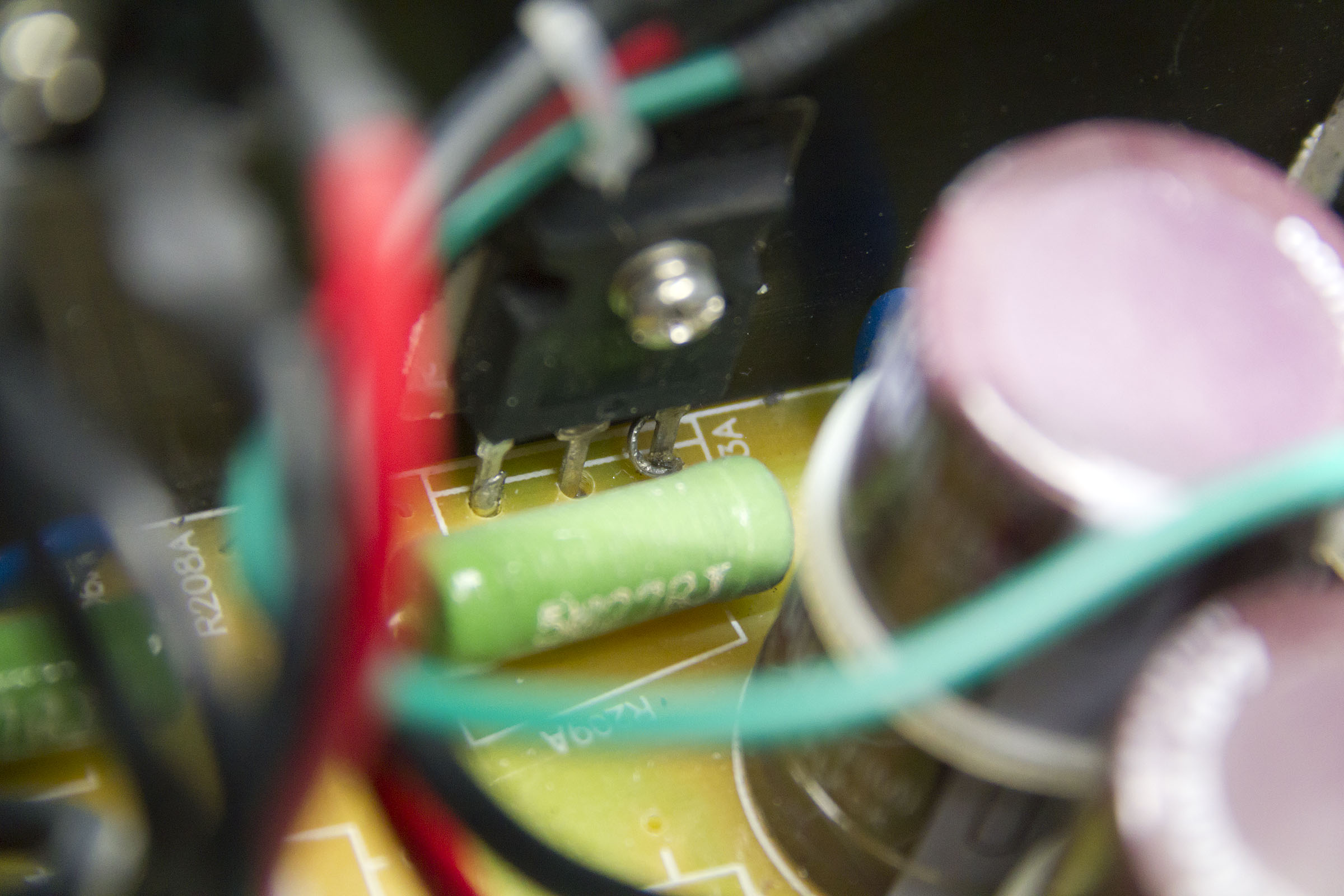

Something a bit odd is going on around the leg of this IGBT as well - not sure whether it has got hot enough to melt the solder or whether this is left over from manufacture.

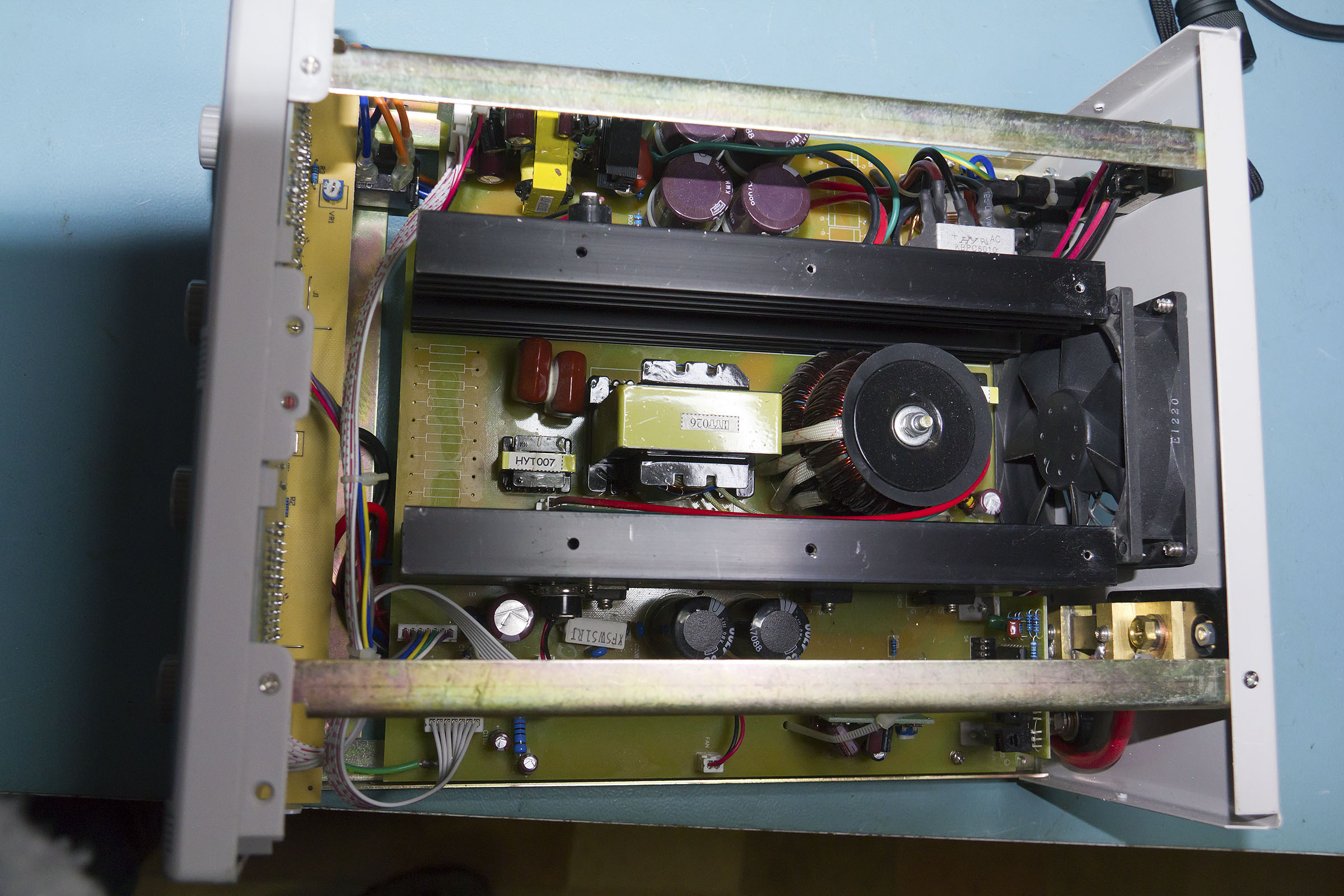

Overall construction is reasonable, primary side components are on one half, then heatsink and magnetics in the middle (where they can be cooled by the fan)
However there aren't any air gaps on the PCB to help isolate the high voltage stuff, probably not that much of a problem given that the main board isn't especially crowded and the overall design provides fairly good separation. I haven't checked that adequate creepage has been allowed everywhere though and I'm a little suspicious about the various daughter boards, eg the aux power supply board has the hight voltage DC on part of it, no slots on the PCB and then feeds low voltage DC into the control circuits.

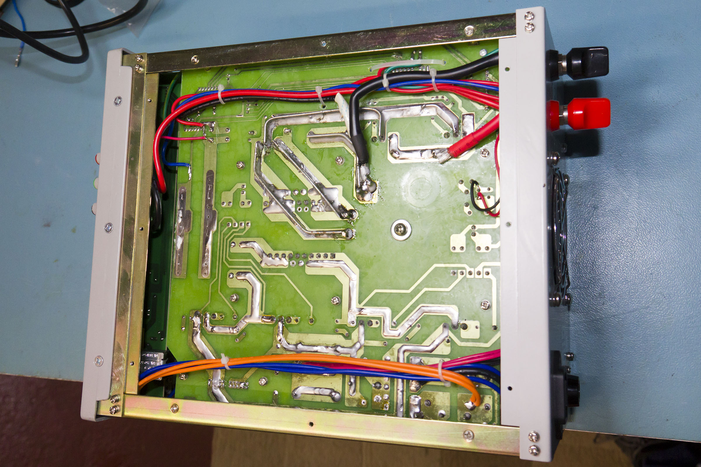

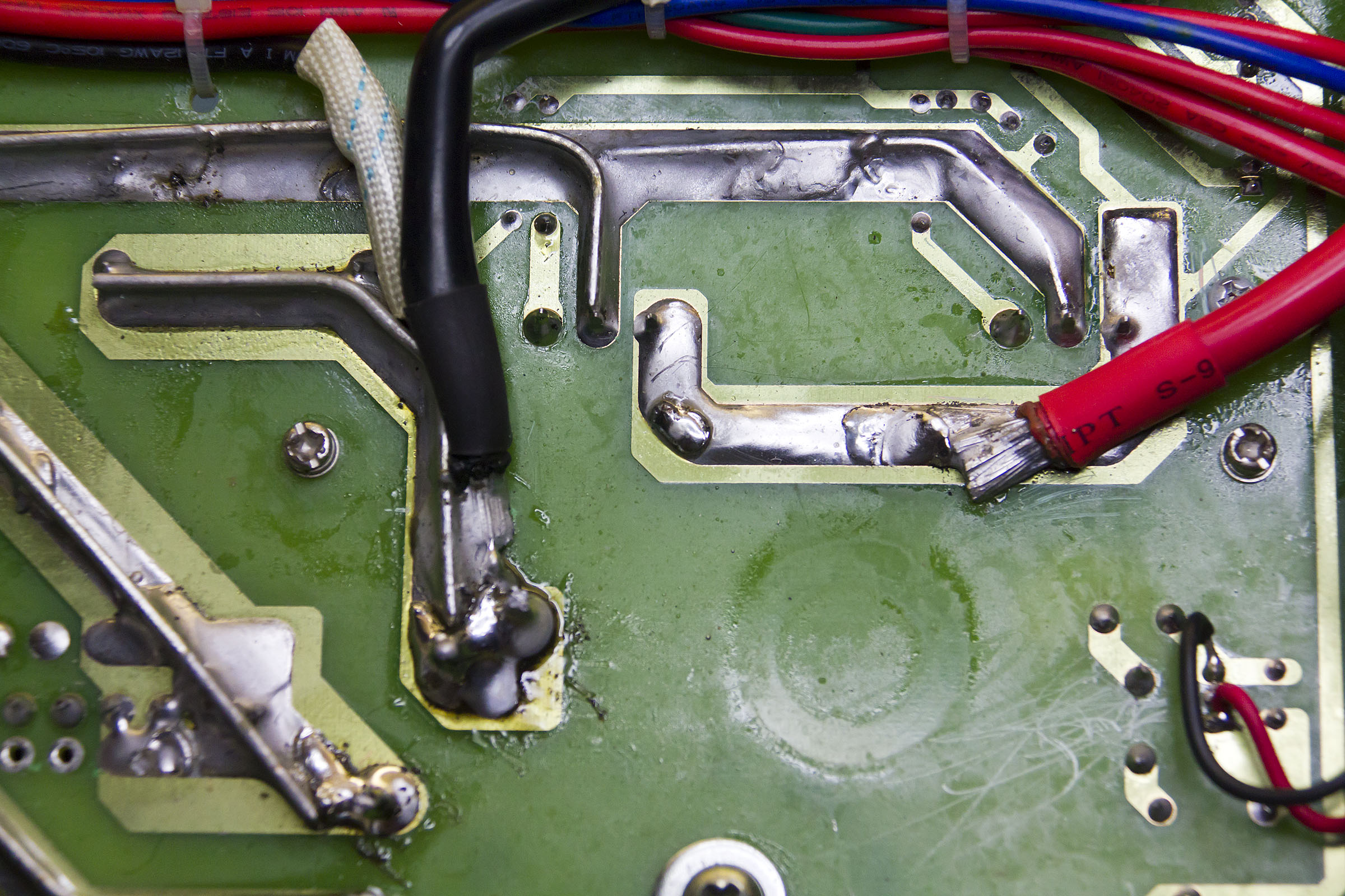

The high current paths are all heavily re-enforced so it should stand up to the max load of 40A with no problems - except, curiously, for the positive output (see photo below). Although this is connected by an 8 AWG cable (good for 75A or so) it isn't soldered all that well to the board, nor is this trace endowed with extra copper. The heavy 8AWG cables run to the terminals on the back, then lighter 12AWG cables run to the front binding posts. This really is another weakness of the design - whilst it's clear that you are supposed to connect high current loads to the rear binding posts there nothing limiting current from the front post as far as I can see - and more than enough capacity to melt the banana sockets  :scared:

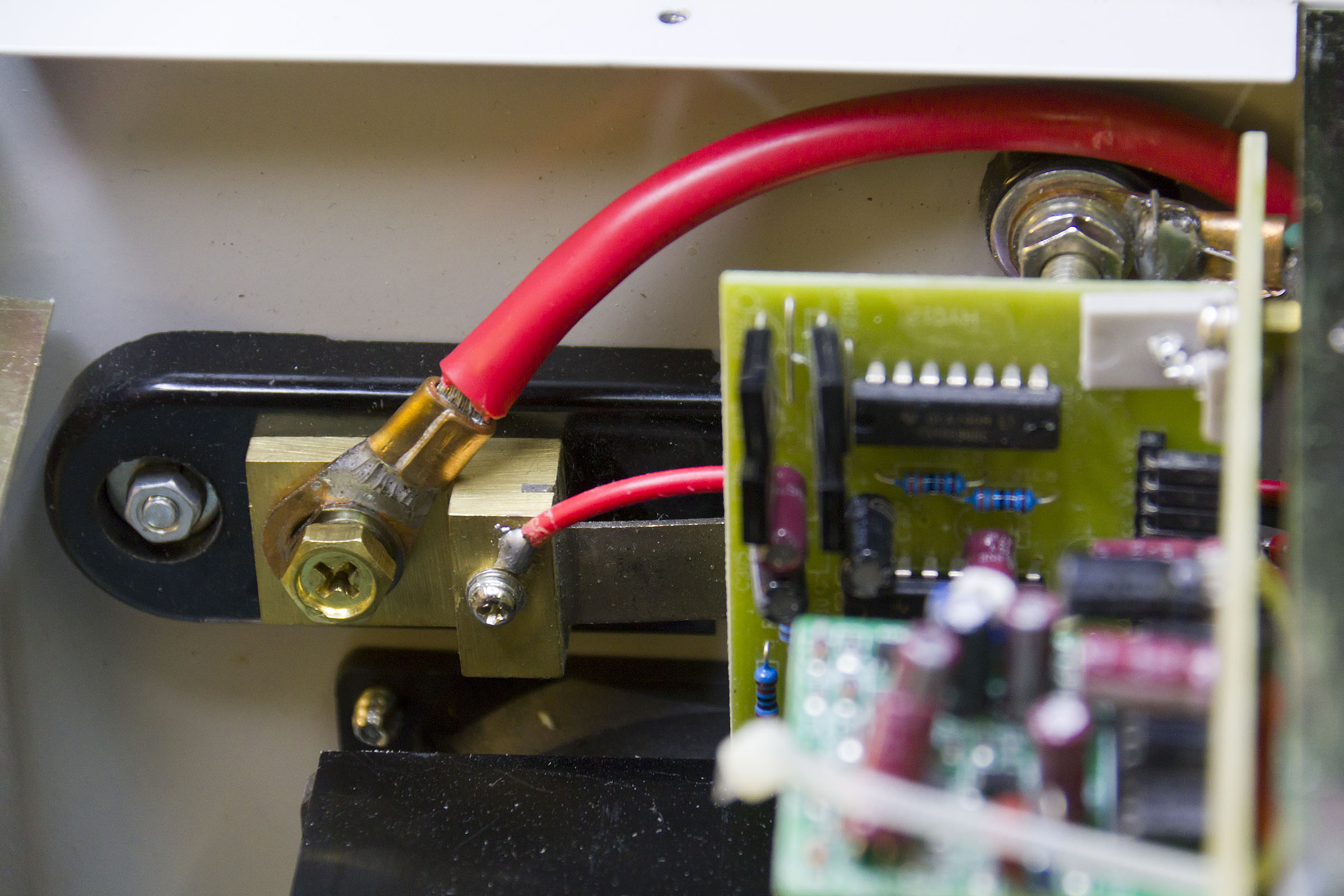

The meter current shunt looks the part though :)

One thing I don't understand is the function of the thyristor SCR001, especially as it is paralleled by quite a low value resistor. In fact this is an SG210 inrush suppressor in the unit I have although the schematic has 27ohms for the 5020 and 20 ohms for the 3040 (at least I think it's 20ohms, it says 10ohms x 2 but doesn't say whether series or parallel). This is supposed to have a cold resistance of 7ohms and a resistance at rated current of 0.2ohms.

The thyristor across the resistor is there to reduce power dissipation BTW, it just shorts out the resistor when the aux power supply is powered up, it is triggered by the aux switcher turning on and running after the caps are charged up and the TOP223 starts up after it does it's power on restart.

I presume you mean R207A/B, R209A/B, C206A/B and C207A/B - they seem fine although, now I look again,  one of the 27ohm resistors is blackened - the one by (I think) Q203B . Not sure whether it has been overheating itself or whether it was the IGBT adjacent to it. It still measures 27 ohms though. All the caps measure a fraction over 2.2nF (generally about 2.4 but the tolerance on those is going to be quite loose).

Thyristor across the NTC is to ensure that it stays cold after the supply is turned on, so that it is high resistance if it is turned off for a second or two then back on. Hot NTC means a blown fuse then.
Explained like that it almost makes sense - except I then start to wonder why bother with an NTC?
