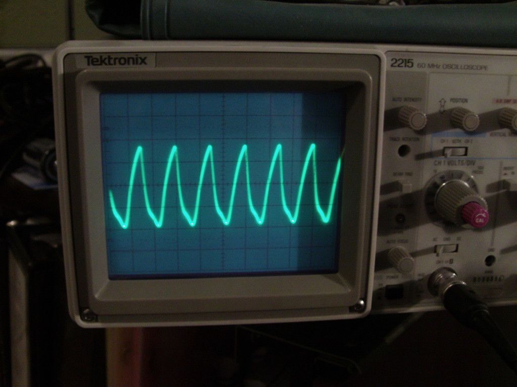

Then I measured the signals at the chip's outputs. One channel has around 0.2V oscillation, nothing alarming to me. But the other channel.... DAYUM! almost 2V p-p at around 400kHz  :wtf:. The waveform is a severely distorted triangle.
There's gotta be something going on. Components in the feedback loop checked OK. I suspect a loose or broken connection somewhere, but any feedback on this will be appreciated. Maybe it's a really stupid thing (it usually is xD).
EDIT: Never mind, I knew it was something really trivial. Turns out the wire closing the feedback loop broke, no wonder the gain went through the roof!  :-DD

These integrated bridge amplifiers can be very sensitive to PCB layout, the grounding in particular.  If your pre-ground and power ground are daisy-chained on your protoboard that would probably be enough to cause oscillation.  As a first attempt try attaching your PSU 0v connection to the other end of the daisy chain, or preferably re-wire the board so that the grounds are star pointed (even better, use a PCB with a chunky ground plane).

Both the power supply and the input signal generate their own noise. Although now that I found the issue and took care of it, the chip works just fine, and I'm not even sure I can hear the remaining distortion at high power. But even then, it would top at less than 30W with the 32V 940mA power supply I'm using. I could push it to 40W if I wanted to  :o
Looking back at the datasheet, the connection that broke was a capacitor tied to the feedback loop, with the addition of a 470 ohm resistor I added to attenuate the gain as suggested. I assume the capacitor is there to filter this high frequency noise that would otherwise cause oscillation as you mentioned.
It doesn't seem to mind having the pre and power grounds connected together. But I did connect the speakers and power grounds the closest to the power supply. That's what common sense tells me to do LOL.
