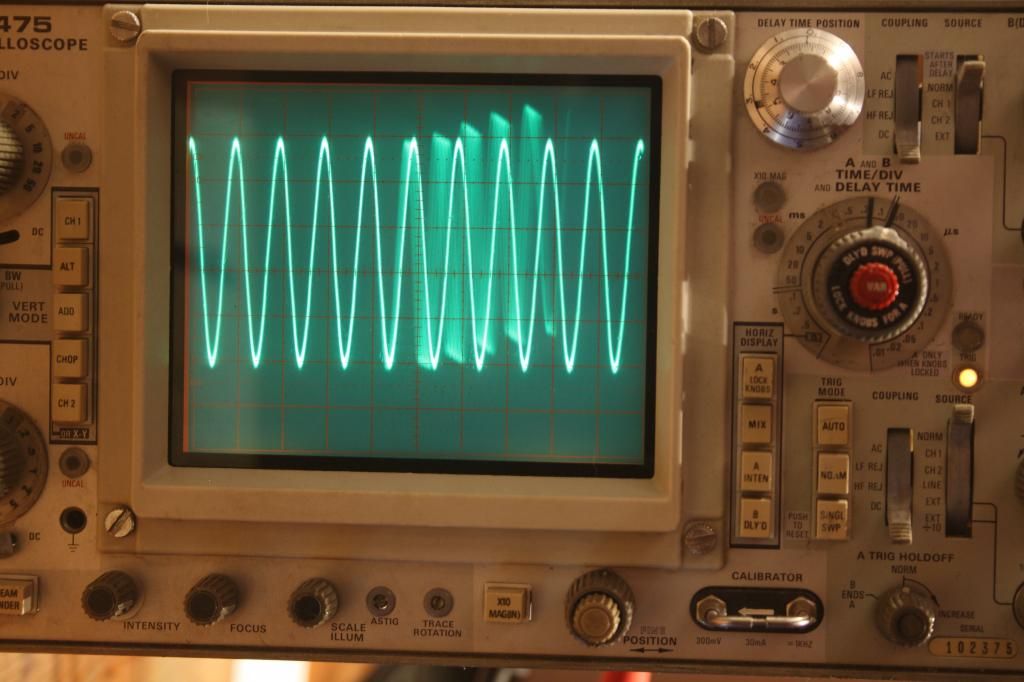

Had this scope for a while, but I haven't used it until I wanted to check a function generator.
After an hour or so the screen went crazy, like the input was being dragged around by low freq signal.
I measured PSU before and after fault condition:
The -15 is a little low at 14.779
More tellingly the +5 is at 4.985v when running, but drops to 4.135Vdc during fault and I was able to measure 1.0768VAC on there too.
I read a few of the threads, and the bridge and filter cap are a big suspect in this fault, with a bridge fault producing weird things on the CRT.
Here's a pic of the screen when faulty (apologies if I cock the size of the pic up):

It kind of looks like the MIX button is depressed, and "NORM" mode triggering. Does it only do it in those modes, or in "A", and "CH1" trigger source as well? All sweep speeds, all input signal frequencies, and amplitudes, and what about a free run un-triggered, but slowed with VAR sweep knob? What about free run with no Vert input/triggering? Can you see any of that added jittery signal in the various sweep speeds then?

Just another remote possibilty here...  by chance do you hear any slight arcing sounds, or a faint smell of ozone? That also reminds me of time I have seen that cause a distorted look to the waveform such as that. Will be curious to know if you see any of that disturbance without an input signal in AUTO free run.

Well I had another look and things are not so good.
This time I could get not trace at all, nothing from beam finder (could see the screen flicker as the scope is turned on).
The 5 volt line was behaving, but the -15 was at -21volt.
I had to stop looking (life's responsibilities calling), but I did notice quite a lot of rework has been done to the scope in the past. IE components tacked ontop of the remaining legs from old cut-out components, pads missing (including at least one from a big PSU res cap).

When you jump back in it, take a look at these components in the 15 V reg ckt. they would be most likely, but if not, you'll need to troubleshoot more. That dirty signal you had on the screen might have been a short starting to breakdown one of those parts. Hopefully your +15 circuit throughout the scope is still good!!!
