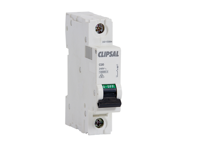

Not sure how to interpret "vaporising pieces of wire". The group fuse is a porcelain diazed D type or at least used to be. I have now replaced it with an automatic fuse into the Diazed socket. I guess that automatic fuses are a bi-metal construction that breaks the circuit as it "overheats" due to the too high amperage. I take it to understand that the above mentioned abbreviations mean; MOV = Metal Oxide Varistor, GDT = Gas Discharge Tube, UVLO = Undervoltage Lockout.
The shorted part of the system is a 230V outdoor surveillance camera together with a couple of NIR lights. I have put all high-voltage cams behind what I believe are 2 ampere fuses. They look similar to this:
but with a pink flap instead of black. I think the pink color is color code for 2A (like 4A = brown, 6A = green, 10A = red, 16A = gray, 20A=blue, 25A=yellow, 35A=black) as is the same system as for Diazed fuses (https://en.wikipedia.org/wiki/IEC_60269). Perhaps they are circuit breakers, I thought that they were ordinary fuses. All I've seen is that there are slow fuses and fast fuses, never thought of the existence of such circuit breakers as DIN-modules.
What I mean with "intermittent" is that during testing I got it to work at the beginning when I started the troubleshooting. I kept it running for a while normally with the UPS on. Then when I disconnected the UPS and connected it directly to the mains power, the 2A fuse/breaker tripped and the group fuse (which is also slow) was blown to boot. As long as I didn't reset that 2A fuse/breaker, the group fuse didn't blow.
