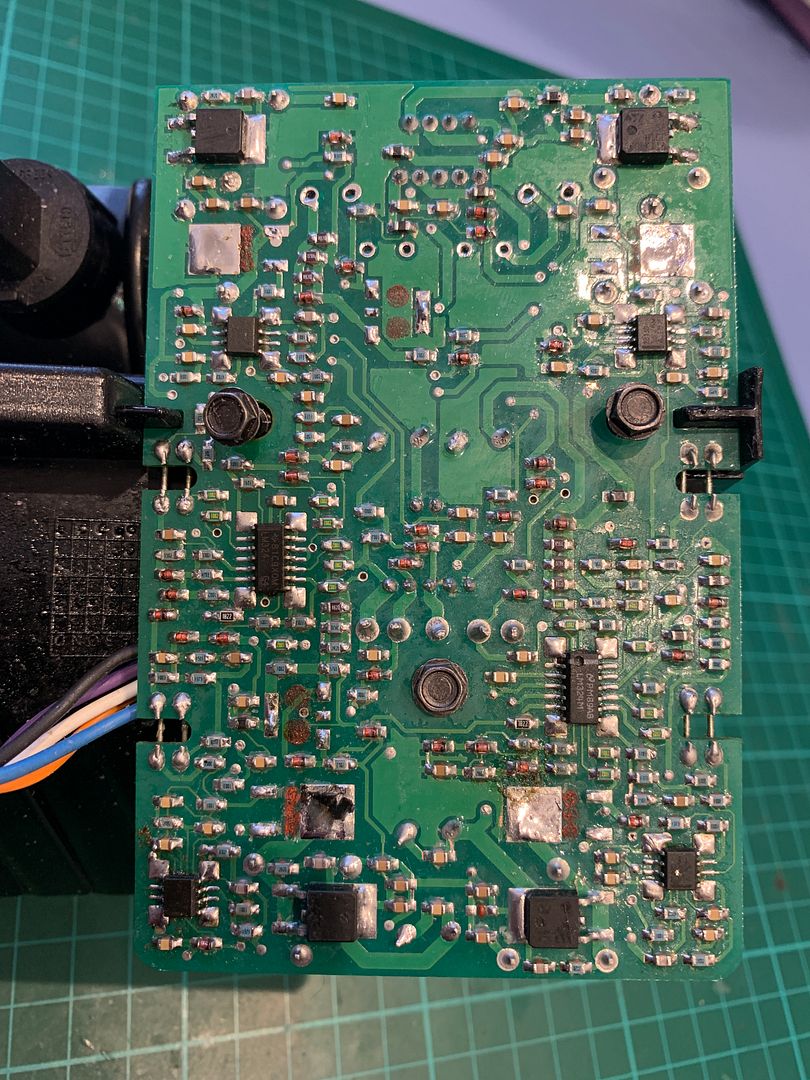

I was given by my uncle he DB9 rear light and asked if I can repair it. Given I have repaired a few automotive board, one being my body control ecu on my Alfa, I thought yea ok no worries. It’s only an LED driver board, how hard can it be..!!
My bad..!!!
Pictures are below for reference.
I will try and describe the best I can to help understand the issue.
The top part of the light has two sets of leds. One long set and one short set. The short set AND long set come on when the lights are on. But only had say 50% brightness.
You can see that’s it’s being pulse width modulated when you record it and play it back. Also given the ic’s being used inside but I will go more into that later.
Then when the brake light it pushed while the lights are on the short strip lights up full brightness while leaving the long strip at 50% brightness.
I know this from watching the other working light on his car.
Now there are 5 wires on the back of the controller.
1. Neg
2. Brake
3. Lights
4. Indicators
5. Fog light.
Now I’ve checked the voltage going to the connector when plugged into the car and each input is just seeing a strait 12v. And nothing comes up on the dash as a fault light to say the lights are out. Eliminating the possibility that it’s canbus controlled.
The issue with these lights are when you put 12v to the light on brake nothing happens. Just draws 67ma. If I put 12v on the lights input the brake part lights up dimly and flickers badly. But the other part does not light up as it should.
I have replaced the 4x ti ucc2813d-3
Also replaced 2x st mc33079dt
I have reflowed all components, checked all
Mosfets and diodes, capacitors.
But can not find any dodgy components anywhere. Used the microscope to check the tracks. Even tested most of them for continuity.
Spent over 10 hours on this now. And begining to runout of ideas on what to test not.
I’ve read the data sheet on the ucc2813d-3 which is very full on. And understand it to a degree. Checked all supporting components and their values and all ok. But the ucc2813d-3 will not put out and pwm signal to the mosfets that drive the leds. The data sheet is limited on what to check. This is where I’m up to. Trying to find out why it’s not outputting a pwm to the driver mosfets. Is the ucc2813d-3 in a fault condition? How do I tell?
Any help would be much appreciated.
Cheers. Steve

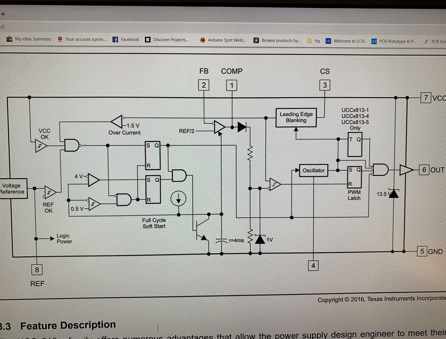

ISTM that the UCC2813 PWM controllers are operating in open loop mode with the FB pin as the control pin. That is, the chip outputs a PWM signal with a duty cycle determined by the DC voltage on its FB pin. If the voltage at FB is less than REF/2 (Vref = 4V), then the output is switched off.
I would determine which chip is driving the FB pin and work backwards from there.
http://www.ti.com/lit/ds/symlink/ucc2813-0.pdf
https://www.st.com/resource/en/datasheet/mc33079.pdf
I'm assuming that you have used an LM324 as a substitute for the MC33079.

your last picture shows a corroded PCB, the one you attached shows an immacutale board, I'm confused.
Did the light suffered any water ingress?

thanks for your reply. ive read the data sheet and  you are correct abount the feedback pin. however, ive checked the voltage on that pin and it is at the voltage required. (4v) im going to check tonight with my scope wether there is even a hint of a pwm signal before possibly shutting down. as it states in the data sheet that it can entor into an error state and not put out a pwm signal, but cant work out what can cause this error state apart from there being no feedback voltage.
i used the lm324 as a temp substitute just to see if it would have any effect showing the mc33079 was faulty, but was not the case. although i did order some new ones and replaced them.
You need to get your hands on the known working board and with a scope point to point check back and forth.
Did you check with a scope or a DMM in AC?
hi zucca.
where is it corrodded? this board was conformaly coated, so no water has been on it, although the connector was slightly corroded where the leds plug onto the board, only because this was the only part of the board not covered in conformal coating.
If you mean those red looking splodges thats the glue used to hold the components inplace before being wave soldered.
Ah ok, got it. Well, comparing with the good board it's the easiest thing.

If you are measuring 4V at the FB pin, then I must be wrong about my open loop hypothesis. The 4 transformers (chokes) must then be the inductive elements in 4 switchmode regulators.

I scoped the inputs to the mosfets last night to see if I could see switching on briefly then shutting down. Possibly to an error. As I was right. I did a single capture of it and could see it kicking in with a pwm signal but then shuts down. Was measuring 10.8khz but the period it was on for varied. Found it hard to measure as my memory depth on my crappy owon usb scoop is just rubbish.
More poking and probing needed tonight.
As for the grounding points, this was next on my list. Even though I have check many things multiple times. I’ve not gone and checked all ground points yet.
If I could understand how the 2813d-3 works better I think it would help me fault find.

ISTM that it would be worth the time to trace the circuit around one of the four outputs.
