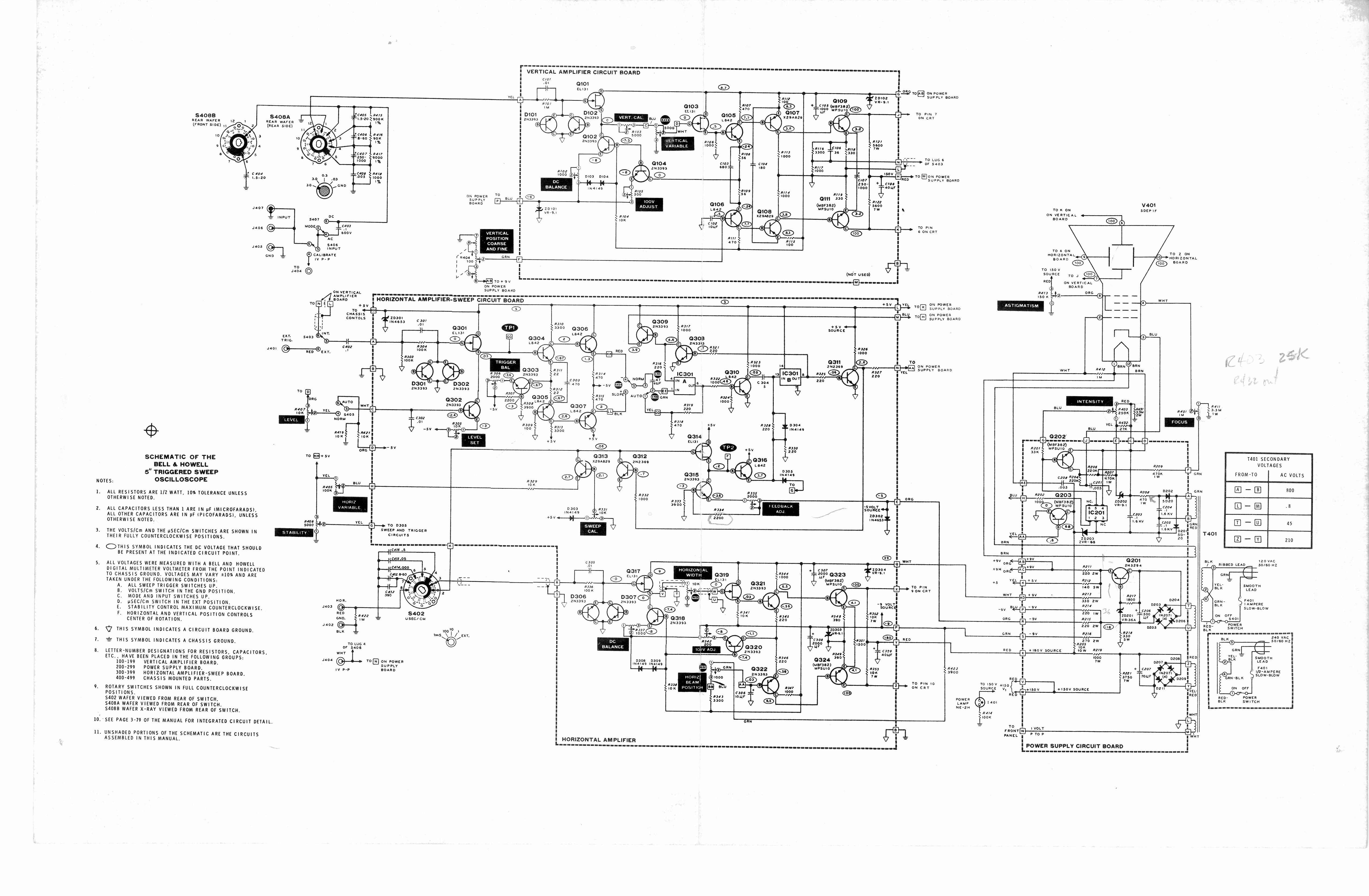

I am taking at look at an old Bell & Howell School oscilloscope marked as "Solid State Oscilloscope Triggered Sweep 5MHz Bandwidth" it is the blue one that is a little taller than it is wide.
Also known as:
Heath Model # 100-203-31
Bell & Howell # Model 9560-1
5 Inch Triggered Sweep Oscilloscope
Some docs here. I plan on assembling those into a PDF:
www.bunkerofdoom.com/lit/bellandhowell/index.html
Here is the PDF... The owner of Bunkerofdoom said to make it into a PDF was OK with him.
http://meanmutha.com/BellHowellScopeManual.pdf
Will post pics tomorrow.
I got it generally up and running. Was way out of cal and you couldn't find a trace at all. But I went through the cal procedures and it is generally OK now.
I am having an odd issue, though. When I set the horizontal division (uSec/cm) to 1 (the lowest setting) I am unable to trigger on a signal from about 80-120kHz. It will not get a stable trace even if you turn up the Stability control (need to research exactly what that is, as I am used to Tek scopes, which have no such control). I will not trigger with internal or external triggers in that frequency range. But only if the horizontal is set to 1uSec/cm.
I tried two function gens, and with and without termination. I tried sine, square and triangle waves. It just won't get a good trigger.
My wild guess is this is some ripple on the power supply. I am seeing a fair amount when measuring with an AC meter. I had around 1V on one rail, and half a volt on the other, etc.  I think I should replace the old electrolytic caps, and measure any resistors I can (lots of carbon composition).
Does anyone have a working one of these scopes? Would love to get some measurements. The docs have some voltage measurements, but no ripple tolerances like a Tek manual (professional tools vs. something you build in school).
Interesting little scope, really. It was a kit to be built by students and then used. They do this after they build their own Bell & Howell Nixie tube meter (got that in the sale too!). Both kits are made by Heath. I was planning on giving this to a friend who is new to scopes if I can get it going.
Thanks. Any info is appreciated.

Take a look at this part of the PSU:
http://www.bunkerofdoom.com/lit/bellandhowell/122.jpg
From the description there is only one voltage that you need to check for ripple: 31V.
All other 6 low voltages are supplied from this 31V via dropper resistors.  :-DD
You'd expect the ripple on the 31V to be less than 100mV IMO.
The other voltages supplied are listed as 180 & 150V, both unregulated.

Some more info:
Across emitter of Q201 to the anode of ZD201 I see 3.5 mV RMS of ripple. Doesn't seem like a ton? No?
If you look at the voltage measurement diagram for the power supply. I get <1mV from ground to AD, but ~310mV RMS from ground to the test point labelled AC.
~2mV RMS at the top of R214 as indicated as -18V
<1mV on K, R, and S to ground
The voltages are a little off, though (I doubt too far):
K = 4.596V
P = -8.37V
R = -4.539V
S = -8.88V
R214 = -18.05V
AC = 9.40V
AD = 8.94V
Q203e = 0V
Q203b = 0.206V
Q203c = 53.9V
V = 156.9V
X = 214.9V
« Last Edit: October 14, 2015, 07:35:54 pm by FlyingHacker »
--73

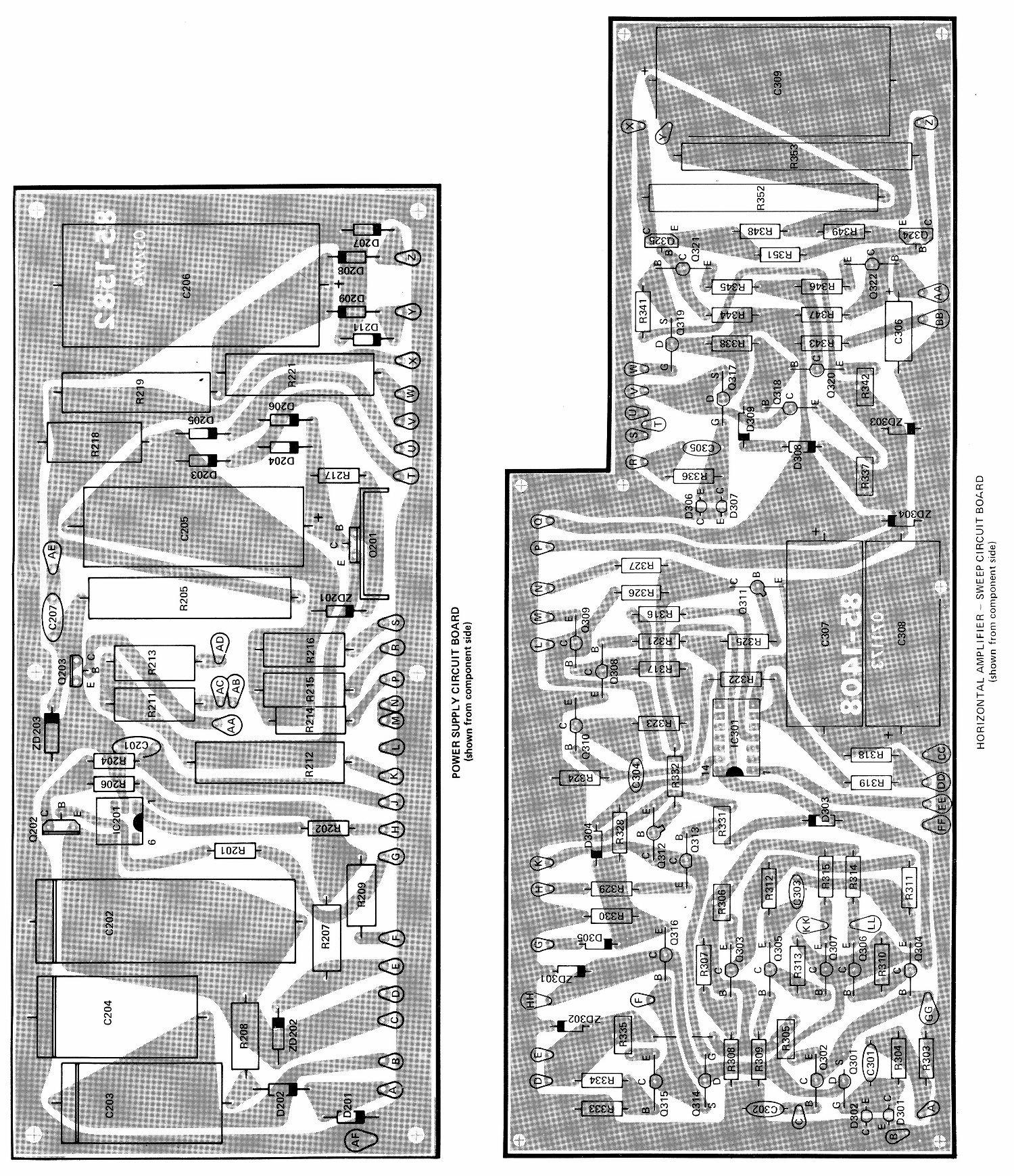

« Reply #5 on: October 14, 2015, 06:29:41 pm »
If there is significant ripple on the PSU it will affect all operation of the scope.
Back to basics, get the PSU right first.
Check all main 'lytics even those used for local bulk capacitance.
http://www.bunkerofdoom.com/lit/bellandhowell/4bellandhowellscope.jpg
Eg. C307 on the 9V rail

I put this on an isolation transformer and hooked up my four channel Tek 2465. Here is a photo of the waveforms.
From bottom to top the waveforms are (vertical scales not consistent):
Q316e
Q310c
Q308b
Q203b (over on power supply)
Photo one is with it working correctly, with a signal of 150kHz. If I then adjust the frequency generator to 146kHz the waveforms stay the same, even though the waveform on the scope under test goes away.
So it looks like the trigger is still working correctly, but perhaps the blanking circuit is in error for some reason.
The second photo shows the waveforms if I adjust the Stability control upward more until I get an image on the scope under test (but it is not properly triggered).
What is interesting is that I can turn the Stabilty downward and see it lose trigger completely.
To phrase another way, with 150kHz (working frequency) as I increase Stability from nothing  upwards I see first no trigger and no waveform, then trigger on the Tek and the proper waveform on the scope under test, and then the improperly triggered waveform on the Tek (photo two) and an improperly triggered waveform on the scope under test.
With 146kHz (failing frequency) as I increase Stability from nothing upwards I see first no trigger and no waveform on the scope under test, then the triggered waveforms on the Tek (first photo) but *still no wave* on the scope under test, finally I see the improperly triggered waveform on the Tek (photo two) and the improperly triggered waveform on the scope under test.
So it almost seems like the blanking circuit. I need to examine it further. Note that the collector of Q203 looks fine, I was just probing it on channel 4 of the Tek, which has limited vertical range, so I went with the base of Q203 instead.

As per above I *think* I have established that the issue is not in the trigger. The trigger waveforms on the Tek remain the same when I adjust the frequency (they change in frequency as well of course). However the wave disappears from the scope under test. When adjusting the frequency through the cutoff region I hear a slight buzzing from the neighborhood of IC201 or Q202. It is hard to pinpoint, and both of those are at very high voltage so I can't get too close.
I wish I had a HV scope probe  :palm: luckily I have been able to check them for a moment wit the Fluke 87, which won't read over 1000V, but at least doesn't blow up. I do this before I touch the scope probe to anything  :-+
So, here are some other measurements...
The waveform on Q309e, as well as IC201 pin 1 do not change when the wave goes off the scope under test.
Collector of Q308 looks good, amplified version of the base. Also no change when the scope under test stops showing the wave.

Check the crt circuit, that's where INTENSITY and FOCUS are. Check for cracked solder joints.
Thanks for the input. I think the problem almost has to be in the CRT circuit.
But what would cause the intensity to vary based on the input frequency? Doesn't sound like a solder issue, or am I missing something? Maybe the audible whine I hear could wiggle a solder joint or something?
I will take a look at the board. If I don't see anything I will pull and test Q202 with a meter as a start.
Thanks.

I'll post some lore info about why I am asking this soon, but can somebody else please compare D306 andD307 on the schematic (transistors used has diodes for a limiter, I think) with the solder mask on the circuit board shown here http://www.bunkerofdoom.com/lit/bellandhowell/371b.jpg
Those transistors look like they do not match the schematic. Thoughts? Are they supposed to be a limiter?
UPDATE: Ack! My stupidity... Although D305 and D306 are transistors being used as diodes I was looking at Q306 and Q307!
So ignore that.

So the CRT circuit and HV side turned out to be a red herring (I did find Q202 was poorly soldered, and cleaned that up)...
When I previously checked the horizontal side I had only checked the trigger, not the horizontal deflection. Turns out the horizontal deflection (collectors of Q323 and Q324) also change waveforms when the trace goes away! They get a flat line at the head of each sawtooth (or could be tail, not sure what I was triggering off of). The point is that I guess the beam is offscreen long enough that you can't see the trace (or the timing gets out of phase with the blanking).
Anyway, I started tracing the changing waveform backwards through the circuit (looking for anyplace where the change of the input frequency causes the waveform to jump). Since it was the same on both Q323 and Q324 I figured it had to be someplace that affected both circuits.
I have attached some more scope screenshots from another scope.
For all of these photos the top trace is the left hand input (schematic-wise) of R336. I am triggered off of this with a hold off since the other waveform is longer.
The bottom trace in these two images is measured at the emitter of Q306 (labeled D306) UPDATE: NO, this is actually at the emitter of Q306, NOT D306... Why they chose to use transistors and name them D using the same number as an actual transistor is beyond me.
In photo one the input frequency is tuned such that waveform is displaying correctly on the scope under test.
In photo two I have slightly adjusted the input frequency such that the scope under test is no longer displaying the waveform (i.e. I caused the problem I am trying to solve). You can see the resulting waveform on the transistor change.
