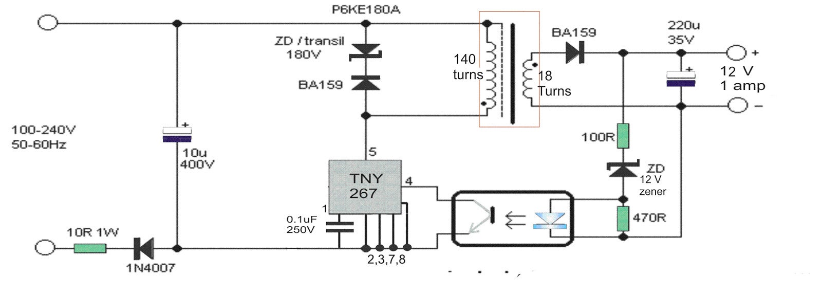

At the moment I'm working on my Bosch dishwasher which stopped working.
The TNY264GN is blown and needs replacing, luckily it's still available.
There was also a resistor or coil blown and there is my first challenge. Identifying the component.
   - Can anybody help me with the identification of the component in the picture (not the red circle but above it) ?
The color code looked like: Brown - Black - Black - Gold ---- White
But it as over heated and cracked.
In some of the pictures found for this PCB it looks like Brown - Black - Brown-Gold ---- White.
My best guess would be a 10uH coil, but how many amps ?
It would be very helpfull if anybody has a schematic to this board EPG60613 and is willing to share it with me.
Anybody ?

Does it still measure any resistance? What about white gray black black gold? Hard to tell for me on your picture, 980 ohms? Ending brown or gold wouldn’t matter much.

Nah, that can’t be right… because the other resistor is then 981ohms… what is that that circuit the resistor is in?

I would have to guess that might be a flame proof fusible resistor like this one:
https://www.digikey.com/en/products/detail/yageo/FKN50SJR-52-10R/2167105
It it in the input area of the circuit? It could be a current limiting resistor / fuse.

It's in the power circuit for sure, but i'm not sure yet in which part.
It's not in the input circuit of the switchingpower supply.
I have to do a little bit more reverse engineering to be sure.

If the colours remaining are to be trusted, it looks like a 10 Ohm resistor. Probable the fusible type, as indicated above.

What you indicate makes more sense.
It looks more like a resistor than an inductor, also on the inside and the wires are pretty much broken across the whole length of the cylinder.
Going by the size it would be a 1 Watt type.
Thank you for the eye opener.

I have a similar problem with this board - resistor burned in such a way that the colour code is unreadable.
Have you managed to repair the board and would you mind sharing what you did if you succeeded?
Offline RayNg
Re: Bosch EPG60613 - Power supply question
« Reply #11 on: July 26, 2023, 04:00:36 am »
