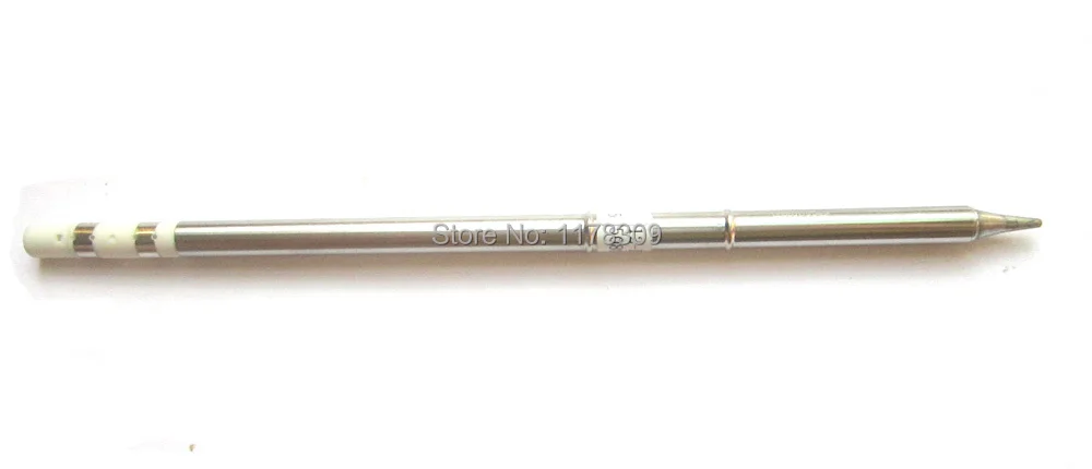

Ah, yes. I tried 3 different tips, the problem still occured  :palm:
I just tried without. Instead of 350 degrees it says 320 degrees, but when I adjust the temperature, it won't move -- just stays at 320.
« Last Edit: June 11, 2020, 06:43:56 pm by wf789 »

the build quality semes to be ok but both tips missing in the package.
so i orderer from banggood a set of tips: https://www.banggood.com/Drillpro-10pcs-T12-Soldering-Iron-Tips-Set-for-HAKKO-FX951-FX952-p-1191594.html
