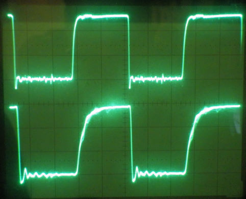

Then I thought, hell I have a scope! Let's do some probing! Well I found something weird on the clock signals, shown on the pictures. One of them shows the clock signal on pin 1 of the MPU relative to GND (the shielding):
http://oi62.tinypic.com/30iexza.jpg
The second picture shows both clocks, on pin 1 and on pin 39 of the MPU:
http://i58.tinypic.com/2hrpeuo.jpg
Now I don't have much knowledge of how these old 8-bit multi-phase MPU's work, but I don't think that the clock on pin 39 (it's Phase 0 on the schematics) is healthy. Anyone have some knowledge about this, or perhaps could tell me what -should- be the signal there by taking out a working C64 and doing a probing on that pin, so I could check what's the issue?

The whole video signal is generated by the VIC, so as long as you can see characters on the screen I would assume that the VIC is ok. But then yes, in the C64 the two-phase CPU clock was generated by the VIC, this is why US and European C64 were running at different clock frequencies, because the color burst frequencies for NTSC and PAL are different.
Let me hook up my C64 to a scope and I can check the clock signals...

Well, it seems that the phi_2 signal is supposed to look as crappy as it does on your C64.
This is how the two signals look in my (working) C64:
And this is the video signal, but since you - at least sometimes - get an image on the screen, it should be ok:
Be careful not to run the C64 for too long without heatsink on the CPU and VIC. I remember that an overheated VIC was a common cause of death at those times.
Since the PROMs were masked rather than OTPROMs I guess you can exclude those from your search - I would probably suspect a power supply or RAM problem.

Yeah, I've checked that site, also thanks for the pictures, I'm now assuming it's not the VIC, neither is the VCO, since I checked that as well.
Sadly I don't have another C64, only this one, neither any cartridges, but maybe I can get a few from a friend to test. I really hope it's not the PLA that's faulty, because it's a bitch to replace that is nigh impossible to me due to lack of EPROMs or spare working ones, since my friend's busted C64 has full black screen all time, so I guess his one's PLA is faulty too. How could I test if the RAM is working or not? The voltages on them seem to be fine.
