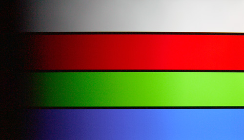

Tooks some pics,
hope it's ok.
What do you think, is it a broken connector/ ribboncable or has it to do something with the graphic processor?
« Last Edit: September 21, 2016, 09:48:04 pm by ulix »

« Reply #13 on: September 22, 2016, 03:52:16 am »
you can copy that jpg to sd card and display on the camera, will make it clearer
but it looks like every color is over saturating, probably something on the lcd itself
have you poked at the bga and connector?

the difference is camera sensors send data in YUV, meaning even one bad bit will screw whole palette
LCDs with rhat many lines on a flex (40 here) are usually parallel RGB, so you would need at least three bad connections to screw all three base colors (like on the last pictures), unlikely me thinks. bad vref/bias voltage on the lcd maybe?
there should be some markings on the back, maybe even manufacturer and model number
Offline bktemp
  • Posts: 1616
Re: Camera displaying wrong colors
« Reply #16 on: September 22, 2016, 12:03:51 pm »
I don't think it is a problem with a bias/gamma voltage of the lcd (it would totally distort the colours, not just jump back to a lower brightness), it looks much more like a missing bit in the digital domain. But you are right, it is odd to see the missing bit on each colour. It could still be a bad connection on the main controller/memory screwing up the YUV data before it is sent to the lcd.
Maybe this lcd does not use parallel RGB but serial RGB (6/8bit parallel bus transferring RGB sequentially)? Many lcds used in cameras don't use the usual RGB subpixel pattern but some other odd layouts to simulate higher resolutions.
In the pictures straight lines look quite jagged, so the lcd uses most likely one of those unusual pixel layouts.
