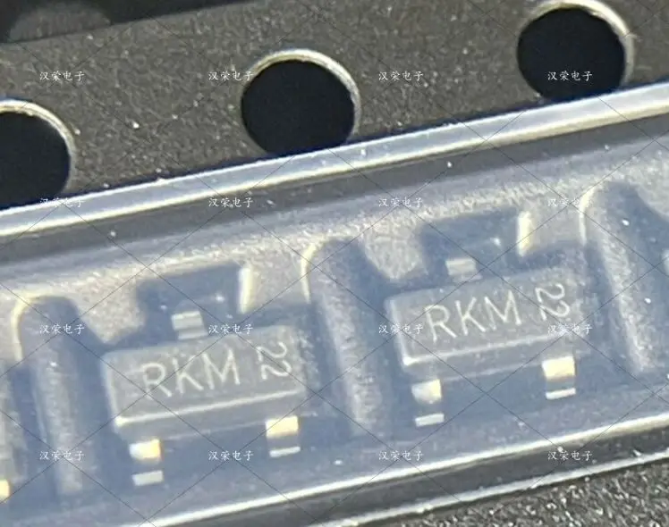

Offline floobydust
  • Posts: 7593
Re: Can this Noctua 12v Fan be fixed?
« Reply #16 on: July 31, 2024, 01:48:39 am »
I meant SC-59 for as a package guess, it seems smaller than SOT-23?
SMT marking code "RK" is a hall sensor like AK1751 but "M" is not a valid year code.
Or RK7002 but SOT-23.
Just looking at other parts that might have died.

Offline enut11Topic starter
  • Posts: 1025
  • Love building/modifying/restoring test equipment
« Reply #19 on: July 31, 2024, 02:08:01 am »
Transistor ID is RKM40
What is the circuit reference? Is it a Q or an IC?
Does it look like this?
It's a Q. Similar to your URL.
« Last Edit: July 31, 2024, 02:10:18 am by enut11 »
an electronics nut from wayback...
Offline fzabkar
  • Posts: 2735
« Reply #20 on: July 31, 2024, 02:17:38 am »
Then it's probably an RK7002 by Rohm:
https://avtronic.eu/medias/rk7002/rk7002.pdf
