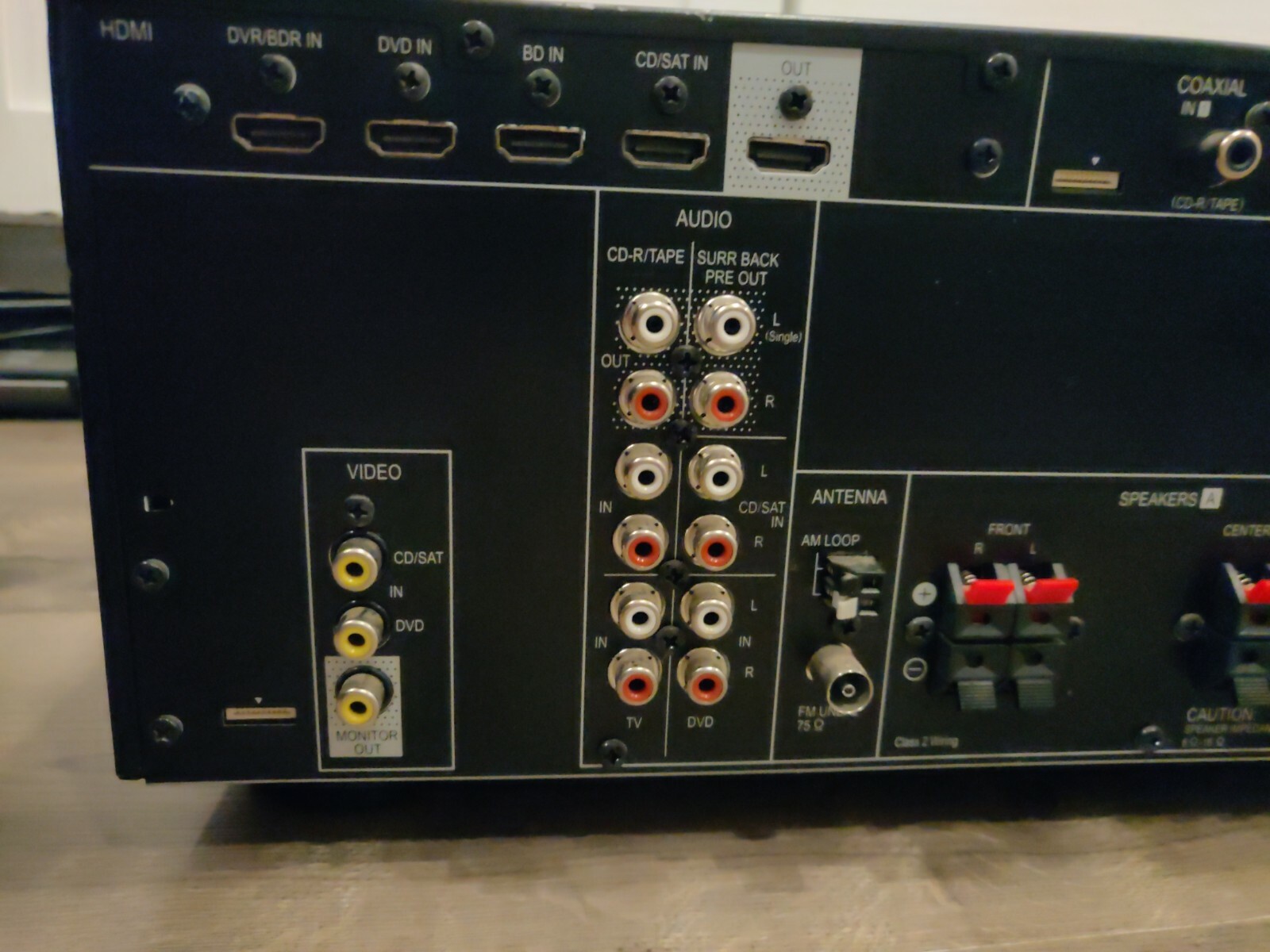

I tried some active speakers I use on the PC but the TV doesn't seem to send any sound at all. Reading this I need an adapter apparently (the TV image is the same as mine):
https://www.reddit.com/r/audio/comments/amqj45/trying_to_use_bose_companion_3_with_lg_55_tv/
The markings on the panel in that photo are quite explicit that those RCA jacks are inputs to the TV.  Not surprising that nothing comes out.
Both your TV and AV receiver have TosLink Optical jacks.  Connect those with an optical cable.
Yeah... I realised just after trying. Unfortunately my TV has no jack connection BUT I tried my phone and it worked (I also needed to disable ARC mode). The thing is that at that point, the HDMI was working so I need to try again when it doesn't work

There is something else called "AV sync" but I guess this is to apply some delay from the TV
- if you have an option for E-ARC (Enhanced ARC) turn that OFF, at least until basic ARC works fine:
This LG model has not E-ARC
- use a new HDMI cable, something certified for 4k (even if you don't have that) and "with Ethernet":
I used 3 HDMI: one I was using on my monitor, another one from Amazon (4k certified) and the Xbox SX one, which is the ultra fast (2.1, 120hz)
- DO NOT use an active HDMI cable. These are often super slim and/or very long cables, and usually have one end marked "in" or "source" and the other "out" or "TV" or "sink". These may not work with ARC.
Can't see any of those marks on these cables
- Only one HDMI input on the TV is compatible with ARC, make sure to use that. If possible, don't use any other inputs (send other sources into the AVR if possible).
Yes, it's connected to HDMI2: https://cdn-files.kimovil.com/tv_default/0004/10/thumb_309616_tv_default_big.jpeg
- If the AVR has more than one HDMI output, only one can use ARC.
Nope, only one: https://i.ebayimg.com/images/g/u68AAOSwuOph5TnF/s-l1600.jpg
- for both TV and AVR, if using the wrong port, the devices may still think they can use ARC (because CEC communications still works) but the HDMI ports can't physically do it so you get no sound.
I assume the ports are correct since this problem doesn't happen all the time and as I just mentioned both TV and AV only have one port for HDMI ARC
- In settings for TV and AVR, look for automatic power on/off options. You do want the TV to be able to control power of the AVR:
This is activated by Simplink. Inside this option one check is for the volume and the other one for the power
- You might need to turn on the AVR before the TV, so that when the TV wakes up, it "sees" the ARC is available and uses it. Otherwise it might automatically switch to some other default sound output, without you even knowing it. This is a pain but if you use a universal programmable remote, you can usually program a custom power-on sequence with necessary delays to accomplish this:
Makes sense but when this happens I can notice if the sound is coming from TV or 5.1. Normally when TV turns on the AV does but it takes up to 10s. During this time there is no sound
- AVR input will need to be "TV" (etc.), but there are still multiple possible sources of audio for "TV", such as analog RCA jacks, optical digital, maybe Coax digital, and finally, ARC. Don't connect anything to other TV audio inputs (especially digital optical/coax), and if the AVR has settings to select the audio input, either choose automatic, or ARC only.
[/quote]
Yeap, all disconnected. Just plugged in to test
Now I can't even change volume when any digital channel selected from TV. It shows a disable icon:
This is a new random thing I don't know about (more info: https://www.avforums.com/threads/lg-65uk6300plb-flashing-mute-icon-and-menu-wont-go-away-see-image.2273900/)
working now
I think what it makes more sense now is to have an analog connection. I don't want to get crazy or get you crazy as well trying to find the solution because maybe there is none. Knowing my TV has no 3.5 should I buy a DAC?

Why do you thing buying a DAC will help?  The only digital outputs from the TV are the optical one and the ARC one.  Optical between TV and AV Rx is a simple, no negotiation protocol for both ends and should work.  Do you get red light from the AV Rx end of the cable when the TV end is plugged in?
Offline xiwiTopic starter
  • Posts: 24
Re: Can't reproduce sound from TV on AV receiver
« Reply #19 on: December 13, 2022, 09:23:01 pm »
I do get the red line.
Well, because from analog I don't find any problem. When testing with the phone it always work.
I'm not able to connect it by optical cable. Not sure if this is because similar problem with HDMI or if both share some chip/whatever and that's the failing part.

It was blinking all the time but I just found something.
I was facing some problems now with digital connections and sound control. I modified the optical connection in the TV settings. It needed to be optical + LG Sound Sync (this is different from Simplink). This helps optical to control volume from TV remote. Spoiler alert: it doesn't.
The thing is that HDMI ARC works right now as well so I'm not sure if optical connection is working because of randomness (like HDMI) or because I changed something (I'd say I already tried that config but can't confirm).
I'll double check tomorrow morning when things seem to be failing  :-//
  • Posts: 24
« Reply #22 on: December 14, 2022, 10:22:38 am »
Interesting test today.
I have connected both HDMI and optical. I have:
- disabled ARC on AV
- selected 01 signal on AV
- selected optical on TV
works. On AV it shows PCM and digital (no HDMI). With this, if I activate ARC on AV it doesn't work. And I select HDMI ARC instead on TV (with previous config) the only thing changing is Dolby Digital instead of PCM and it also works
BUT
if I remove the HDMI cable, the sound is still working, which tells us despite HDMI ARC is selected on TV the sound comes from the optical cable. If I change the 01 signal nothing works.
Optical has LG Sound Sync but it doesn't work because I cannot control anything.
So yeah, I guess we could say HDMI is gone on AV. At least there is an optical channel I can use. Not sure if there is any fix for that LG Sound Sync or if I'll have to find a remote control for both. Anyway guys, thanks for the help!  :-+

Some people seem to have found this procedure in this topic worked:
https://www.lgwebos.com/topic/2604-hdmi-arc-audio-out-not-working-again/
The following users thanked this post: xiwi
  • Posts: 24
« Reply #24 on: December 14, 2022, 04:05:40 pm »
What the... that worked!
Pretty much that's disconnecting HDMI, power cables and connecting them back again. Are you telling me the classic disconnect/connect actually does something??
Well, thanks for that. I'll wait a couple of days to see how it reacts
