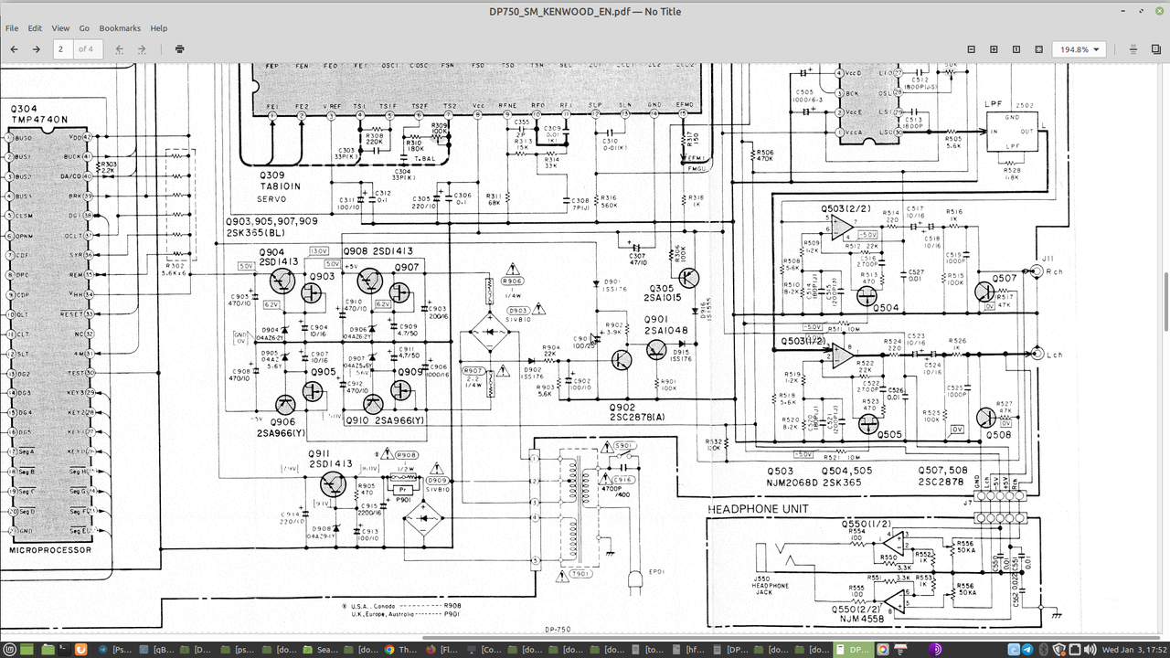

A recently acquired Kenwood DP-750 CD player (1986) has several weird issues. No laser power, one regulator (Q908) runs hot as does the DAC chip.
It may be the -5V line, which I measure at about +1.4V.
Going thru the orig caps, all were okay with no leaks and only mildly higher ESR than brand new. Those OEM Japanese caps!
Except one: (C906) a 1000/16v electro, Almost a near short across it (about 1 ohm).
NOTE: I tested and replaced caps BEFORE researching the troublesome issues.
Anyway, after replacing that, I still have same issues -- even more as I have lost some button functionality (drawer open/close, etc).
I am thinking that when that cap shorted, it took out nearby active components (Q909, Q910).
Which I have not tested; the PCB is bit of a pain to take in and out!!
Any guesses or speculation as to what that shorted cap may have done.
Have a look at the schematic images below. Full schematic PDF also attached.

« Reply #1 on: January 04, 2024, 04:34:46 am »
C906 being shorted would have stressed D903, R907 (Also a fuse), and maybe the transformer T901.
Check the voltage across the new C906 when the unit is powered up. What do you measure?
R907 is blown -- nice catch!
Yeah, I have checked the some of the other other components in that area, incl. D903,  and they seem to be okay. So I guess R907 did what it was supposed to do. But still way to too early to tell what else may be wrong.

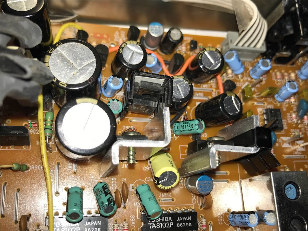

Something a bit odd.--despite the -5v line now repaired --is that while the DAC chip runs much cooler, and it and other chips that need -5V now have -5v... nevertheless, after about 5 mins of pwr up, all the voltage regs become quite hot running (even with heatsinks, can't keep finger  on them). Even just idling with no CD playing. Also, the wattage/amp use also go up by about 2 watts, Not sure what could be soaking up so much current ???
Reg. section with three 3-pin power trans, shown below. Note that I added a small heartsink to the one in back. It get very warm to hot. Power use  about 7 watts -- idling. The back panel specs note 13watts at 117vAC, but I've never seen that much pwr uses .

When manufacturers locate electro caps right next and in such close proximity to heat sink(s), it's usually just a matter of time that the caps fail.
Actually, the OEM caps near those hot devices were in good ESR shape. Notice how bent they are away from the heatsink. I replaced a few in that area with higher-quality Panasonic FM, but and those silver solid Japanese electros. Way back, I'm going to assume the OEM designers knew about the heat issue and chose caps that would be robust. The single cap that failed was well away from any pwr hearsunk device.
Which transistor is that? Q904 or Q908?
Does the CD player now appear to work even though the regulators are getting hot?
The device works fine up to a point; it seems to have a bad laser, too. That may have been damaged by whatever led to the shorted cap issue. Not sure.
 Q904 , Q908 and Q911 all get hot. All three same device: An NPN power trans, TO-220

Well, if we look at Q904 as an example:
It powers the microprocessor (Q304) and also the LED display (D203) among other things. Lets just say, as a guess, that 200mA is the draw off that 5V rail. The test points around Q904 show 13V on the collector and 5V on the emitter which means it has 8V across it. 8V @ 200mA = 1.6Watts which would get pretty toasty with a small heatsink. So maybe "hot" to the touch is kind of normal.
Not only that, but that -- "hot--is my subjective opinion. I did measure the ICs with a IR laser scanner. Not the most trustworthy of devices. I did get some reading as high as 120F. But mostly around 100 for the pwr regs. The DAC IC, before the cap issue was fixed, was 110F at highest (I did heat sink it then). After fix, it has cooled to 95F max.

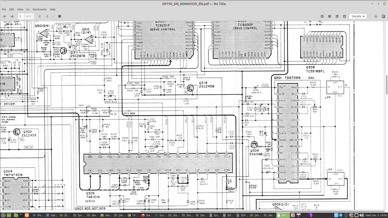

Another curiosity, which I may bring up in another thread, is the X_o osc. waveform, which looks fuzzy compared to a similar ( but not identical ) Kenwood  CD player model dp-160, from same vintage,  that uses a very, very similar circuit design, down to the ICs and regulators ... and a 67.7376 MHz xtal that is driven by the DAC internal Pierce (??) osc. (X_o, X_in). See schematic.
Well, you can't reliably measure the xtal oscillator with a scope probe on pins 10 or 12 of the DAC (Q501) because the scope probe will change the capacitive loading. Note that C503 & C507 are only 5pF, so therefore this part of the circuit is extremely sensitive to any additional loading.
I have very similar Kenwood dp-460 that uses almost the same circuit design--except that xtal (dp-460 seems to be a 16.9344 mhz) . The dp-460 look much cleaner and DIFFERENT  than the dp-750; but both units  sound and perform just fine . Strangely, I see a sawtooth waveform on both BCK and X_o pins on the dp-750. On the dp-460, X_o looks like a sharp sine wage and BCK looks like a square wave. I am used to seeing square waves in CD players.
