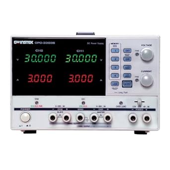

Is yours actually this version with the gap or is it the newer one with all jacks equispaced?
It's the version with the gap, exactly as pictured.
