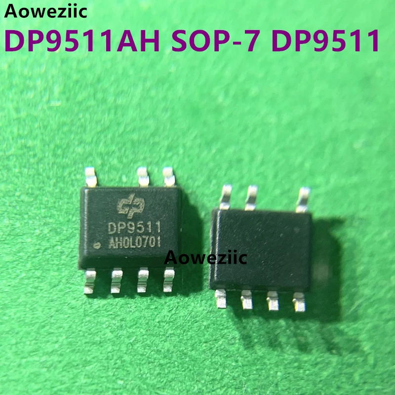

Can anyone identify the manufacturer? I'm not familiar with this logo. ("dp"?)
It's an SMPS controller. 1,27mm SOP-7

DPx525
Some clues here ...
https://v4.cecdn.yun300.cn/100001_2101295378/DP951X_REV1.0%20CN.pdf
https://v4.cecdn.yun300.cn/100001_2101295378%2FDP970X_REV1.0_2020-03-01_CN.pdf
https://ae01.alicdn.com/kf/S2dd342db82d842008e56b97baf24ed71c/DP9511AH-SOP-7-DP9511-Non-isolated-buck-LED-constant-current-driver-chip-is-brand-new.jpg
https://ae01.alicdn.com/kf/Scf055ad5948349eab2be1cccbf1525a6m/10-sztuk-partia-kaiweidzic-nowy-DP8628C-SOP8-DP8302-DP8628B-DP024C-DP9126I-BP3166A-DP9512-DP9128-DP3773-DP9511B.jpg
https://en.publicxin.com/product/32/
Last Edit: May 30, 2024, 06:31:02 pm by fzabkar

This is the chip manufacturer:
http://www.depuw.com/en/productlist_50_68.html
My browser sees nothing. :-(
I tried several iterations of DPx525 in the search box, but I got nothing. Maybe the part number is DPxx525
Last Edit: May 30, 2024, 06:44:34 pm by fzabkar

Thanks mate.
Shenzhen Developer Microelectronics Co LTd.
Never heard of them. Est. 2006.

What about this?
DP2525
https://www.isweek.cn/Uploads/20150807/55c4275178729.pdf
https://pl.aliexpress.com/item/1005001446757488.html
But this makes me suspicious ...
https://pl.aliexpress.com/i/1005003913659497.html
Last Edit: May 30, 2024, 07:13:26 pm by fzabkar

Just ask them dp@depuw.com
Chinese homepage works, but I can't find anything close to that part# - seems to be quite outdated as well...

could be this one
https://pdf1.alldatasheet.com/datasheet-pdf/view/1756522/DEPUW/DP2525F.html
