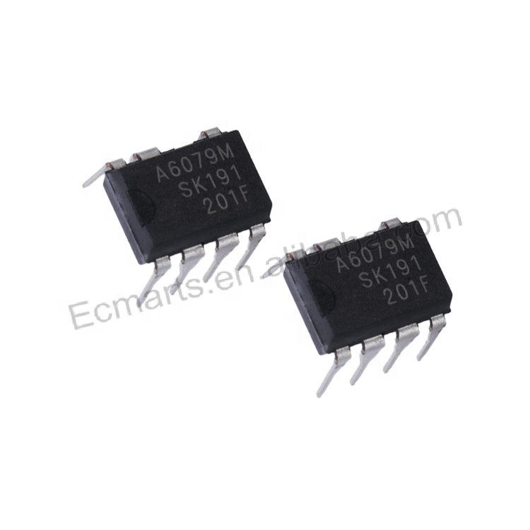

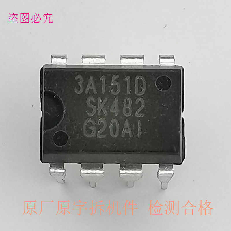

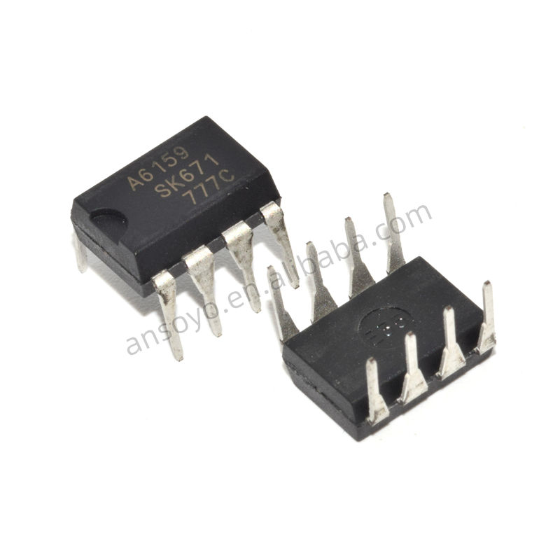

Offline fzabkar
  • Posts: 2804
Re: CIRCUIT INTEGRE 1A374 SK202 G16BAN
« Reply #5 on: October 21, 2024, 09:39:17 pm »
The "SK" in "SK202" could be Sanken. "2O2" could be Year/Month/Day.
https://www.semicon.sanken-ele.co.jp/sk_content/str-a606xhd_ds_en.pdf
    Y is the last digit of the year of manufacture (0 to 9)
    M is the month of the year (1 to 9, O, N, or D)
    D is a period of days:
     1: the first 10 days of the month (1st to 10th)
     2: the second 10 days of the month (11th to 20th)
     3: the last 10–11 days of the month (21st to 31st)
https://s.alicdn.com/@sc04/kf/He4c9b73ec0ae421a86850cd838320ef0E.jpg (STR-A6079M)
https://s.alicdn.com/@sc04/kf/H3233b1c4a67f4d948e5a138879cabcd6J.jpg (STR-A6159)
https://http2.mlstatic.com/D_NQ_NP_720753-MLA44483969940_012021-O.webp (STR-A6252)
https://img.alicdn.com/imgextra/i4/67272588/O1CN01QPyXKl1UzLcle4wdk_!!0-item_pic.jpg_q50s50.jpg (STR-3A151D)
https://www.semicon.sanken-ele.co.jp/sk_content/str6a161hvd_ds_en.pdf (STR6A161HVD)
https://sgemx.com/amfile/file/download/file/762/product/62471/ (STR5A100D series)
That said, I couldn't find any reference to STR-1A374.
