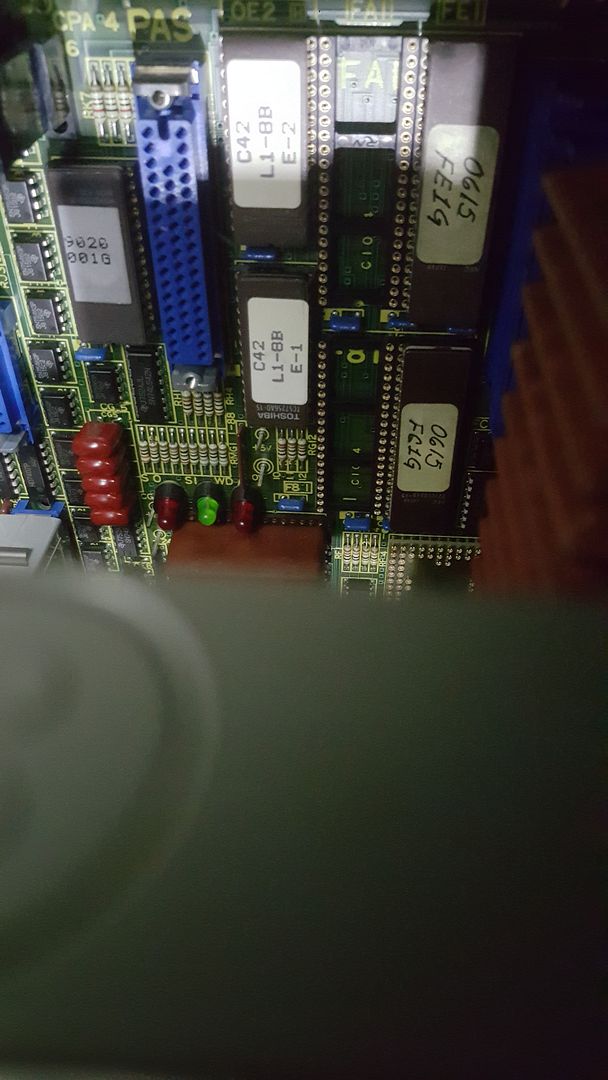

Hello,
First post here. I hope I have to come to the right place. I've been playing with electronics all my life and am now finally reading more about them and learning the theory behind circuit design. A project has come up recently that I wanted to do a little research on before I start. I recently acquired a Hardinge CNC lathe and it is throwing an error. The error relates to the main control board and two eeprom modules that store the ladder diagrams for the machine. This machine was built in 1988.
I have some standard test equipment and will likely be purchasing a scope in the immediate future. I am able to test circuits for simple things but I have no idea about eeprom chips. The problem either points to 2 bad eeprom chips (which seems unlikely that they both went at the same time), a dead battery that saved the memory (hopefully) or part of the main control board being the problem. I don't have power to the machine quite yet but when I do I will start with the batteries and work up from there.
My two biggest questions are is there a way to test the chips without erasing whats on them and is there a way to see if the board is effectively communicating with the chips? A repair of this magnitude is going to cost be about $1500 and a board replacement is somewhere in the neighborhood of $5k so I would like to troubleshoot it myself initially.
The data that is stored on the chips is absolutely vital to the way machine runs. Losing that data means I need to pay to have it repaired or scrap the machine. I would like ot be able to back that data up in the future if feasible at some point so I can make copies but that would be after I get it working again.
Any help is appreciated.

First we need to know the chip part numbers to begin to answer the question. A picture of the chips on the board and what surrounds them couldn't hurt either.
eeprom chips are pretty robust and would strike me as an odd failure point, it is highly likely you will be able to read out the data if they are of any of the standard form factors.

Was just taking photos of them because they are stuffed way in the back corner of the machine and I couldn't read them without taking the board out. The chips are Toshiba TC57256AD-15. They are labelled E-1 and E-2 on the stickers.

Here is another photo for good measure but I'm not sure it shows anything more than the first. From researching this problem it seemed highly unlikely that both chips would go at the same time and the problem lay with the board.
My first order of business is getting power to the machine which will be hopefully sometime next week. When I do I will need to enter about 500 strings of paramaters because every time you hit this error you have to wipe the memory. Super fun! I will start with replacing the batteries first which you are supposed to do with the machine running so as not to lose the parameters but if I can't get past the error and have to redo it over and over again I might as well do that. Failing that I will check some voltages as I know failed power supplies are common and can throw out all kinds of errors. Planned on looking the board over very carefully in the next few days for any tell tale signs of blown components as well.
If none of that works then I guess I will be concentrating around the eeproms themselves and then off to repair when I can get the money but I'm hoping (fingers crossed) its something simple (like the batteries).

Those look like standard eproms, not eeproms and you should be able to read them with any generic EPROM programmer or you can rig something up with a board like an arduino if you have one laying about. You need to supply them with 12v in a specific pattern to write to them, so you have pretty much nothing to worry about homebrewing something to read them at 5v if you don't want to accidentally write to them. Just treat them with the care you would other ICs.
It is unlikely they are the cause but I can understand wanting to back them up before poking around.

The single most important piece of information that will determine your course of action lies with the checksum, stored in each EPROM.
If any single EPROM throws a checksum error, that chip *must* be reprogrammed with a copy of the original data of the proper revision. This data may be obtained from another identically marked chip on a known working board.
EPROMs store data by virtue of an electrical charge injected into the floating gate of individual mos transistors. This charge does leak off slowly over decades, resulting in bits changing state. The term used to describe this failure mode is "bit rot" and is detected at boot-time when the newly calculated checksum fails to match the checksum stored within the chip itself. The manufacturers datasheets typically state a 10-year data retention specification. That most of these aging EPROMs still pass checksum at three times the 10-year spec is a testament to the cleanliness of the fabrication process. But electrons are still leaking from the floating gate and time is running out.
If the error does *not* indicate an EPROM checksum failure, the problem lies elsewhere and may very well be the machine parameters have been lost from battery-backed SRAM. Getting power to the machine and a fresh new battery should be completed before attempting to reload machine parameters. So in this regard, you are already on the correct path. Failure of single cells or entire rows within SRAM is another consideration, it is rare but definitely happens.

Thank you for the very detailed answer. The error I'm getting is a 998 rom parity error and when on screen it points to both eproms.  From what the previous owner told me it was fine and then the error showed up and both were listed on the screen. I know its not very common that both are listed and I was thinking that something might be wrong with the board itself.
All of the fanuc manuals I have read say either the main board or the rom modules are to blame. I do remember someone online talking about chksums like you explained but I don't see it listed anywhere in the manual.
If I am able to fix it  then backing these up is still probably a good idea or even replacing them with new chips.  Considering the bit rot you explained it sounds like I would want to take care of that anyway.

If the ROM board cannot be addressed/read from, then both ROMs would be implicated. The 5 Volt supply should be checked right at the main board and ideally at the ROMs themselves. I*R drops through the wiring harness are then taken into account. The TTL Vcc spec is 5.0 +/- 0.25 Volts (+/- 5%) at the chips.
Checksums would never be in the manuals, they change with each firmware revision and are stored in the ROMs themselves at the time they were first written. The boot-up self-test routine calculates a checksum on each ROM as a means of detecting corrupt code to guard against damage/unexpected behavior and save troubleshooting time. Nothing like spending hours looking for a hardware/electrical fault only to find out after a $5k board swap it was corrupt code in an EPROM. The checksum cuts to the chase very first thing and alerts us with the error code that it's borked.
