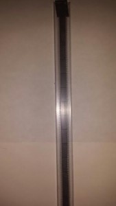

About ready to pull the MN400 back out of the bin and do some more looking. I ordered a few PS2801-4 optos from china been 45 days no receipt! They are resending because they cannot find the tracking info. Glad I put a sticky note on the board!

Love it when the mail woman delivers the goods a rail of PS2801-4's time to dig the board out of the closet and get to work.
