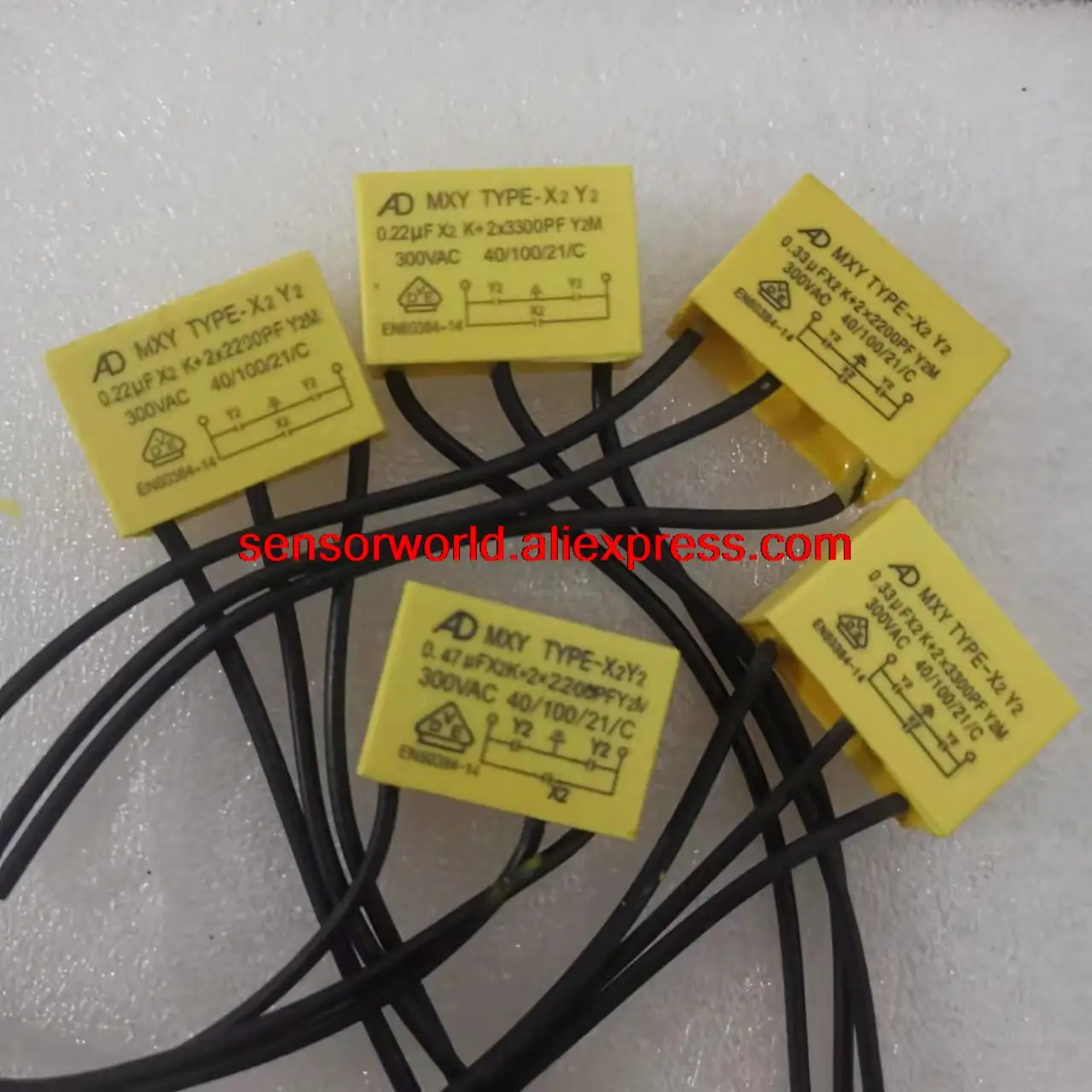

Offline floobydust
  • Posts: 7593
Yes it's a paper/wax dual capacitor but they are uncommon nowadays, you would use two safety-certified Y-class capacitors with the common ground.
Sewing machines caused AM radio interference which was not wanted. Arcing across the motor brushes and the speed control switches.
I would guess they are large around 47nF each and 300VAC rated but I can't see the schematic for this box. There should be another capacitor across the motor terminals.
Don't use Rifa PME271Y they are known unreliable. Kemet PME850 series looks good to me.
Those Aliexpress filters are eh ur uh have a lot of capacitance and dubious quality given there is no fuse to be seen it makes me not want to use them.
