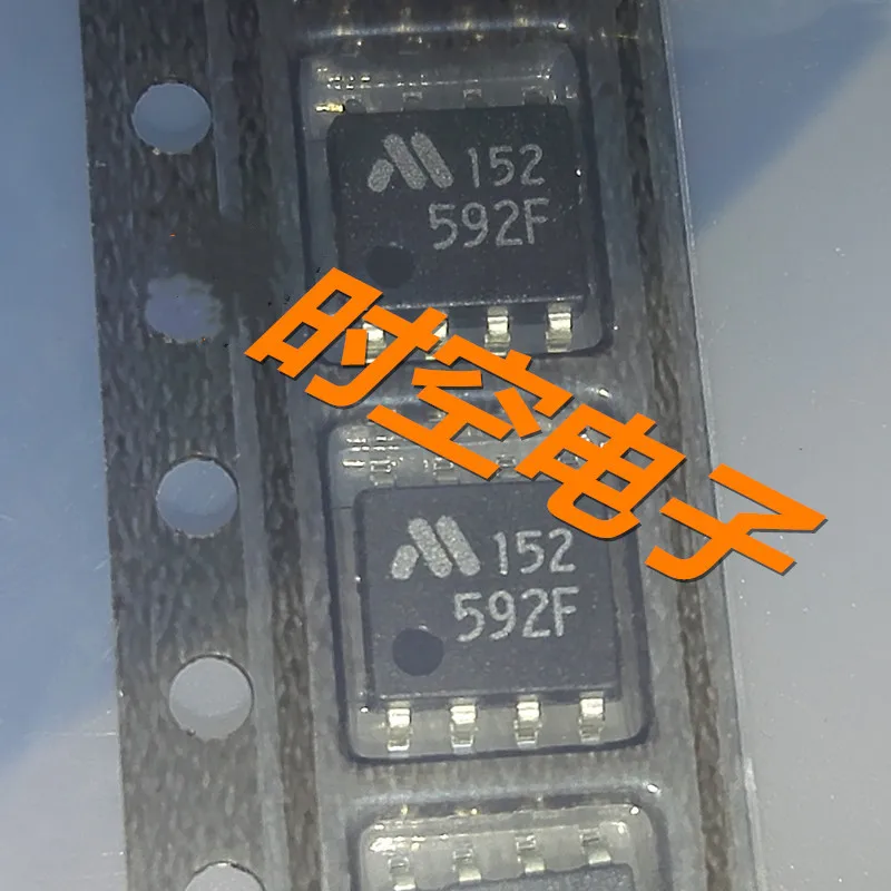

Anyway, I checked for shorted caps and blown components to no avail. After correctly connecting to a proper power supply, I noticed a very hot chip with the thermal camera, which probably took the blow as it's connected directly to the 5V rail:
1834282-0
The markings are way too generic and I don't recognize the manufacturer's logo. Does anyone know what this component could be? My best guess so far is an op-amp, but which one?
The hot component reads: 613 478A, and there is 5V on pin 3. The component below appears to be almost the same, and reads 613 592B.
« Last Edit: July 22, 2023, 03:02:29 am by docca »

The logo belongs to Microchip.
2006 Product LineUp:
https://web.archive.org/web/20061016034101/http://www.microchip.com/stellent/idcplg?IdcService=SS_GET_PAGE&nodeId=69
FWIW, TI makes an 8-pin TL592B ...

Thanks for the info! However looking at the datasheet section, I cannot find anything resembling "631". The closest I found was 619, then 6231.
I did found this datasheet by chance from Rohm Semiconductor: https://pdf1.alldatasheet.net/datasheet-pdf/view/916152/ROHM/RB061US-30.html
It *does have* "613" printed on the chip and it's a Schottky barrier diode. Would that make sense for both chips? So that would make the lower line just date codes...

Hi, I can't help you identify the component, but are you sure it says 613, and not 6l3 (letter L)? Looks like it to me. Might help your search, if you agree.
Online wraper
  • Posts: 17819
  • Country: lv
Re: Could anyone identify this component please?
« Reply #9 on: July 25, 2023, 06:42:44 am »
I fail to recall which manufacturer it was exactly, but if "M" is not within circle, it's not microchip. There was one very similarly looking except lack of circle.
Online wraper
  • Posts: 17819
  • Country: lv
« Reply #10 on: July 25, 2023, 07:22:14 am »
Finally remembered, it's Mitsumi.
The following users thanked this post: fzabkar

FWIW, Mitsumi does have a reset IC (plus 3.4V regulator - for the SoC?) that fits the part marking, but it has the wrong package:
Oh wow, thanks for the thorough research!  :)
Offline DavidAlfa
  • Posts: 6317
« Reply #19 on: July 26, 2023, 03:16:45 am »
Here you have the schematics for the SD-M1502, which has a suspicously similar IC (IC0001), looks like another Mitsumi chip, MM1456 or M1458 (Another reset IC + regulator).
https://fccid.io/CJ6AT00-046/Schematics/Schematic-Diagram-ExhibitG-116069.pdf
However it's a 7-pin part, combining what would be pins 6&7 into just pin 6.
Indeed, the MM1478 seems to match very closely!
