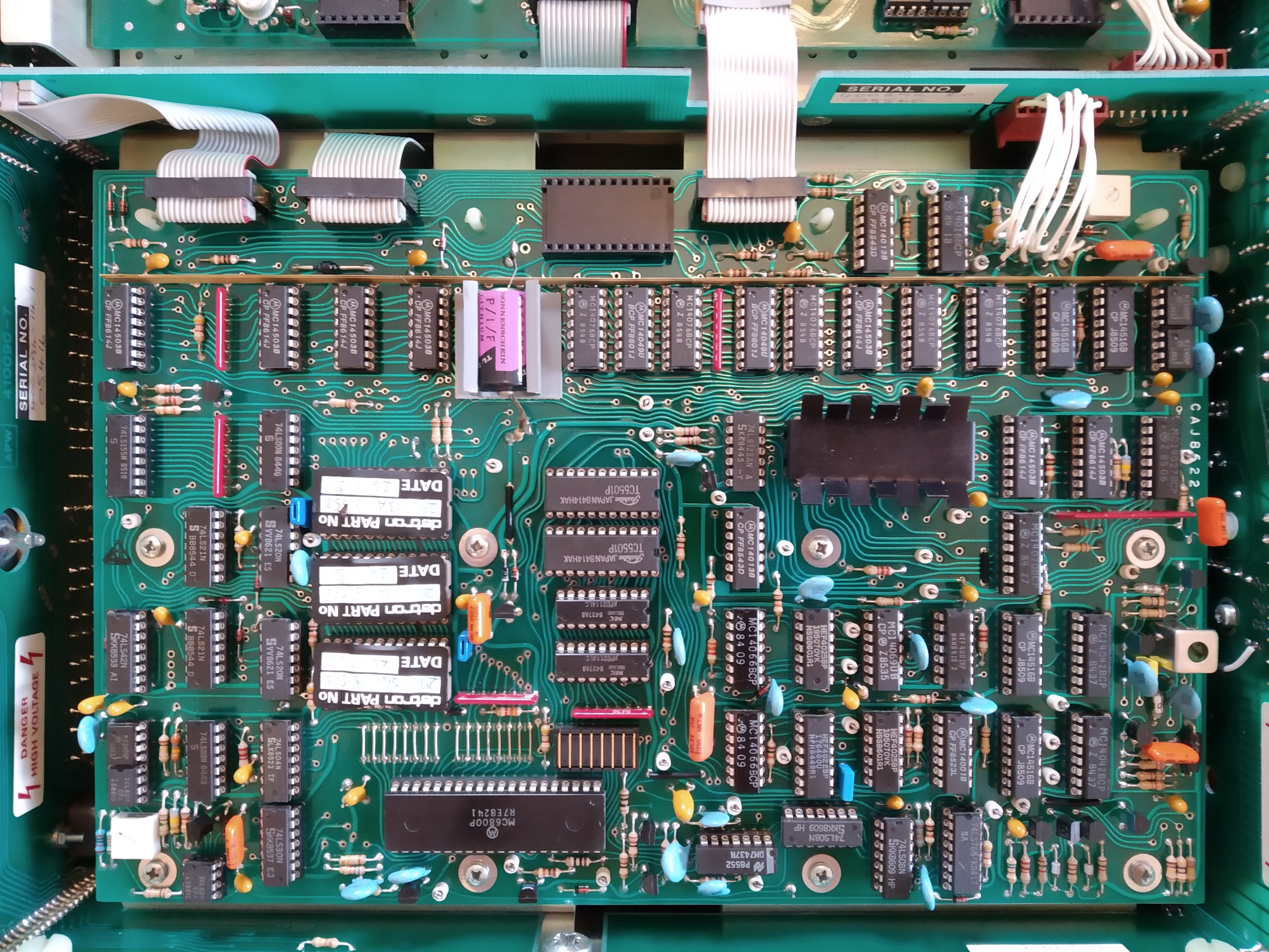

I got a Datron 1061 from 1983 or 84 , I bought my self and got it back from the University some years ago. Series number 7349
After many many hours work it's excellent. Changes dc input as well as AC board many transistors and FET and the oscillator  , based on curve tracer.
It's very stable.    That is not what I want to discuss.
The manual and schematics says the third socket should be a TMS2516jl  with other word 2 Kbyte.  I have no problem to program with GQ-4x4 whats so ever with TMS2532jl or TMS2516jl I have them now on my bench. Most of the documentation on this web show that is three TMS2532jl  however I can dot that. I test with a logic pen yesterday and I can conform that the socket and signals indicate it should be a TMS2516 2 Kbyte on the third one.
I got software for Datron 1071 for this configuration , however without support for GPIB. I need GPIB
I must say I am not sure to upgrade at all from a good working equipment to  worse working 1071, You need to change several resistors, and that is doable in the next step. However my doubt is that a good Agilent 6½ digits with an exact RMS would be better.
However do anyone  have software  1061a or later for my configuration, without redesign these socket with one more address bit and Cs.

Don't do it. Even if you could get the 1071 firmware running in the 1061 it would not give you the same precision as the 1071 can.
First off, the zener diodes that provide the reference voltages are selected to lower standards. Second, there are other components on the analogue board, not just resistors but op-amps, which have considerably lower specs than the ones fitted in the 1071. All you will get is an inaccurate 7.5 digit meter.
As to your firmware problem. I have a 1061A which is a parts mule for my 1071. Which EPROM in the image below is the one that you are calling "the third socket"? (Click for full resolution)
I can remove the stickers from the EPROMS on my parts mule and see what type all of them are. Maybe it won't be useful as my 1061A has date codes from 1984, 85 and 86 on the digital board's ICs.
Sadly this 1061A does not have the GPIB option fitted either, so although I can dump the EPROMS and send you a copy, the dumps might not be any use as from what I understand there is a dependency between the digital board's firmware and the existence of a GPIB interface card.

As we all know early Datron 1061 had two Eprom TMS2532jl  on the Digital board and one empty socket for TMS2516jl for the future. The GPIB board option have it's own TMS2532jl  in my  setup.
Early 1071 software used the empty socket somehow TMS2516jl , but later on it switch to TMS2532jl if I am correct. And so did 1062  and so on.
I am not sure if it exist a 1061a with TMS2516jl, that is my wonder.  And ask for.

OK, here's what I found:
M35 (The EPROM closest to the CPU)
Datron Label 290056A-18-553 Date 26-11-1986
M30 (Middle)
Datron Label 290057A-18-553 Date 26-11-1986
M18 (Furthest from the CPU)
Datron Label 290113A-18-553 Date 26-11-1986
All three EPROMS are the same part number: TMS25L32JL-45
Apologies for the delay in replying.
  Lord of Sealand

Further info:
Both the circuit diagram and parts list in the 1061 service manual confirm that the EPROMS are all 4K x 8

That is what I thought. To be able to test it I need to add one address bit and change Cs. If it works I am not sure. It's possible, quite easy but ....
If You have spare time send these Eprom content for a test as I also need for GPIB  I will miss that.  It's a autumn work...

Some info...
The GPIB EPROM is part of the set, if you change the EPROM on the digital board the GPIB also has to be changed to match, otherwise the unit may not start anymore unless you disconnect the GPIB board.
Later units used a 2732 EPROM with special adapter socket which converted the pinout.
How to convert from TMS2532 to a 2732 pinout for use with an EPROM programmer or vice versa to use a 2732 EPROM in place of a TMS2532
Use a pair of stacked 24 pin sockets (flat pins for top socket, and machine pin for the bottom socket, bend the pins 18,20,21 of the top socket so they stick out between the top and bottom socket to allow wires to be connected to them.
To use a TMS2532 in a 2732 socket:
Link top socket pin 18 to bottom socket pin 21
Link top socket pin 21 to bottom socket pin 20
Link top socket pin 20 to bottom socket pin 18
You can only plug a TMS2532 into a 2732 socket, DO NOT USE IT THE OTHER WAY AROUND
To convert from a 2732 EPROM to a 2532 socket you do something similar:
Link top socket pin 18 to bottom socket pin 20
Link top socket pin 20 to bottom socket pin 21
Link top socket pin 21 to bottom socket pin 18
You can only plug a 2732 into a TMS2532 socket, DO NOT USE IT THE OTHER WAY AROUND

I don't think you should need an adapter board to just read the IC, the programmer probably can't supply the high voltage for programming the chip (VPP) at +25v.
TI really did use a different pinout for the 2532 compared with the 2732 so that an adaptor is needed even to read the EPROM.

2732 has separated chip select and output enable pins, and both must be down for read.
So after programming 2732 20 <-> 2532 21 must be disconnected.
If 2732 uses pins 18 and 20 separately that must be taken care of.
Vpp pin 21 of 2532 has logic level high for normal read so its in circuit connection is possibly blocking 2732 and 1061 seems to do so.
For 2732 in 2532 socket shorting 2732 pins 18 and 20 is fine.
2532 in 2732 socket is different.
If 2732 circuit uses pins 18 and 20 like they are meant to be used then chip(s) is/are selected(pin 18) earlier and actual access(pin 20) time is half or less than stamped value.
Not likely but possible.

Don't forget to check its programming voltage, some models can't reach 20V.
Better change the oldest to 12.5V 27-series stuff, permanently.
Thankfully, I'm only going to read these EPROMs for xantia_99. The 1061A is my parts mule to provide (for example) a replacement display or transformer if anything catastrophic was to happen to my 1071. So I have no need to upgrade the EPROMs.
I've tested my particular version of the TL-866 programming 2716/2732 EPROMs at 21V and it's fine with that, probably not with 25V.

Offline xantia_99Topic starter
  • Posts: 40
Re: datron 1061 to 1061a or later with TMS2516jl
« Reply #20 on: August 09, 2022, 03:30:45 pm »
Hi
A friend send me this file, I will test it later on. So for the moment I do  not need any support  and I thank you all for Your participation in my test of Datron 1061A  code in my 1061. With double extra 24 pin socket and no need to bend the pins on my TMS2532jl just shift some pins to get 12 bit address support and new Cs, hopefully it will work but you never know.
Cheers
xantia_99
