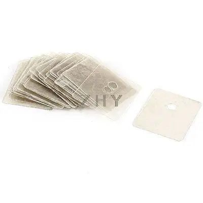

Reparing my old tek scope, one old electrolytic capacitor was short. So i change all 6, replace the fuse and reinstall everything in place. Got a trace, was looking fine and bang weird noise and fuse blow again.
On the video, with a variac, i rise the voltage slowly and you will see the scope is working. But at the end, they are a short circuit somewhere. Looks like high voltage. I tried same test without the crt. Same noise happen... Any idea ?

Sounds like there's sparking inside the scope. If you haven't been able to locate it by listening, you should be able to see burns on one of the boards.
It could also be a breakdown in the isolation of the cable that feeds the acceleration-voltage (the big black rubber cap on the CRT - BE REALLY CAREFUL AROUND THAT THING! Even with the scope turned Off, the capacitors can still hold lethal amounts of power!)

Yeah that's what it is... Tonight, turn off the lights and saw the spark :) Problem was the mica isolator between the frame and transistor. The center one. A nice beautifull spark :) Replace = ok
thank you

Thank for all your advice but it's fixed now.... Problem was a mica isolator between transistor (middle one) and frame. Replace only the isolator
