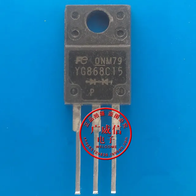

OK, how about getting some photos of the inside of the monitor ?.
As an example here are some pictures from one of my U2410's. You can see the  "L " shaped separate  power supply section and the various interconnect cables. You can work out what they are for, eg the connector on the right is mainly the power feed to the interface board and those signals should be mainly power, although there might be a start up/shut down signal from the logic to the power supply. The 2 multi legged ICs flat on the board are most likely linear regulators, by checking the part numbers you can find out what voltage they are, and trace their output lines to the connector.  They sometimes use multiple wires to give more current handling, so although there are 14 wires, there may only be 3 or 4 power rails.
The component you gave a picture of, looks like a big dual diode, maybe to supply the 5V from the switch mode transformer ?. I would expect to see a large capacitor next to it.
