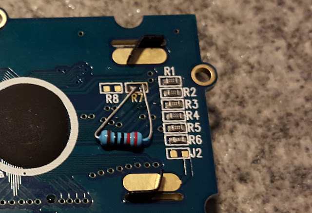

I have a "Grove LCD RGB Backlight" 2x16 display. Rather than having a potentiometer to adjust the contrast like most LCD 2x16 displays they decided to put in a 1K resistor(R7). I am not sure what they were thinking but for this particular unit it made the contrast so light it was not readable.
I have already managed to fix it by removing the 1K ohm resistor and replacing it with a through hole 220 ohm resisitor:
My repair works fine but it is ugly and delicate.
I think the part I replaced was a 0603 resistor. Is it practical to replace it with the correct part? Can this be done with an iron or do I need special tools?
I described the details of the method I used at Fixing the contrast on a Grove LCD RGB Backlight. Is there a better way to do this?
You've already done the hard part, removing the old one.  Soldering on a new resistor should not be too bad, other than dealing with the small size.  An iron will work fine.
All I did was press gently on it with the iron while applying a liberal amount of fresh solder. That was the easy part, took about 2 seconds. In the past I have had a terrible time trying to heat both ends at the same time, but since I figured out to add solder it is easy breezy.
It can be a fight.  Two irons can help, or even special-use tweezers: http://www.jbctools.com/pa120-a-micro-tweezers-product-49-category-5-menu-2.html.
I am going to order some 0603 220 ohm resistors and see what I can do. Worst case scenario I end up breaking it again.
Get several.  They are small and easy to lose.  You might also consider soldering wires to those pads and running them to an external potentiometer in case the contrast needs to be changed due to viewing angle or backlight color.

If you just smother the resistor in a solder blob, this melts both sides at the same time and it pops off quick and easy. I would only do this with solder mask in place, but that is the norm with SMD parts.
I was not planning on ordering just one 0603 resistor, they are 100 for $1 on a popular auction site. With electronics I pretty much always buy way more than I need, the stuff is so cheap and it takes forever to come from China so I like to have a stash of parts. I have it in 0805, but of course they used a different size.
I did consider a potentiometer, but I will have to decide where the screen will be mounted before I add that, needs to be well anchored so it does not put stress on the pads.
what about connecting it to 2 wires to a potentiometer glued somewhere, so later you can adjust the contrast without changing part.
I've never seen a LCD-character module with a built in potentiometer for contrast. Normally you provide the contrast voltage to one of the pins on the connector using an external voltage source (e.g. potentiometer or DAC).
You make a good point. What I meant was that an I2C controller for such screens generally have a pot, and that the screens have a pin for that. What I thought was odd is that they put in a static resistor instead of making it available. Basically you need a way to adjust it, and they did not provide that.
This was advertised as a complete solution ready to go without external parts so that is why I expected a pot to be installed in it.
