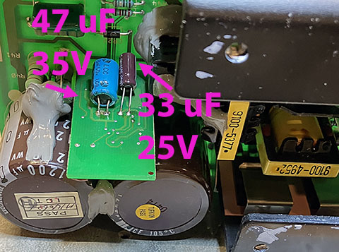

I had a PS from an E4406A that had the same issue (dead standby power). I traced it down to the little PWM board just before the transformer by removing the transformer and injecting 15VDC into that side at an appropriate spot. Used it that way for a little while, then acquired another E4406A in better shape. Used that one for years and finally circled back to this.
Two caps: 47uf and 33uf. Both came in at 22uf, and ESR of around 20ohms @ 120Hz. I had an exact match for the 47uf, but had to use 22uf+10uf in parallel on the backside of the board to get it going (frontside has interference with the main caps).
Works great now....
Edit: Now that I think about it, though, that circuit is probably pushing far beyond 120Hz.... I haven't really looked at the datasheet for the SG3843D.

Offline ik8tng
  • Posts: 2
Re: E4406A died PSU
« Reply #10 on: October 02, 2023, 05:12:00 pm »
Can you send more info? Where are the cap?

« Reply #11 on: October 24, 2024, 02:45:56 am »
Sergio
For posterity, he was referring to these:
My E4406A would generally boot up about 5-10 minutes after turning on the power, but lately it was taking more like 30 minutes to 1 hour so it was time to deal with it.
The 47 uF cap showed higher-than-normal ESR when cold, but was close to normal when warm.  The 33 uF cap was almost completely open.  As Werner noted, these caps were originally mounted on the other side of the board, but this side is easier to access without desoldering the whole PCB.
