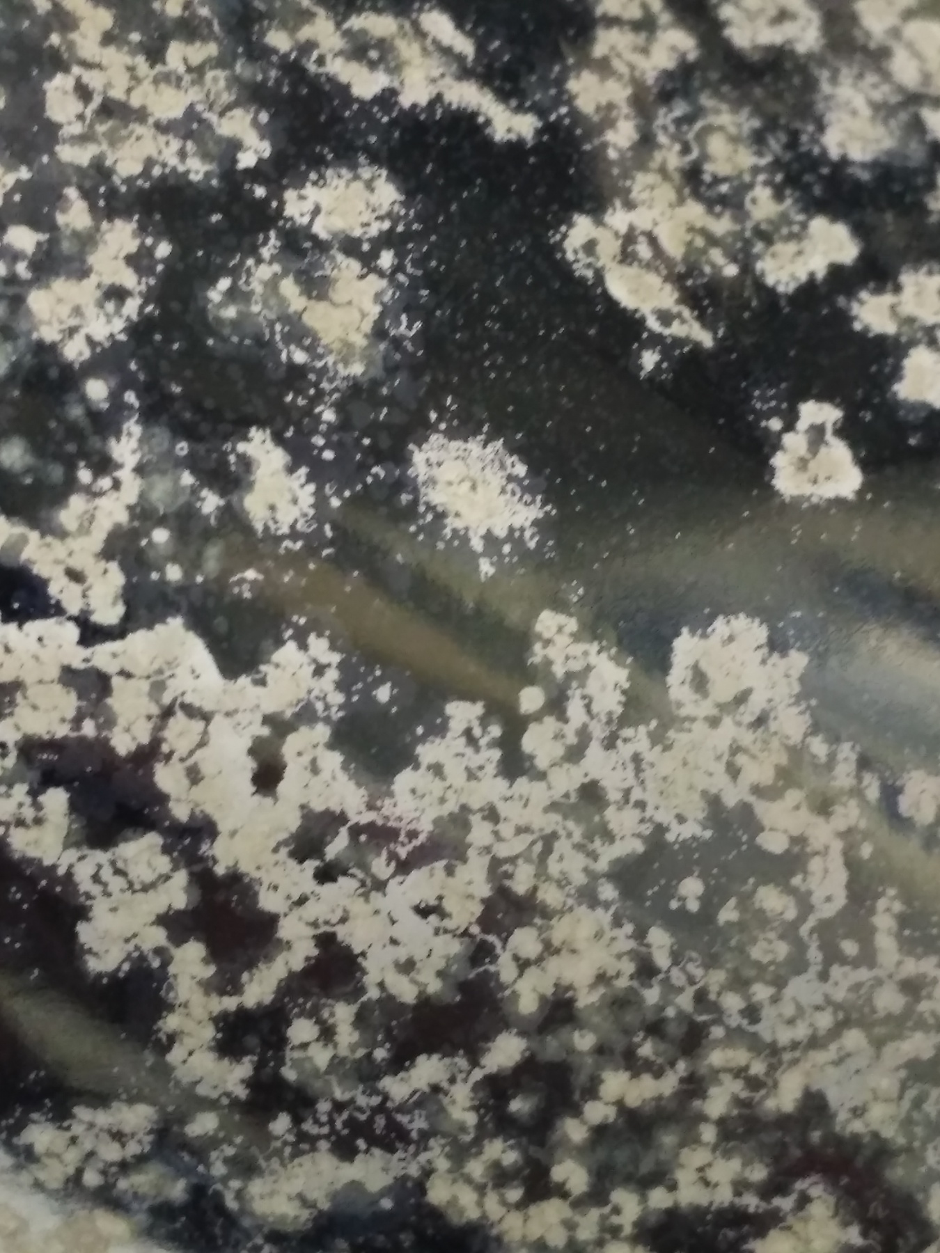

failure/degradation of metalised film capacitors ... interesting
« on: September 25, 2018, 09:08:24 pm »
when working on repairs most people tend to absolutely overlook metalised film capacitors like the ones shown here (myself included) ... not realizing that they can degrade heavily over time (not sure if specifying has anything to do with it?) ... i suppose checking it's capacitance can be a strong clue to this happening. I thought this was interesting and worth of note ... when you can't find other obvious problems in a circuit ... i'm guessing it can happen to X and Y class caps too

It's actually a 'mechanism' rather than failure/degradation in most metalised film capacitors (apart from the really crap cheap ones, that is). The idea is to clear a fault that punctures the dielectric. Self-healing is normally indicated in the datasheet. Breakdown is normally the result of overvoltage or severe current transients. It's a desirable behavior in X-caps - you want them to self-heal on transients rather than fail short, as a foil capacitor would do.
Unfortunately, the downside of self-healing behaviour is that it does result in progressive loss of capacitance as the metalisation burns away around new punctures, although it doesn't happen in low power circuits.

The problem is that the cheap ones self heal because they progressively deteriorate.  Good quality X and Y class capacitors self heal when damaged and bad quality ones continuously self heal or otherwise degrade over time.
This problem cropped up in audio coupling circuits starting decades ago where low quality metalized film capacitors produced a noisy "scratching" sound.

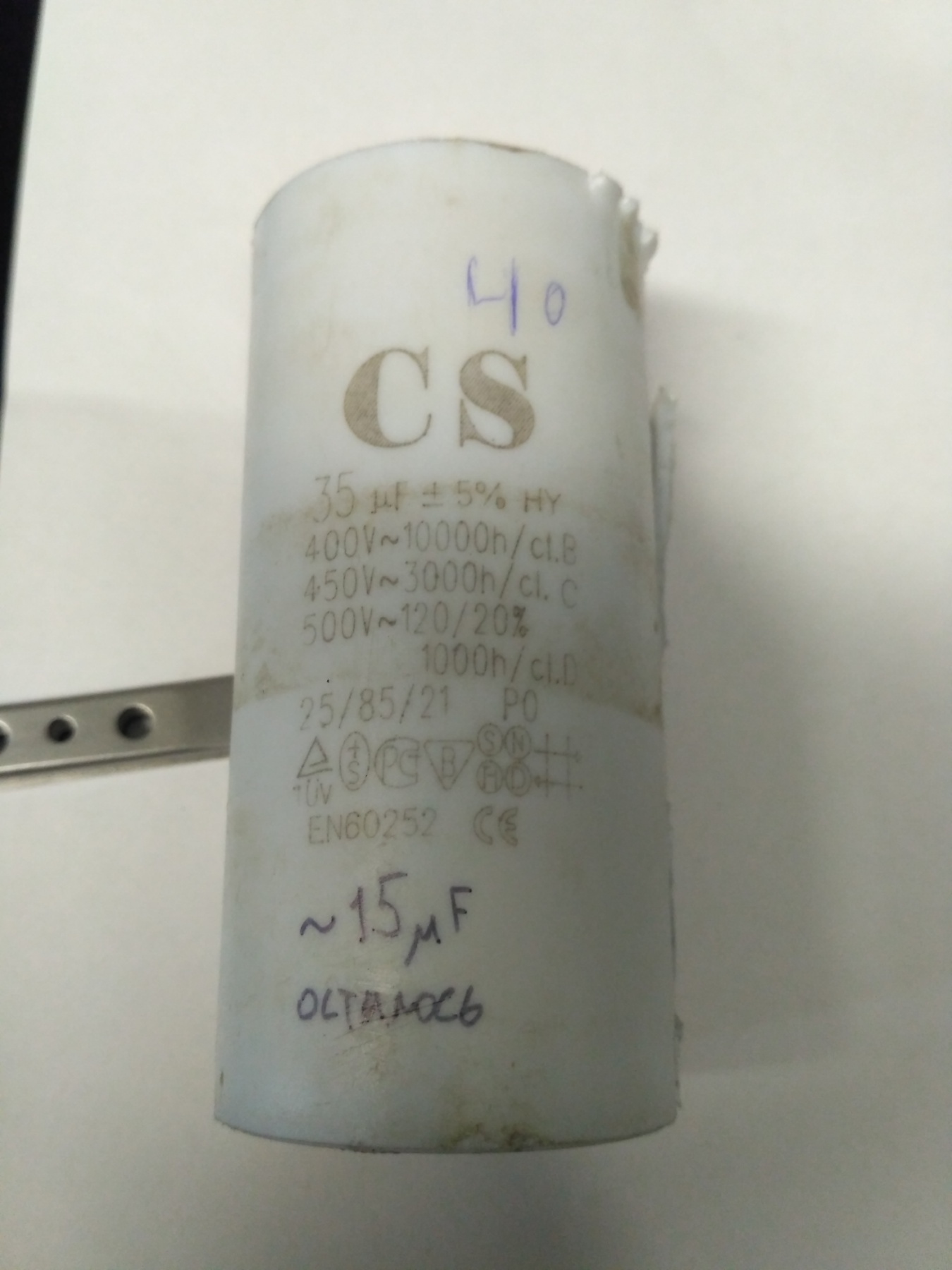

You get it with motor run capacitors as well, though there you find your nominal 50uF capacitor drops down to around 30uF before the compressor motor stops being able to start reliably, and then cycles on the overload cutout till the motor itself fails short circuit and blows the internal wiring apart. Generally I test these capacitors with an insulation tester, and you can hear the capacitor self healing as faint crackling noise coming from the capacitor as the self clearing takes place. Insulation resistance wise they are poorer than new, but still well above around 1M, but when they become noisy you know it is time to change them. New capacitors do not break down at 1kV Dc, with the 440VAC rating they have.
Funny enough I have some old PCB oil filled capacitors, around 50 years old, that, despite being in service for decades, still meet the capacitance value on them, and do not break down at 1kV. Comes from being sealed units, and being metallised paper units with a good oil fill. They are however three times the size of the equivalent palm oil filled metallised foil replacement capacitors.

No, it does work, I've sacrificially tested them. Wind the voltage up slowly from rated peak and they start ticking, keep going and the capacitance keeps going down and the 'proof voltage' goes up as you knock out the defects. If you really push it, they swell a bit.
With a non self-healing film, you get one tick and it becomes a low value resistor.
The exception of course is the old Rifa Metalized paper once it gets moisure ingress... they go into self-heal meltdown, or rather, burn-down!
